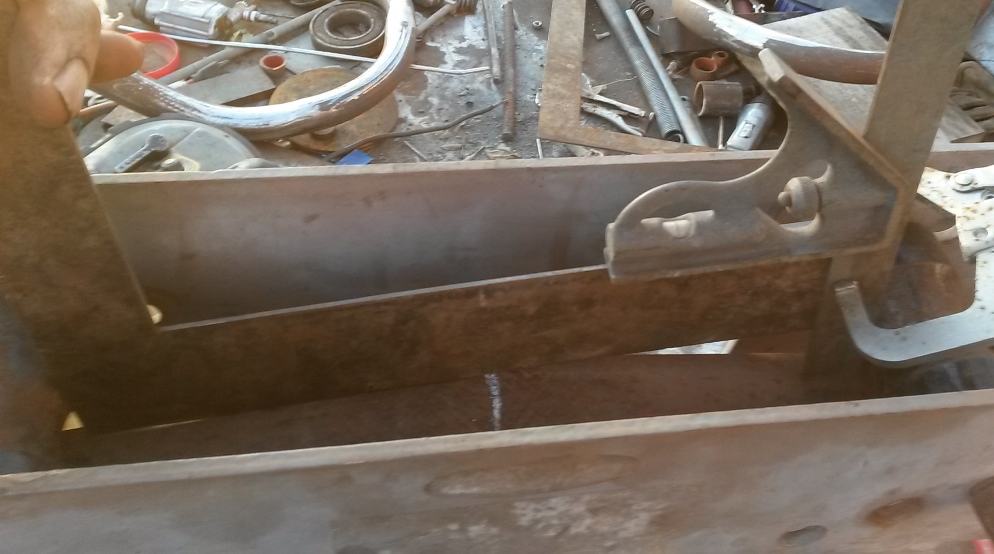

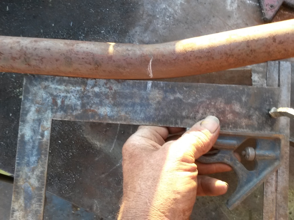

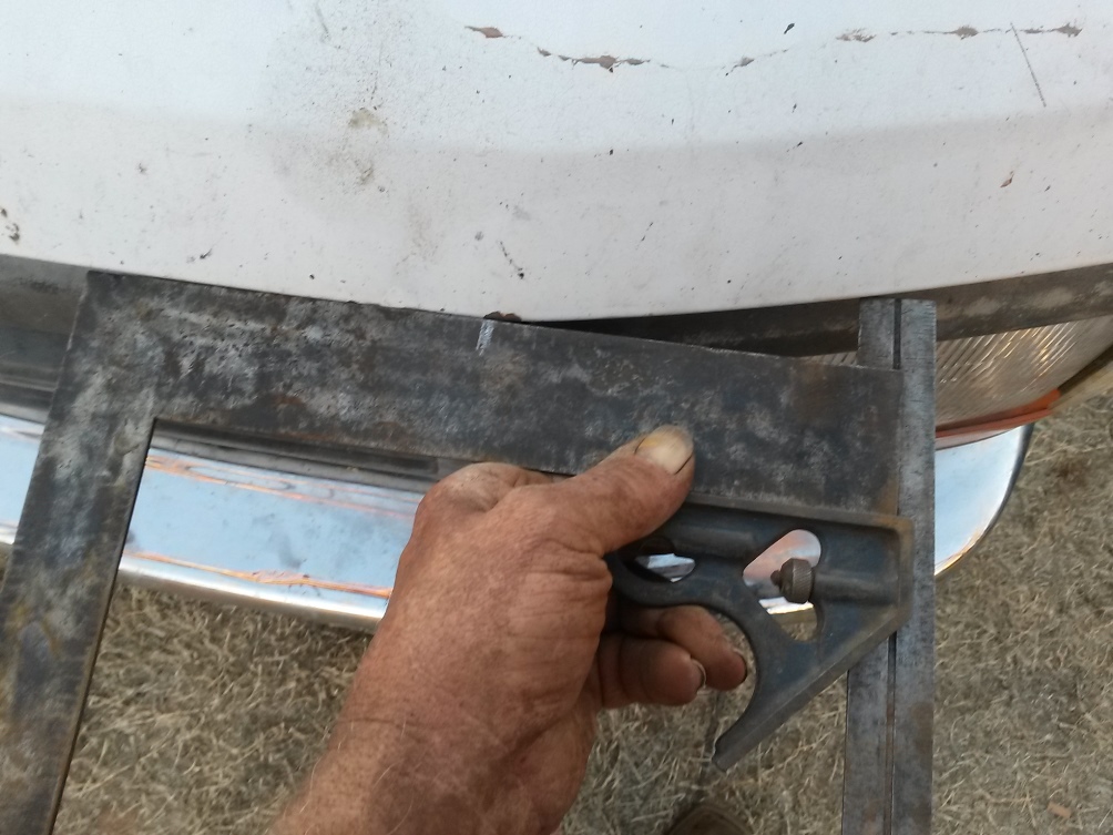

there are times when I want to check the set back or an angle for a bend I just grab a tri square and a small frame square or other straight edge
Often I do not need to know what the angle is although it would be easy enough to calculate I just need to know the set back for a bend.
This is how I did it
Checking the center of the hood of my truck
Attachment 31849
Checking the bend of the pipe while in the bender
Attachment 31851
Attachment 31850
