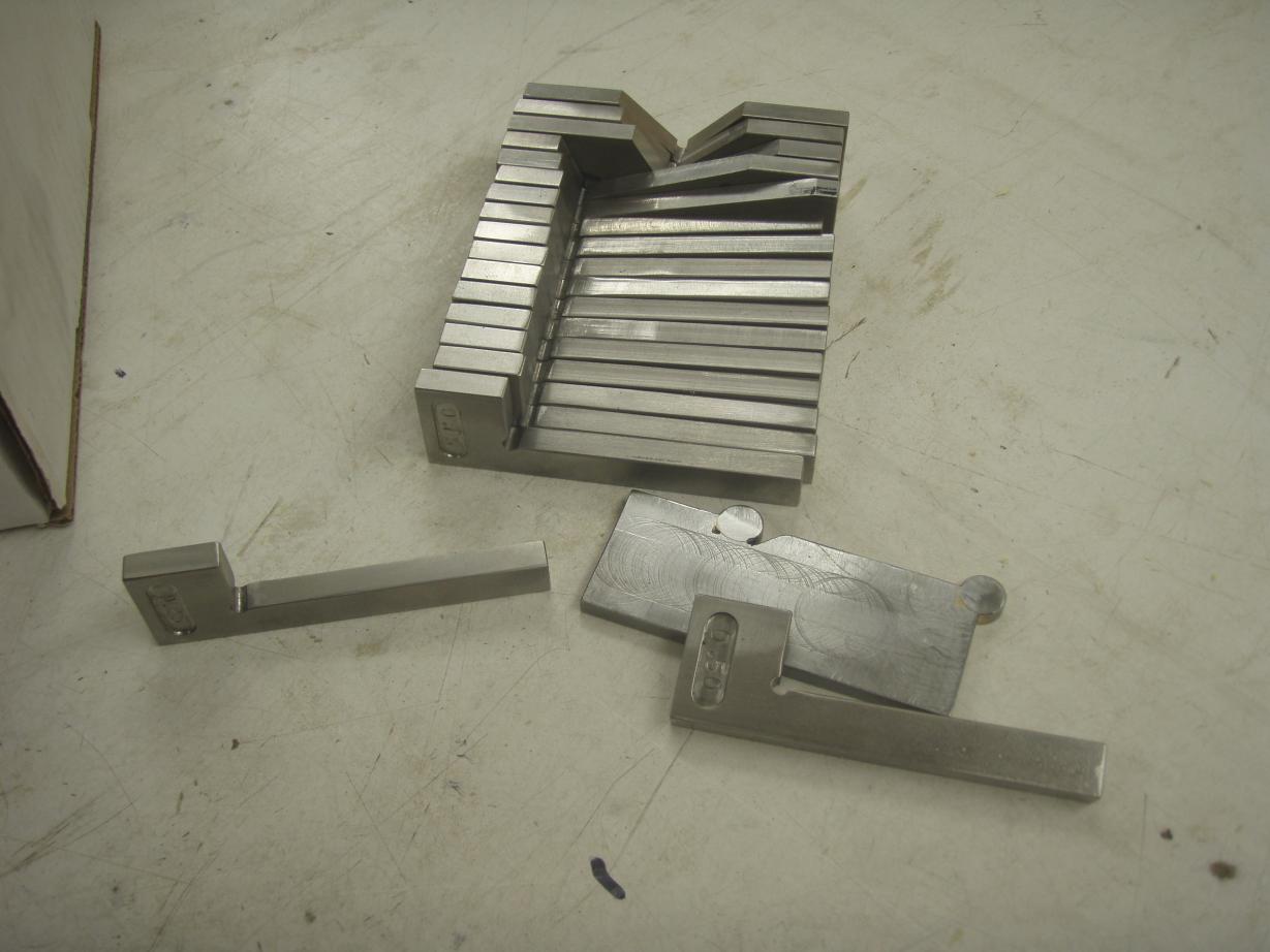

    Angle Setup Plates, Set
    Angle Setup Plates, Material - Stainless Steel, Hand honed to +/- 0.003 deg. Alot of work, 2 sets of 18 plates, 0.25 deg. to 45 deg. They work great for quick setup and repetitive setups. Credit to "The Tool and Die Guy" for the plans.

    Thanks Catfish! I've added your Angle Setup Plates to our Machining and Measuring and Marking categories, as well as to your builder page: Catfish's Homemade Tools. Your receipt:

    Wow! The angle setup plates and the boxes are beautifully made. I too have been a lifetime subscriber to the "The Tool and Die Guy" from his early days on the web and remember his positive comments about having these but it would take a lot of work to make them. Nice to see your work. Thanks for sharing.

    The You Tube video was very useful. Can't wait to see the one on blueing which I something I always wanted to do for my homemade tools.

    Great work on the plates and boxes Catfish. Looking forward to the blued ones.
