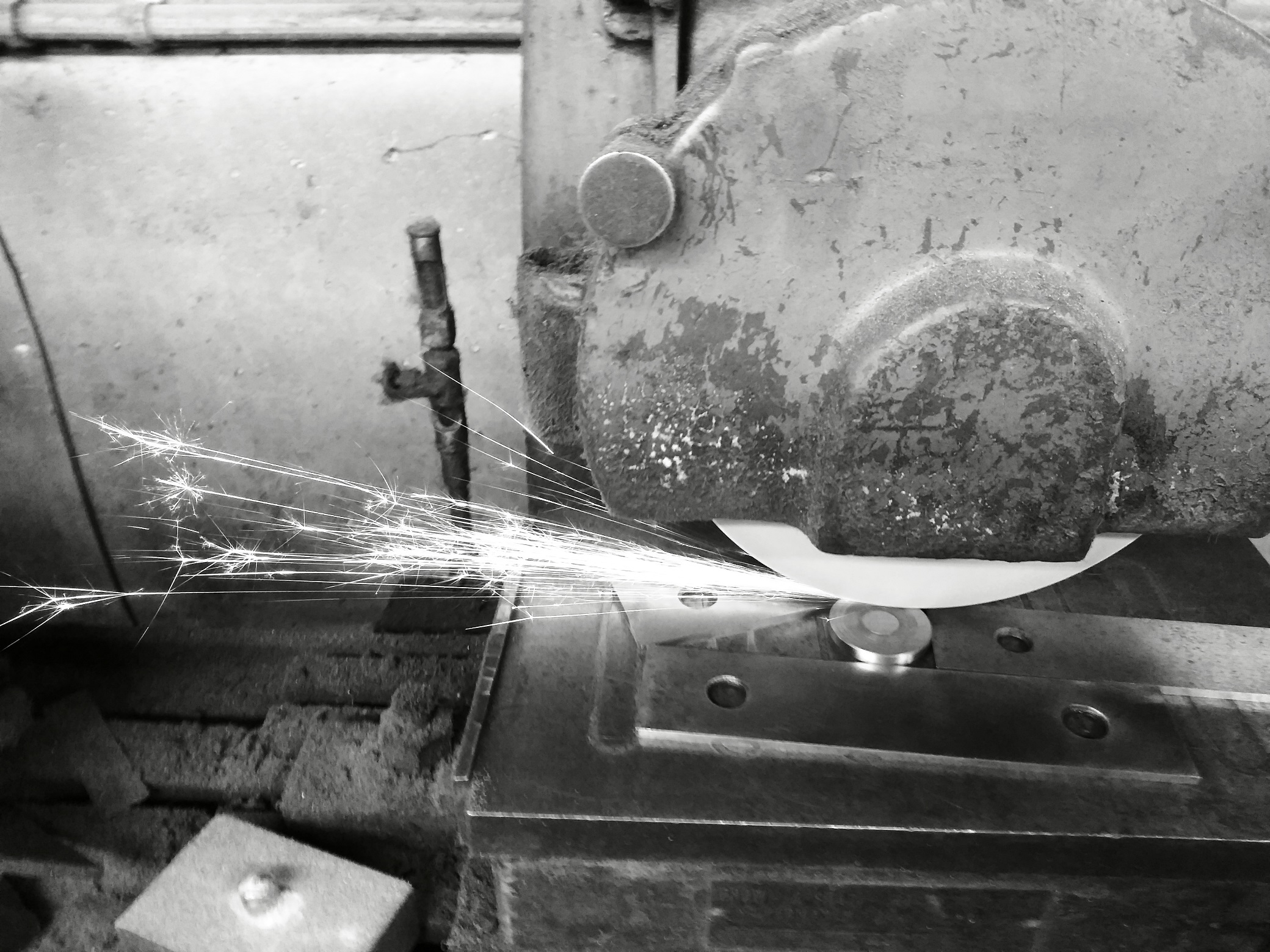

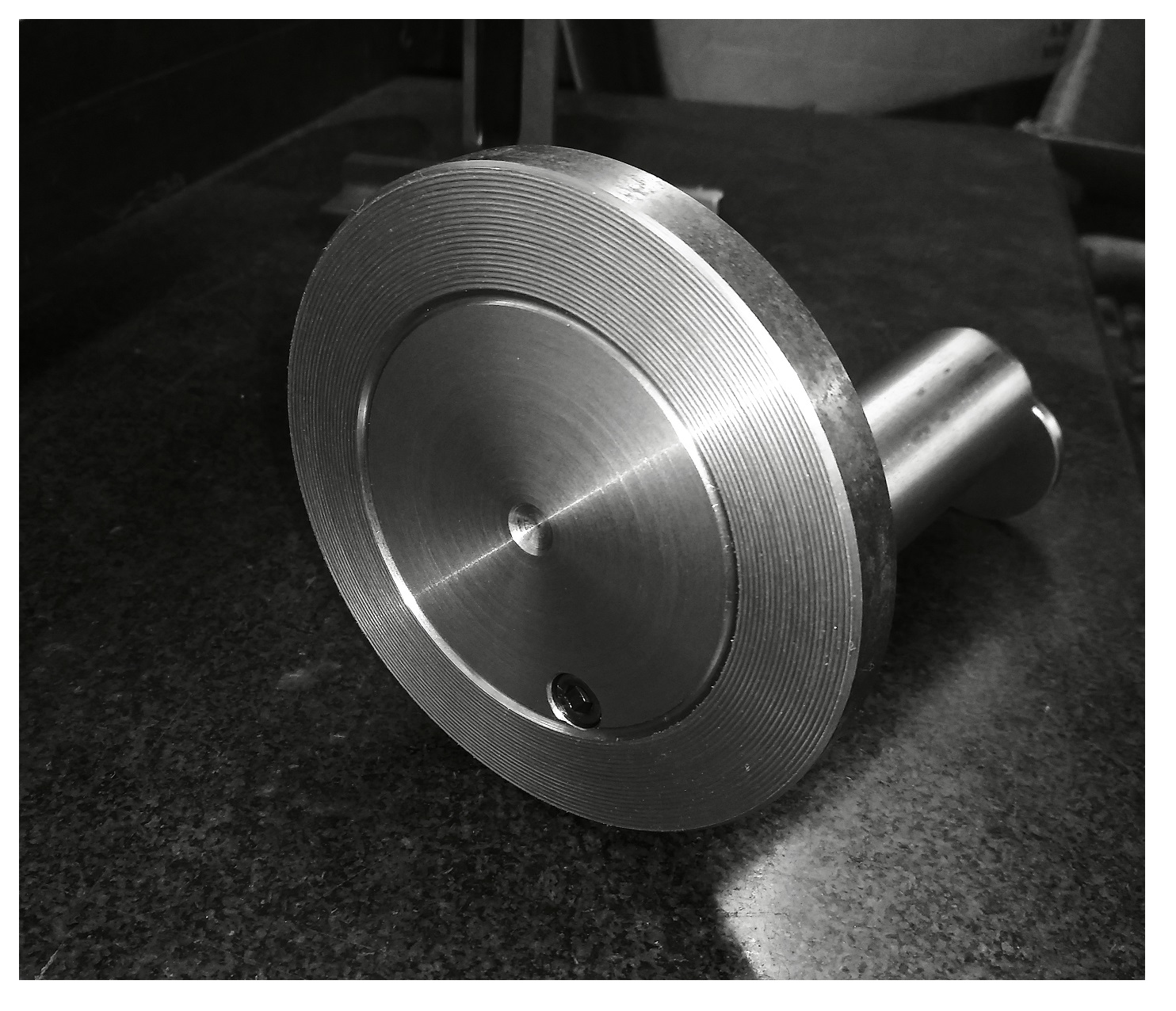

First the base was relieved about 3"Ø, about .040 deep. The surface was then finely faced and scored with a small radius cutter. This is often done for faces of large flanges, called a 'record seal'. In this case it will give small bits of dirt a place to go. Flipped the plate and finished the upper surface reasonably parallel to base.
Attachment 30877

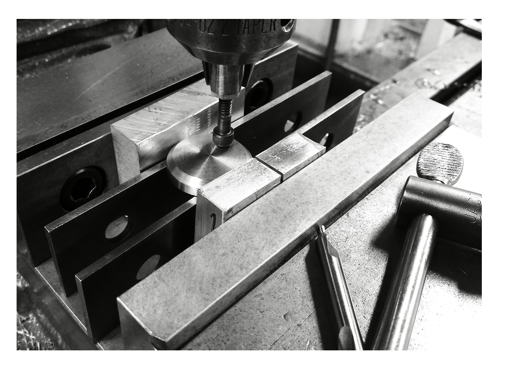

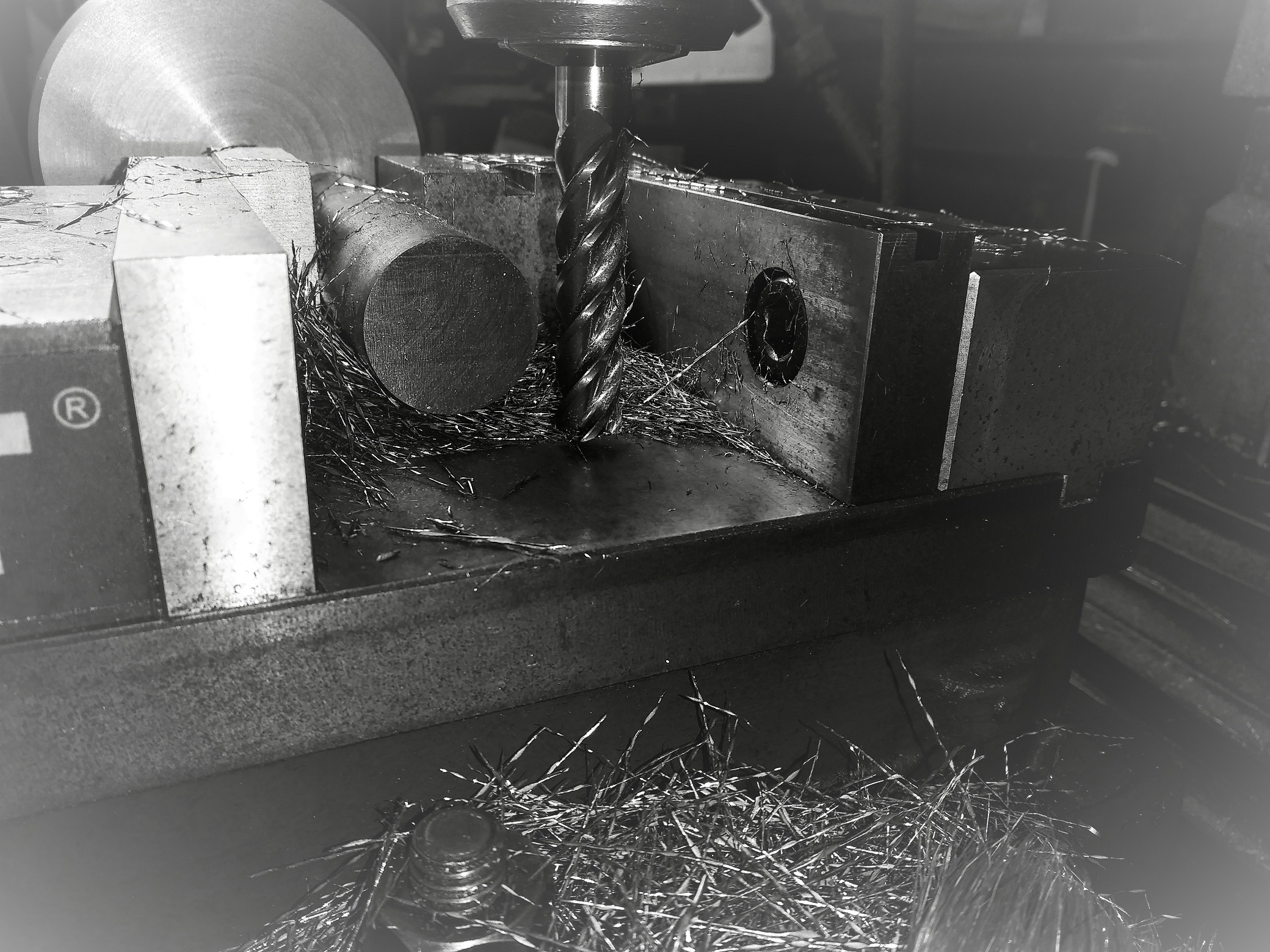

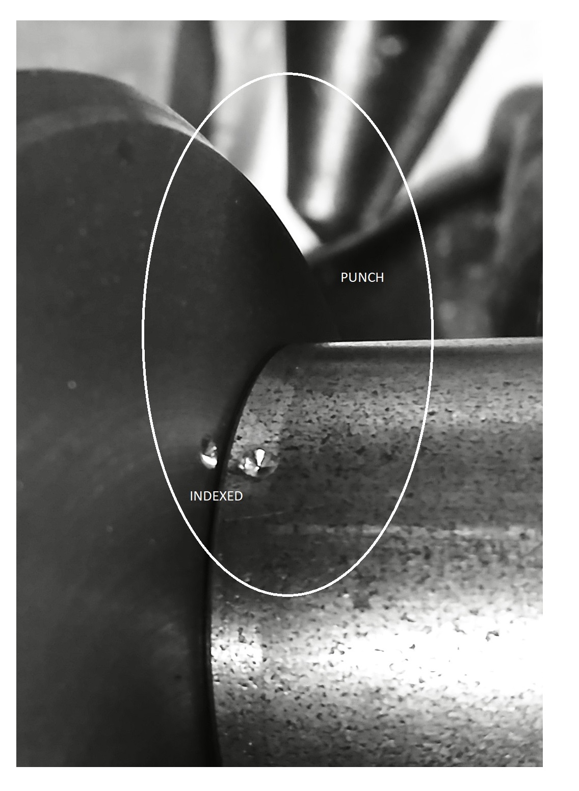

Drilled and counterbored base for 1/4 capscrew, just over half diameter of post from edge, and mounted post already tapped center of one end. Punched marks where post meets base, indexing their orientation if they should require disassembly.
Attachment 30879

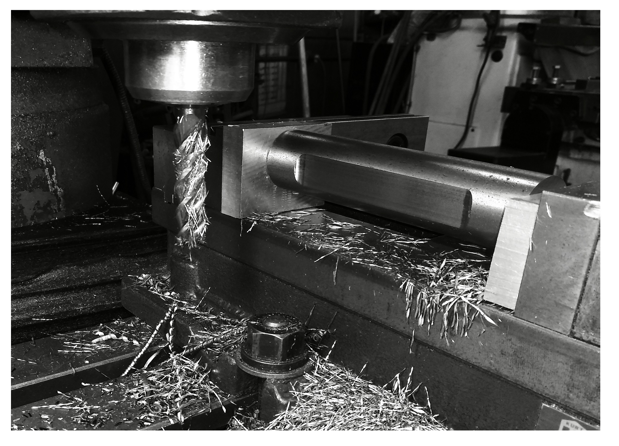

Mounted in mill vise, with Vee block and spacer. Found base [now the reference plane] with edge finder. Allowing for cutter diameter, milled 'top' of post to precalculated center line height [thickness of plate + post]. Other end, [top of post] is then drilled well off center.
Attachment 30880

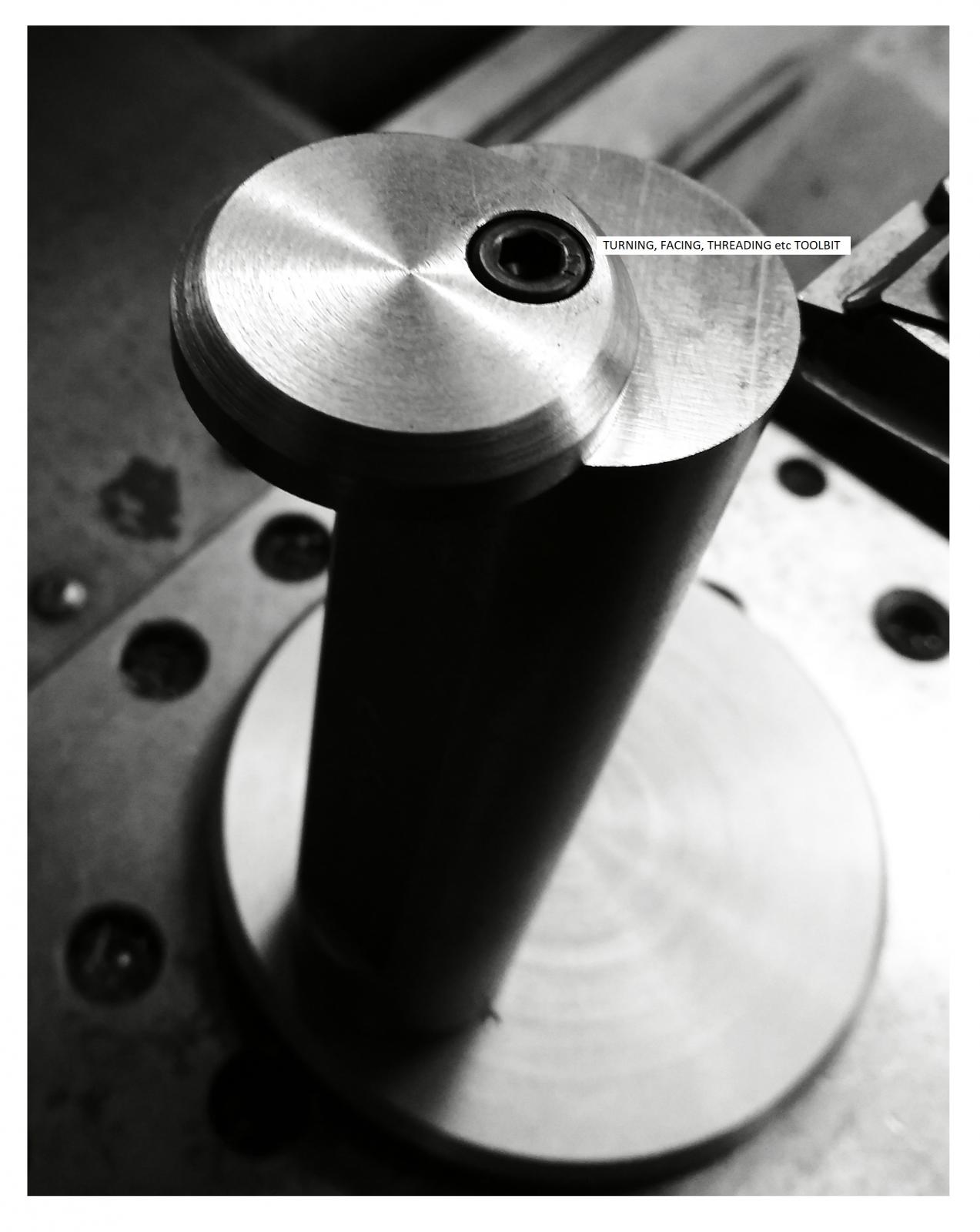

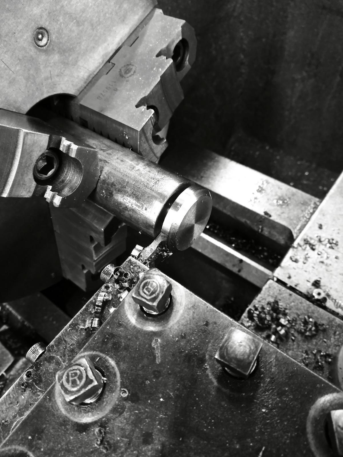

Faced, chamfered an parted 1" rod for cap portion, thick enough for counterbore another 1/4" capscrew.
Stamped the flat on post, attached cap and done.

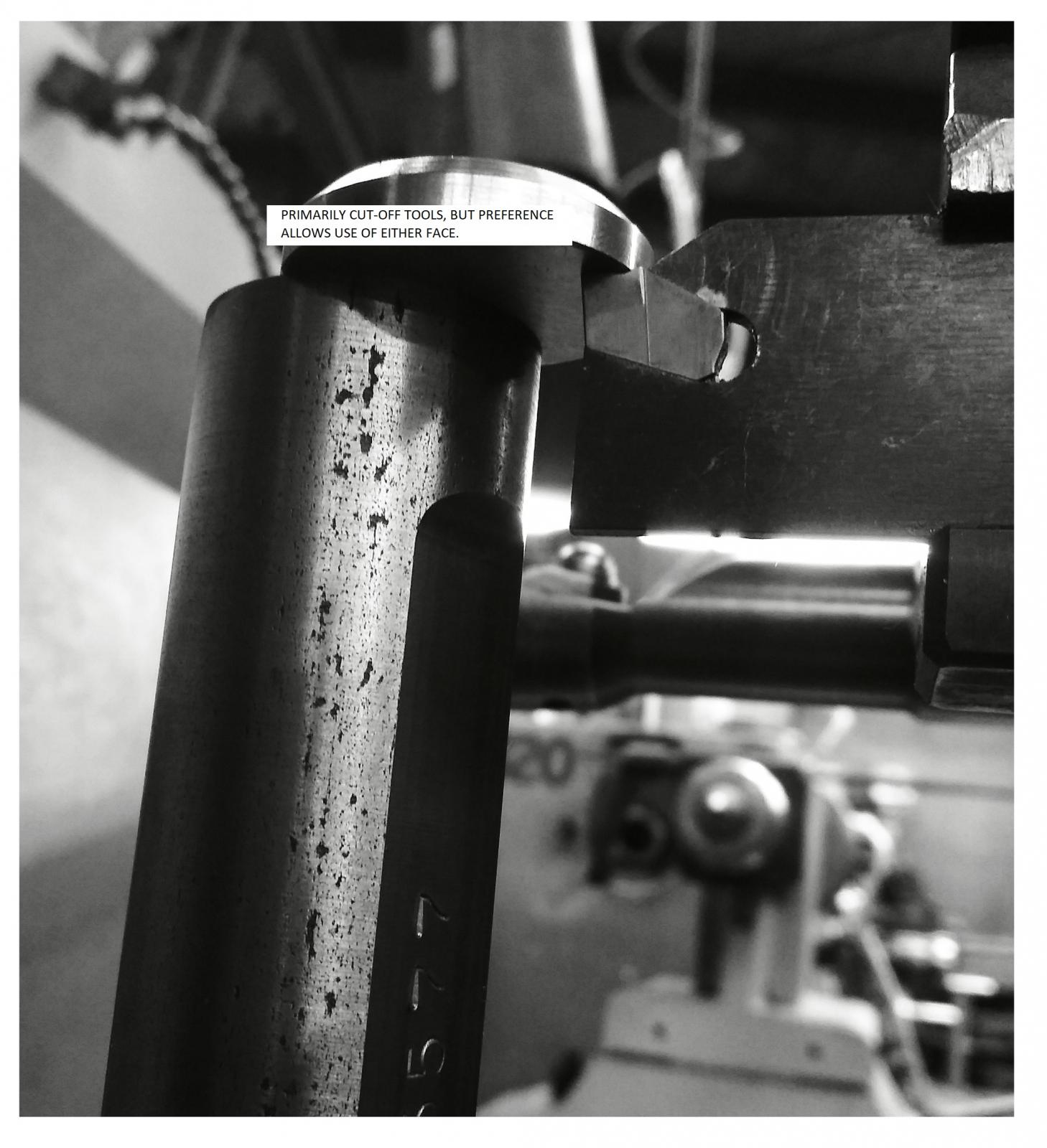

Attachment 30881 Attachment 30882 Attachment 30883
