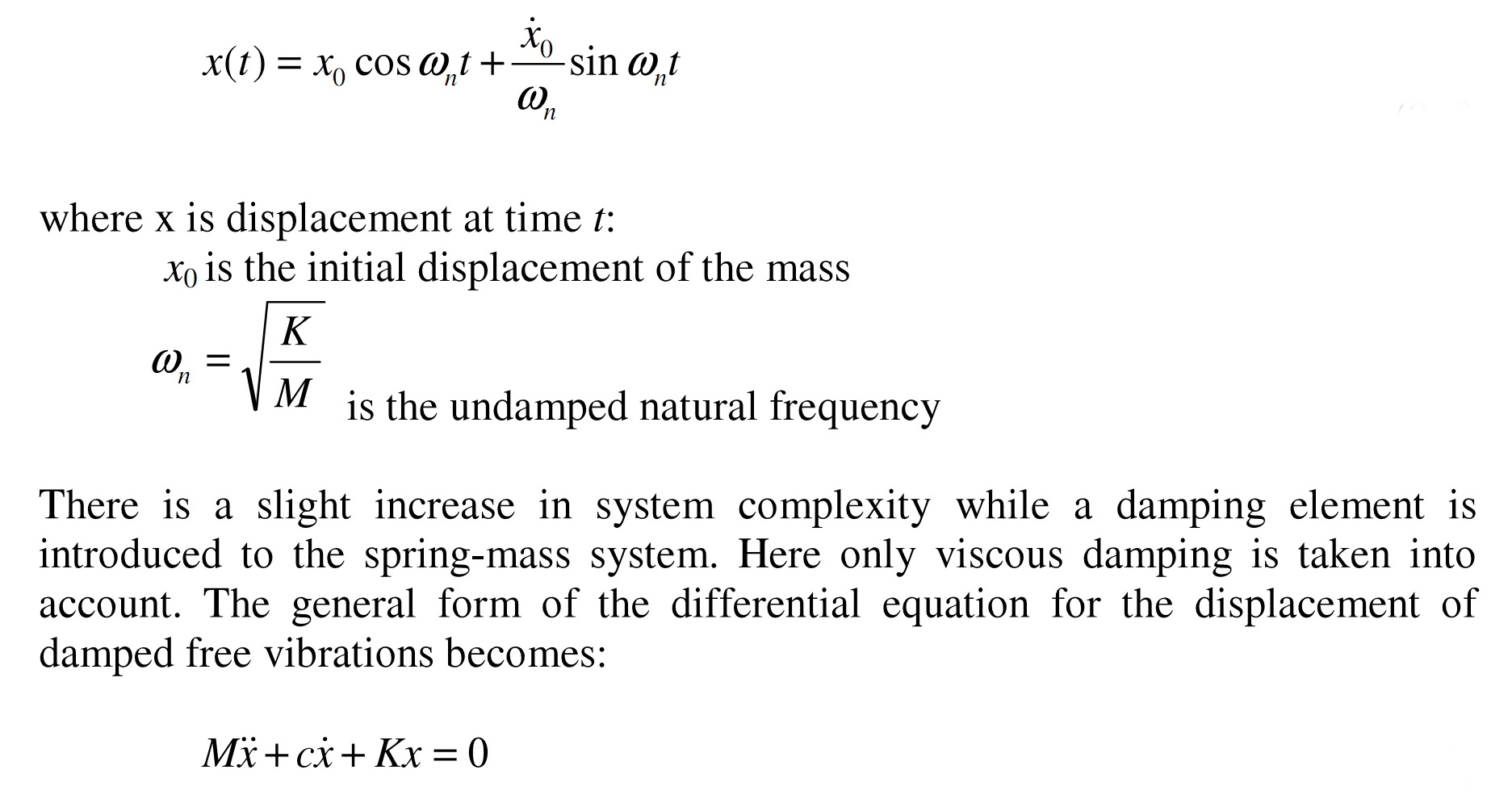

M4A says: The correct solution for this mass-spring system is...
Attachment 38304
