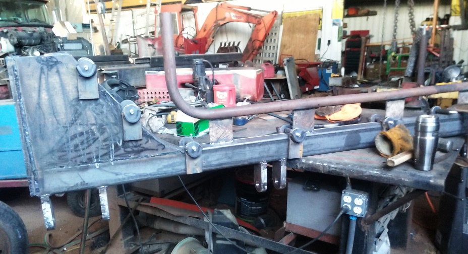

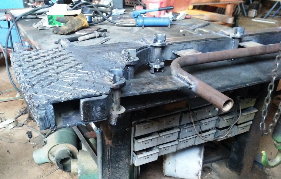

Attchament for inserting conduit in the ground for fiber-optics cable install

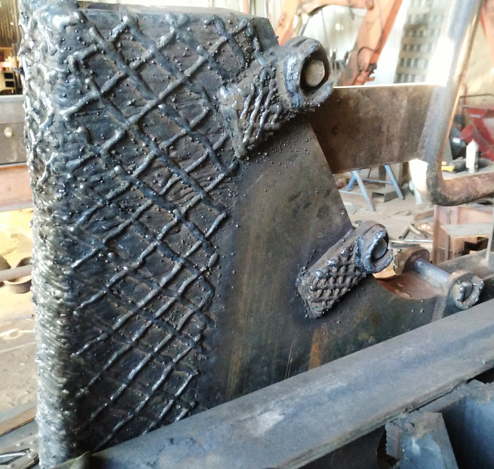

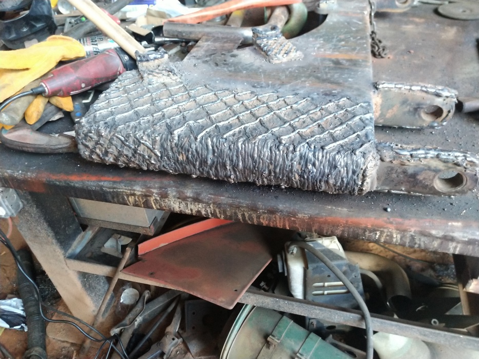

A contractor brought me a badly worn insertion tool that attaches to the ripper plow on his D9L

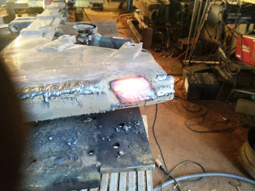

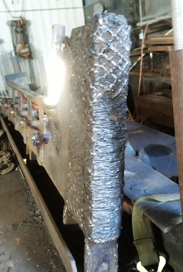

So I made him a new one and repaired the old one
building up the old one under the hard face is a pad weld in some places 8inches wide and 1/8" thick other places 3" wide and 1" thick
Attachment 46899
Attachment 46900
Attachment 46901
Attachment 46902
Attachment 46903

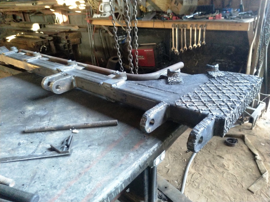

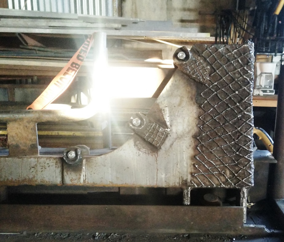

The new one made from 4x3 rectangular tubing 1/4" wall /12by 2-1/2 flat bar 5/16" plate 1" by 2-1/2&3" flat bar. 3/8by 1" flat bar and 1/2" bolts 1 1/4" pipe and misc. plate steel
