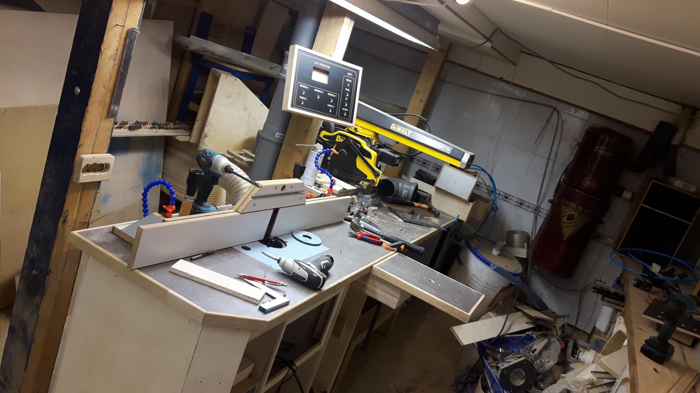

I built my third router table with all the bells and whistles I had missed on the previous versions, during my years of woodworking.
This build included some automation, but the biggest improvement ( in my opinion) is the flip up trimmers.
Video in the bottom of the post!!

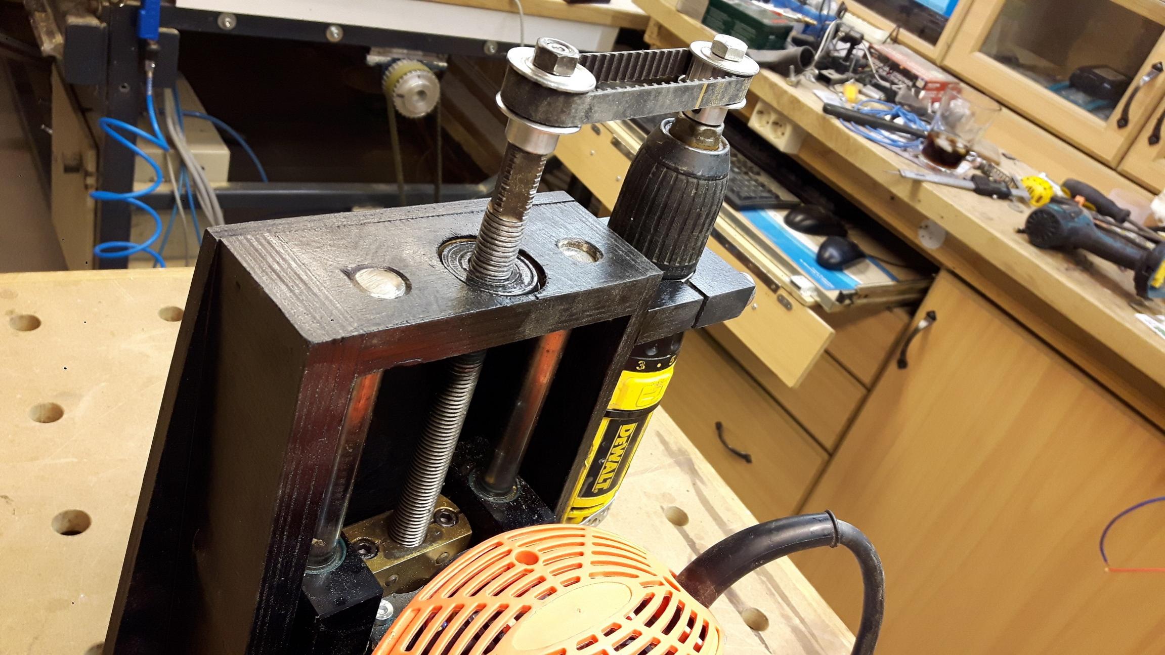

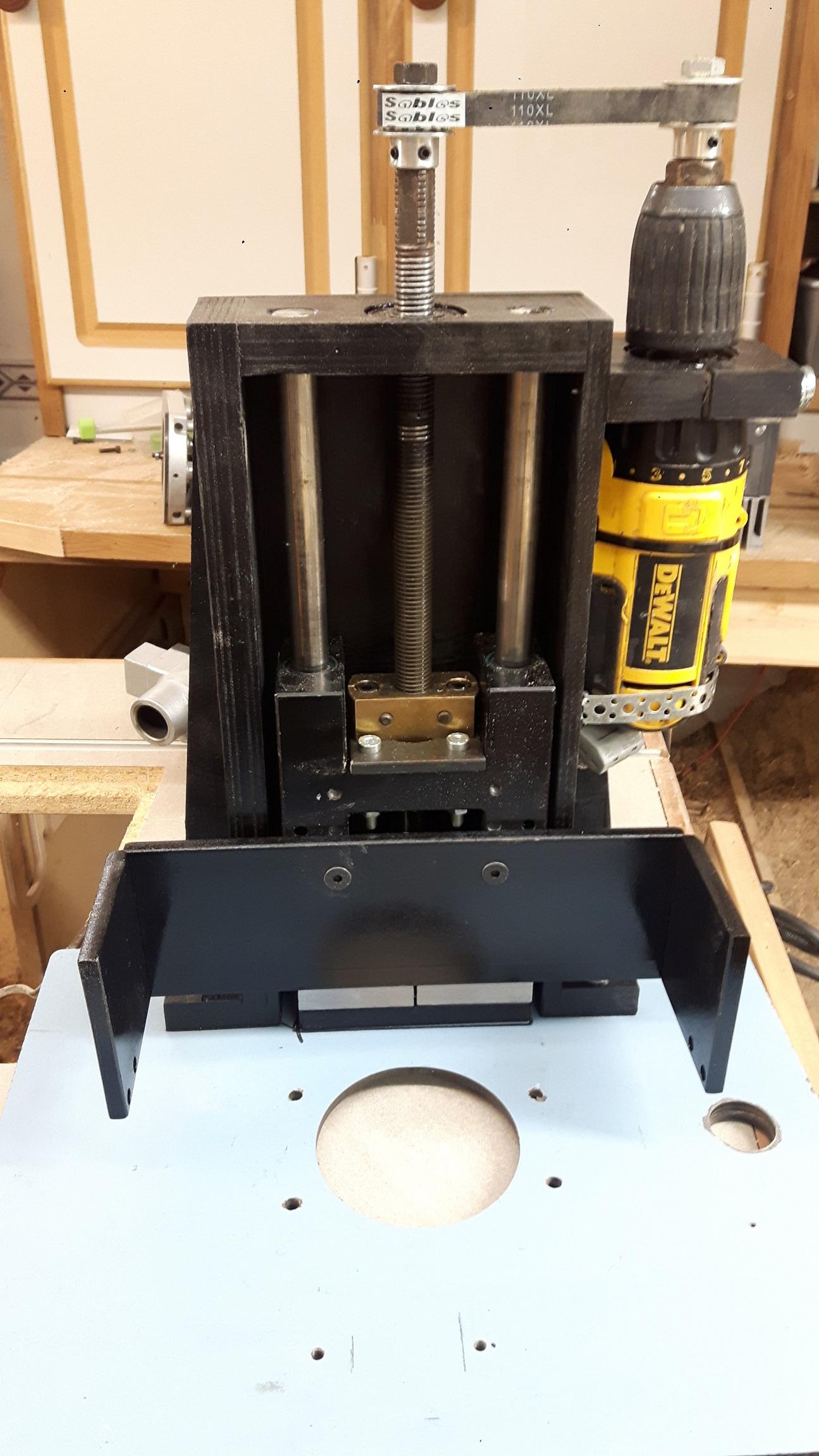

The router lift is built from an old sliding unit for a pneumatic cylinder.
Driven by an old cordless drill hooked up to an acme thread via belt and pulley setup.
Attachment 22824

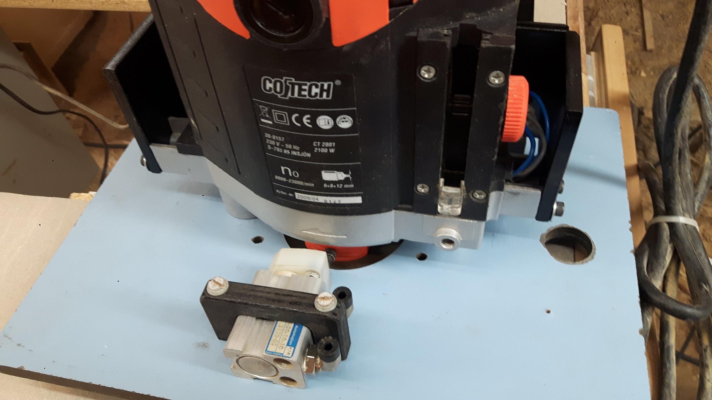

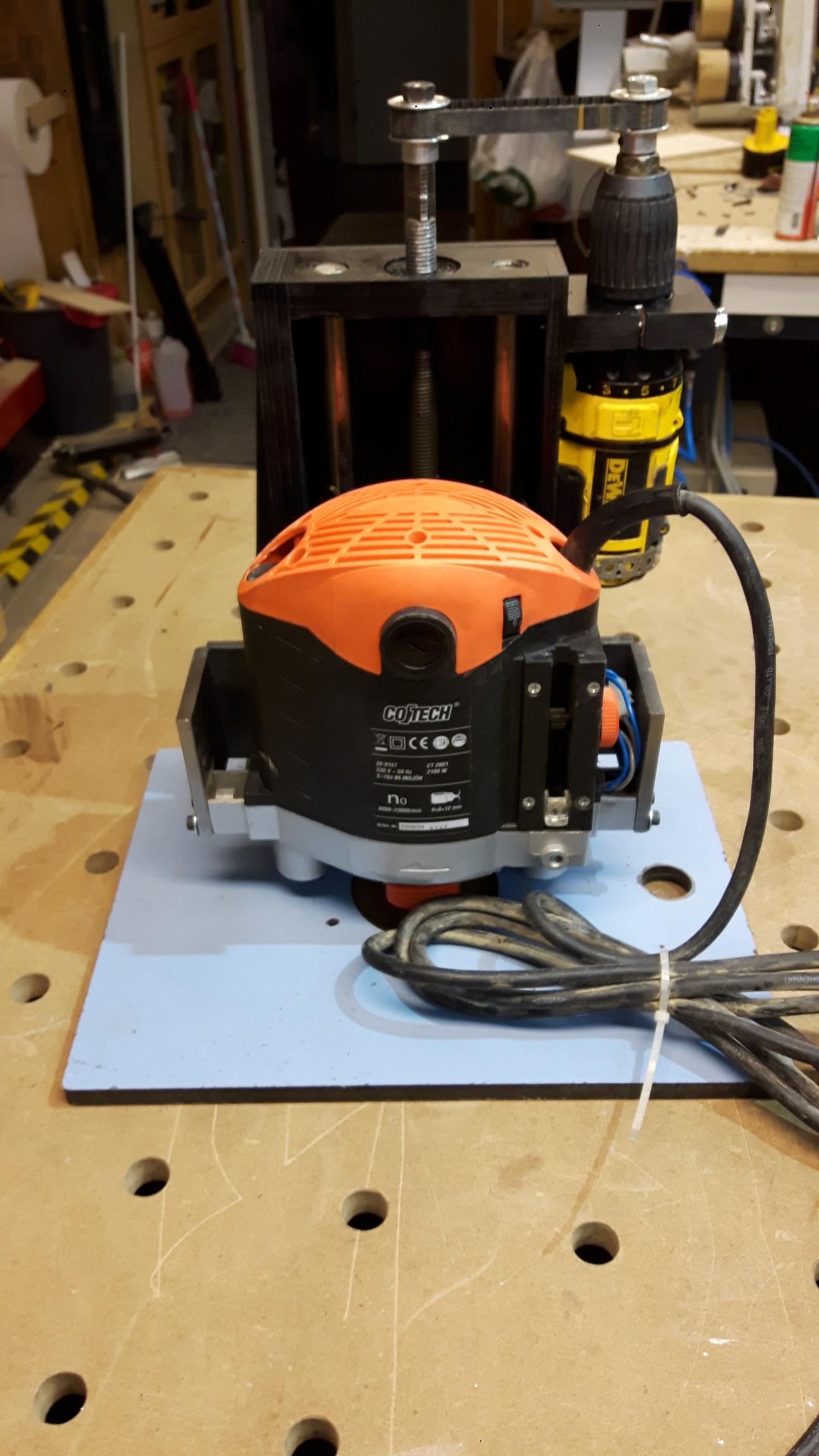

Custom bracket to fit a butchered 3hp plunging router.
Attachment 22825
Attachment 22827

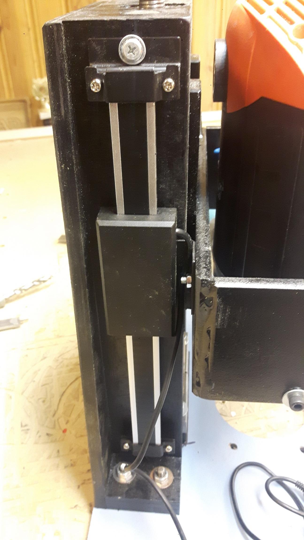

A 6" DRO for height measurement installed.
Attachment 22826

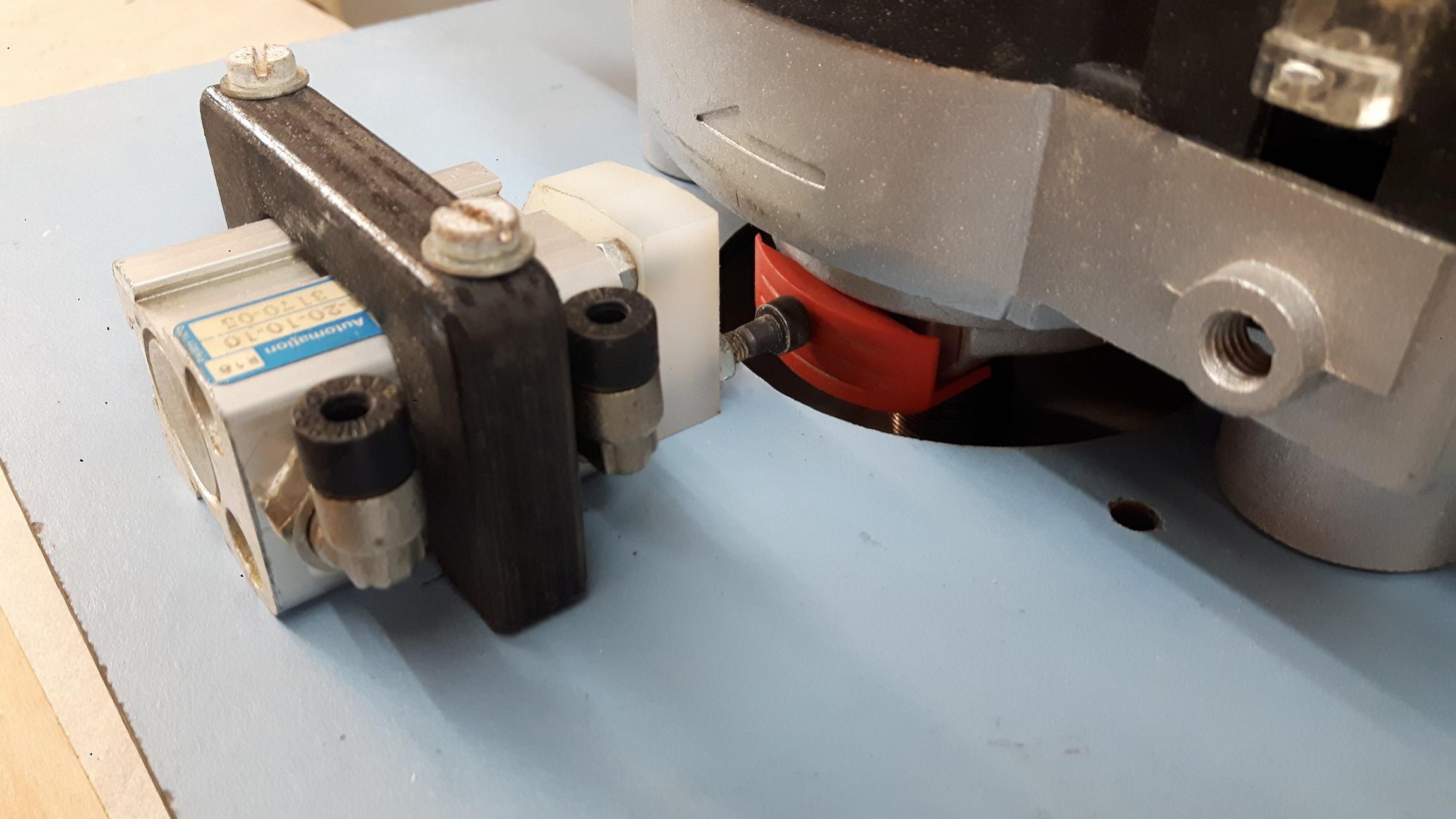

To lock the spindle when changing router bits, I added a pneumatic cylinder to press the spindle locking knob.
Attachment 22828
Attachment 22829

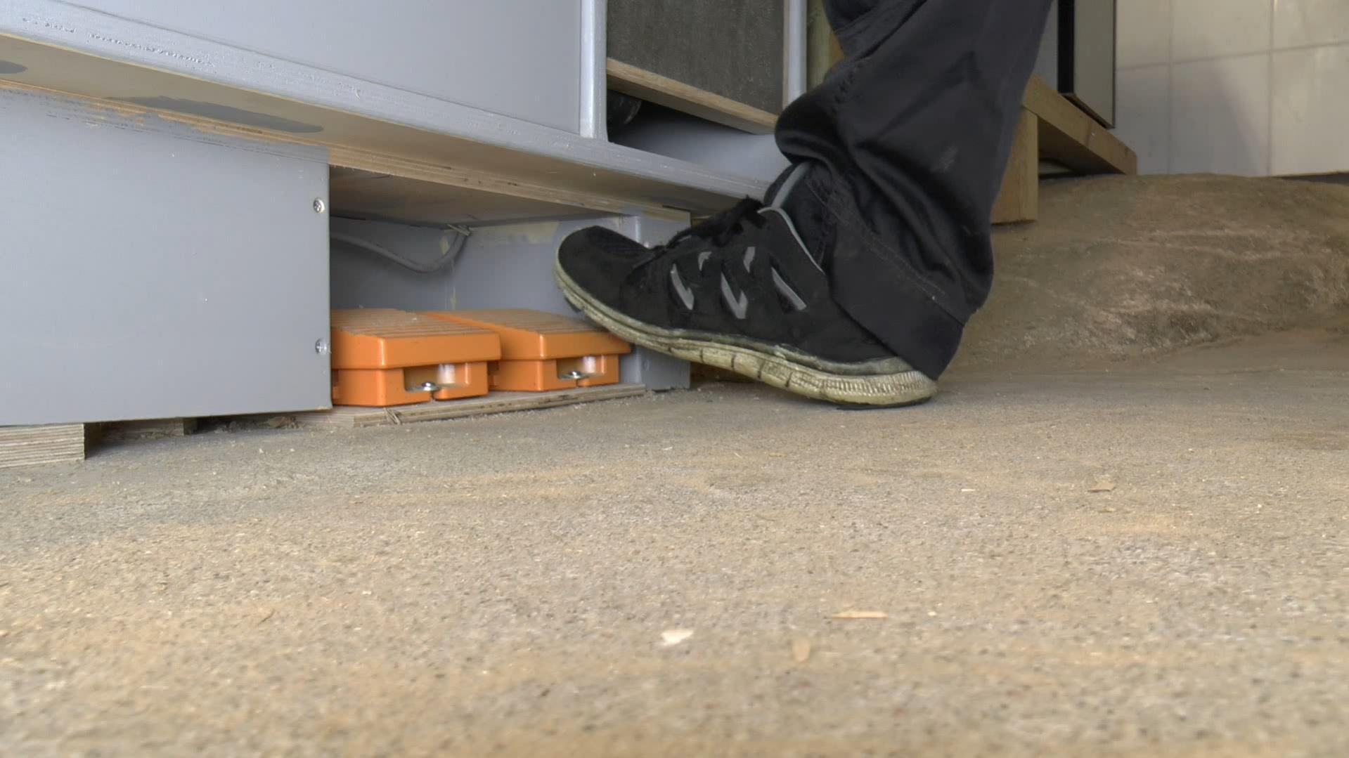

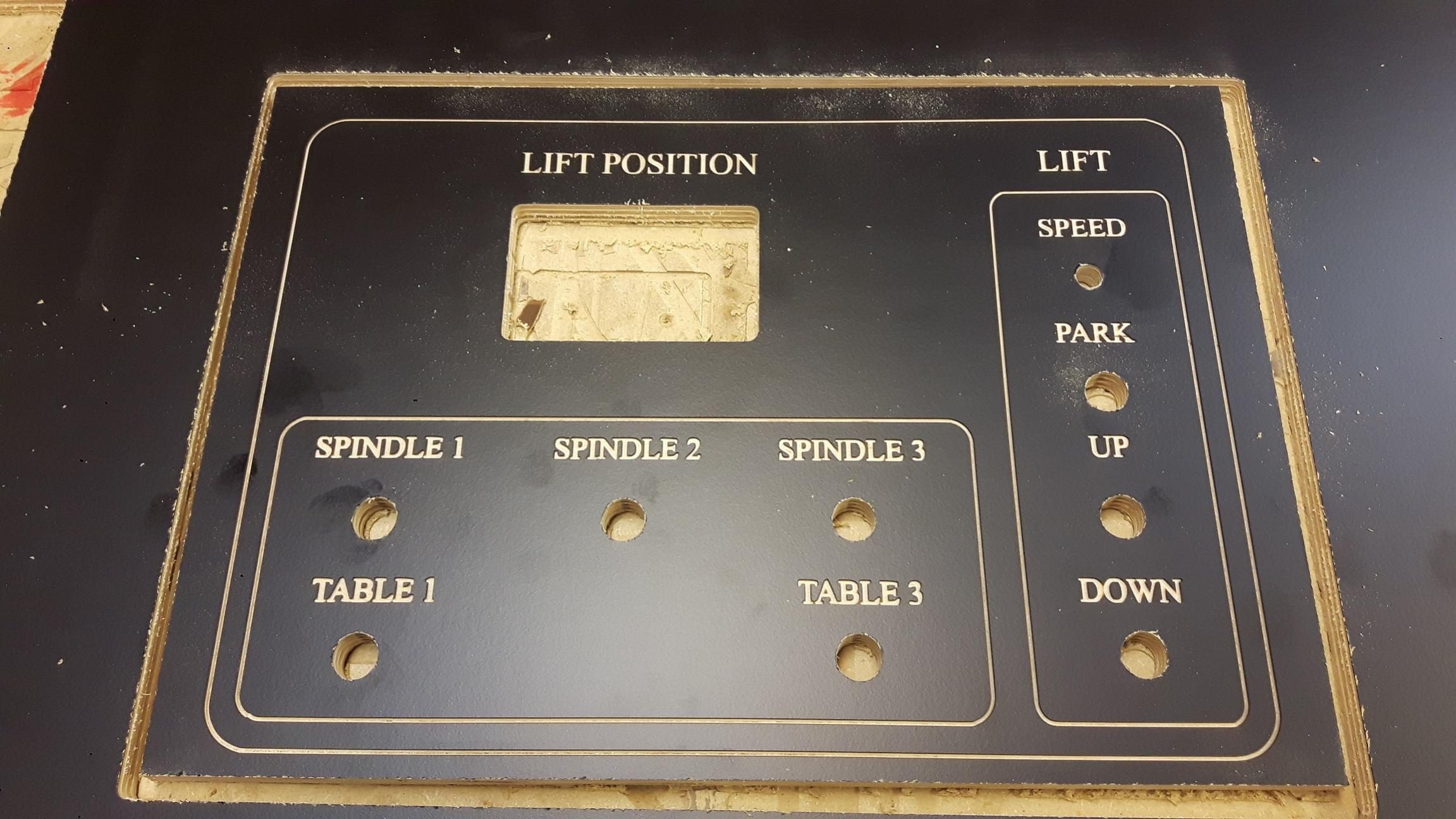

The lift can be lowered or raised either push buttons on the panel, or these two foot activated switches.
Attachment 22834

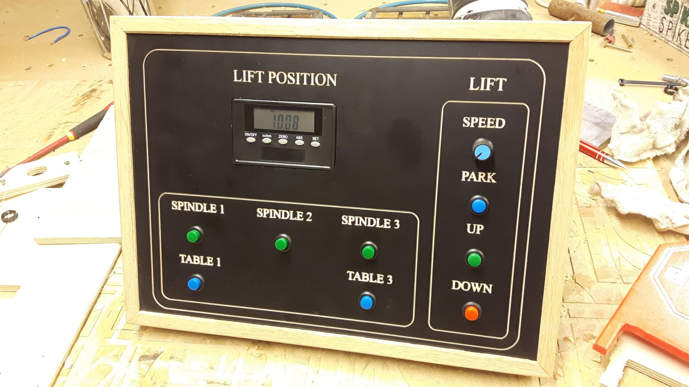

I wanted the control panel to have sort of an 80`s look and feel to it, so i designed it kinda retro, and engraved it on my cnc.
Attachment 22830
Attachment 22831
Attachment 22832

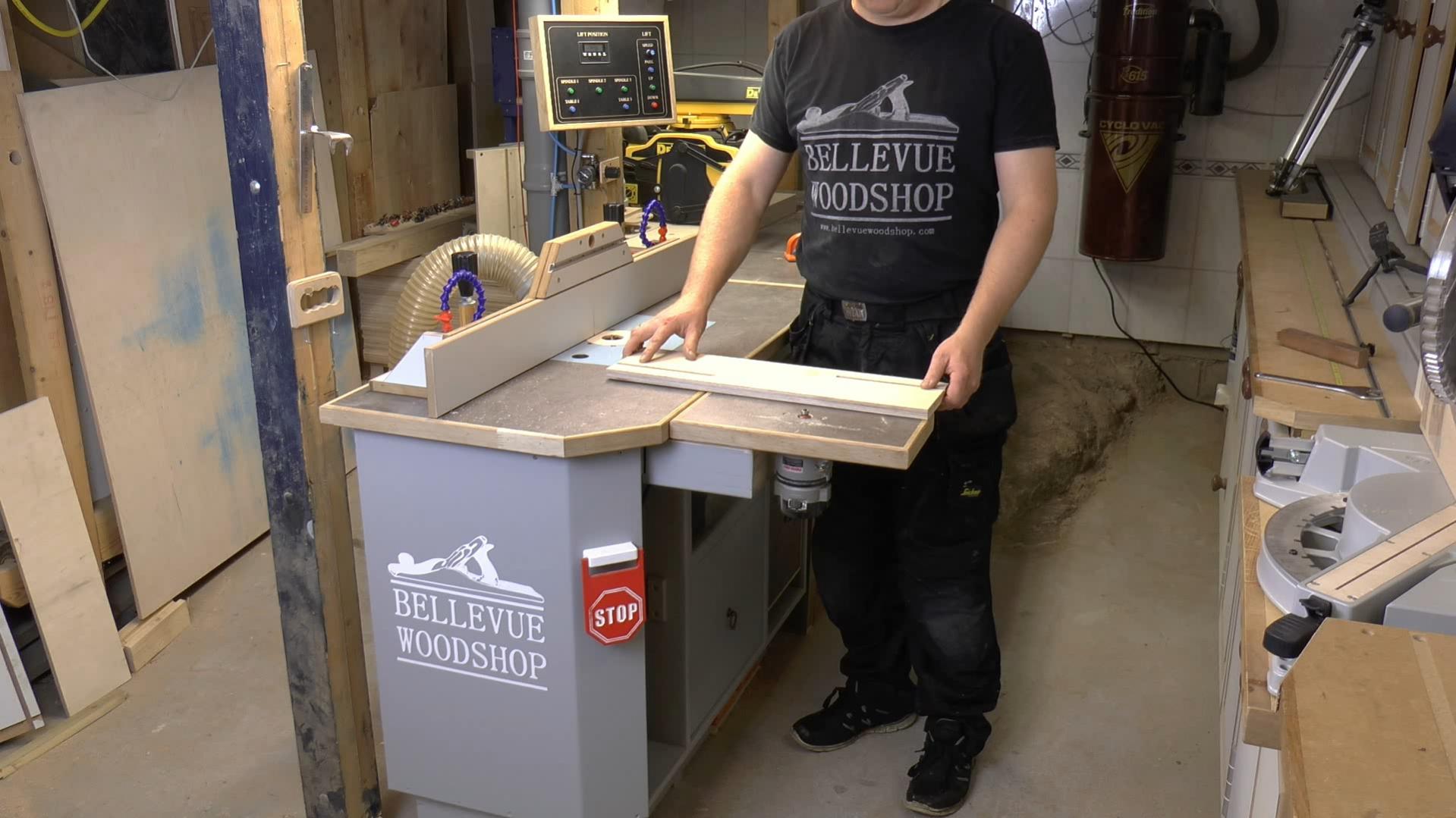

BUT the best part is the flip up trimmers, that has a roundover bit on one table, and a chamfer bit on the second.
These are great for quick edge treatment, instead of constantly having to switch bit in the main router.
If you want to see all of its features, and how i setup the automation on it.
Take a look at the video below:
