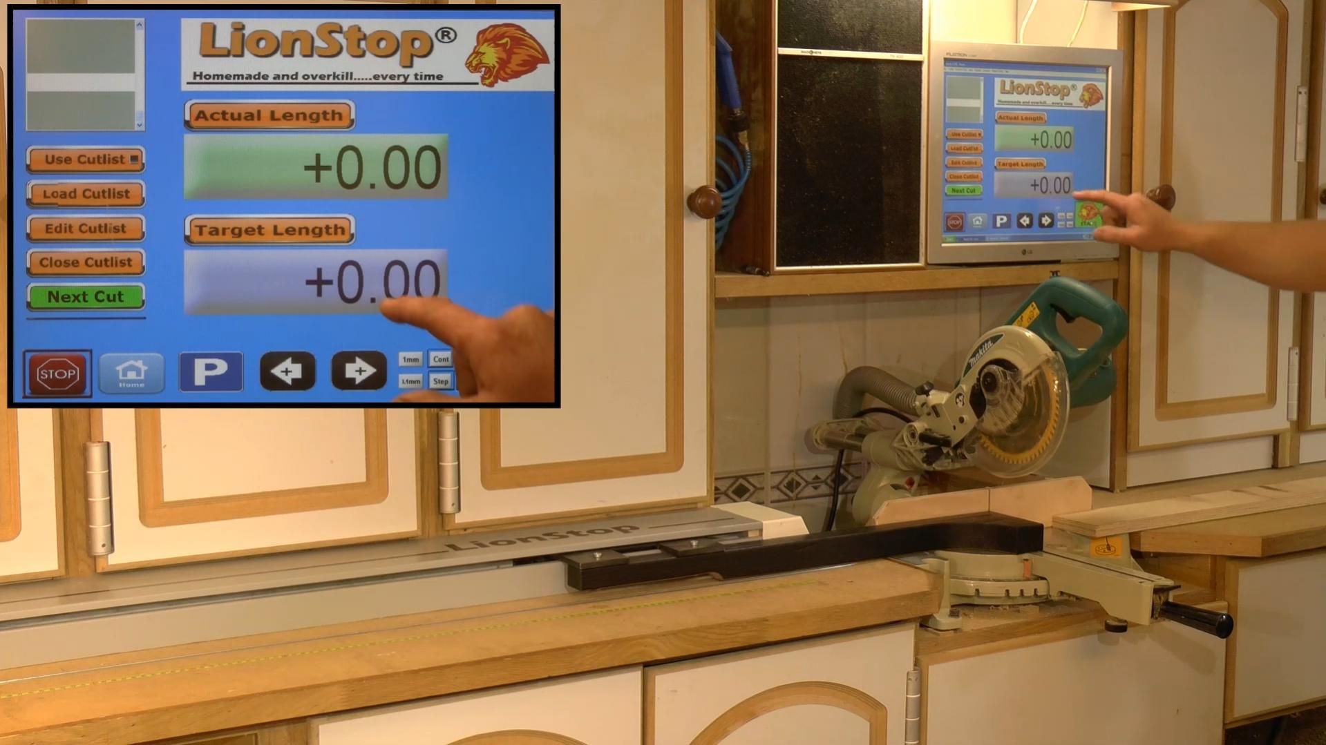

Here is an overview of the system, with the custom interface shown:
I built the operating screen on the base of the open software mach 3, made for cnc.
I fitted my own functions, and graphics.
To use it it is just a matter of punching in the desired length of cut, and the fence will move to the correct position.
It also has the option to use a cutlist, containing multiple cut dimensions
Attachment 22739

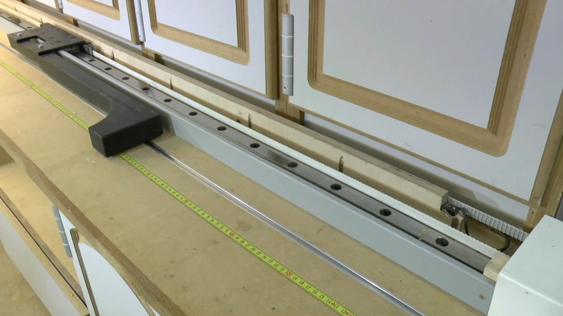

This is a closeup of the linear rail and belt and pulley system.
It is hidden under a cover normally.
Attachment 22740

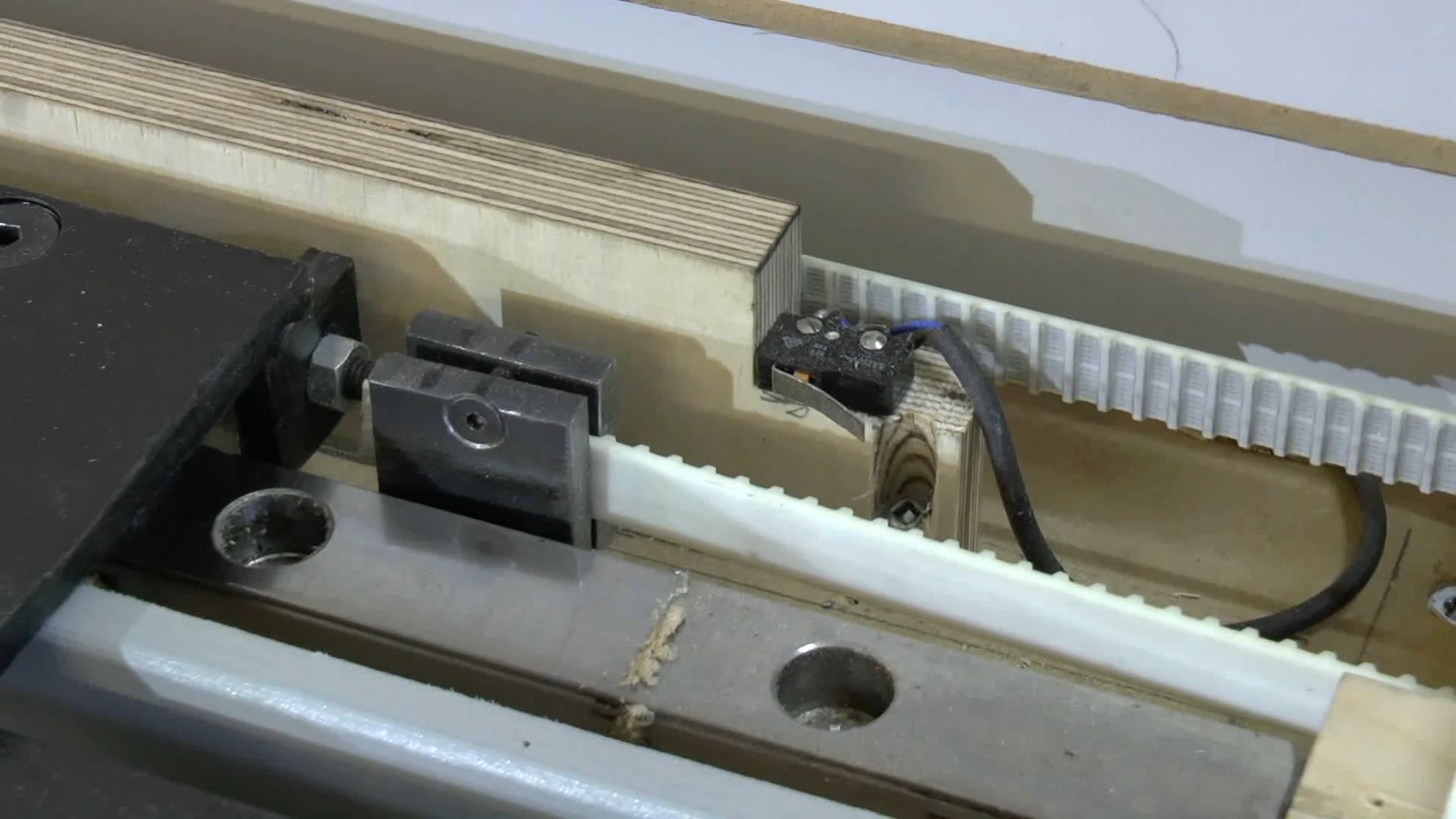

There is a homing switch to calibrate the system.
Attachment 22741

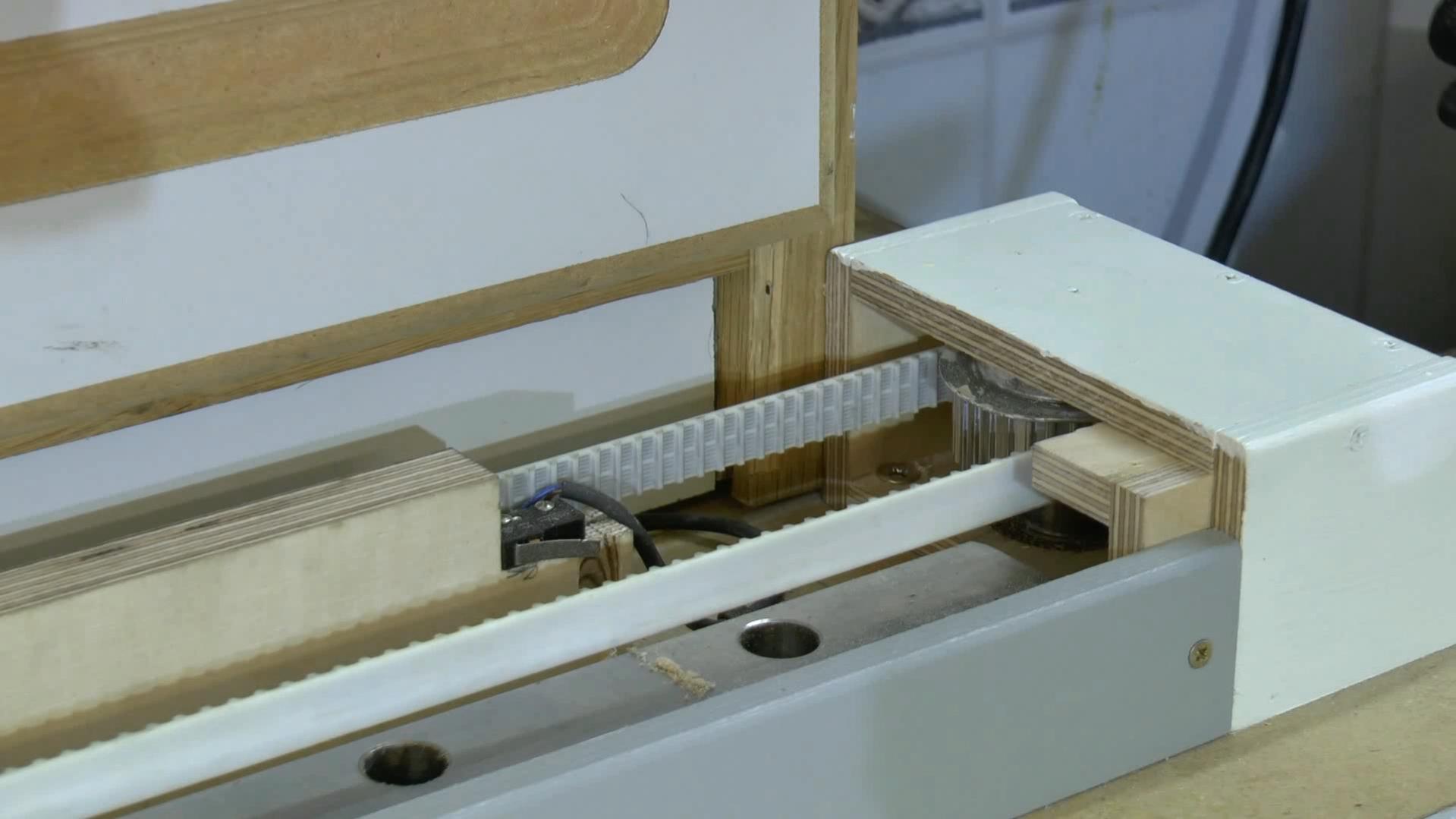

Each end of the rail has double bearing seated shaft and pulley.
Attachment 22742

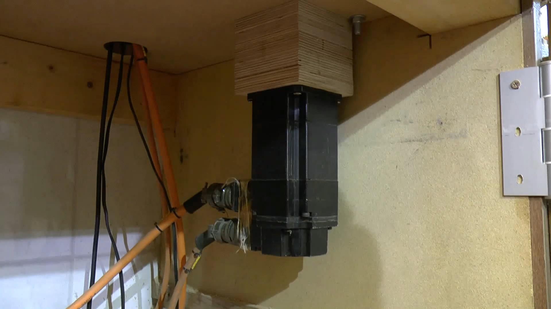

The servomotor i mounted under the bench. Because this i a closed loop system, meaning it has position feedback,
it does not matter if you bang the fence, it will always get back to position.
Attachment 22743

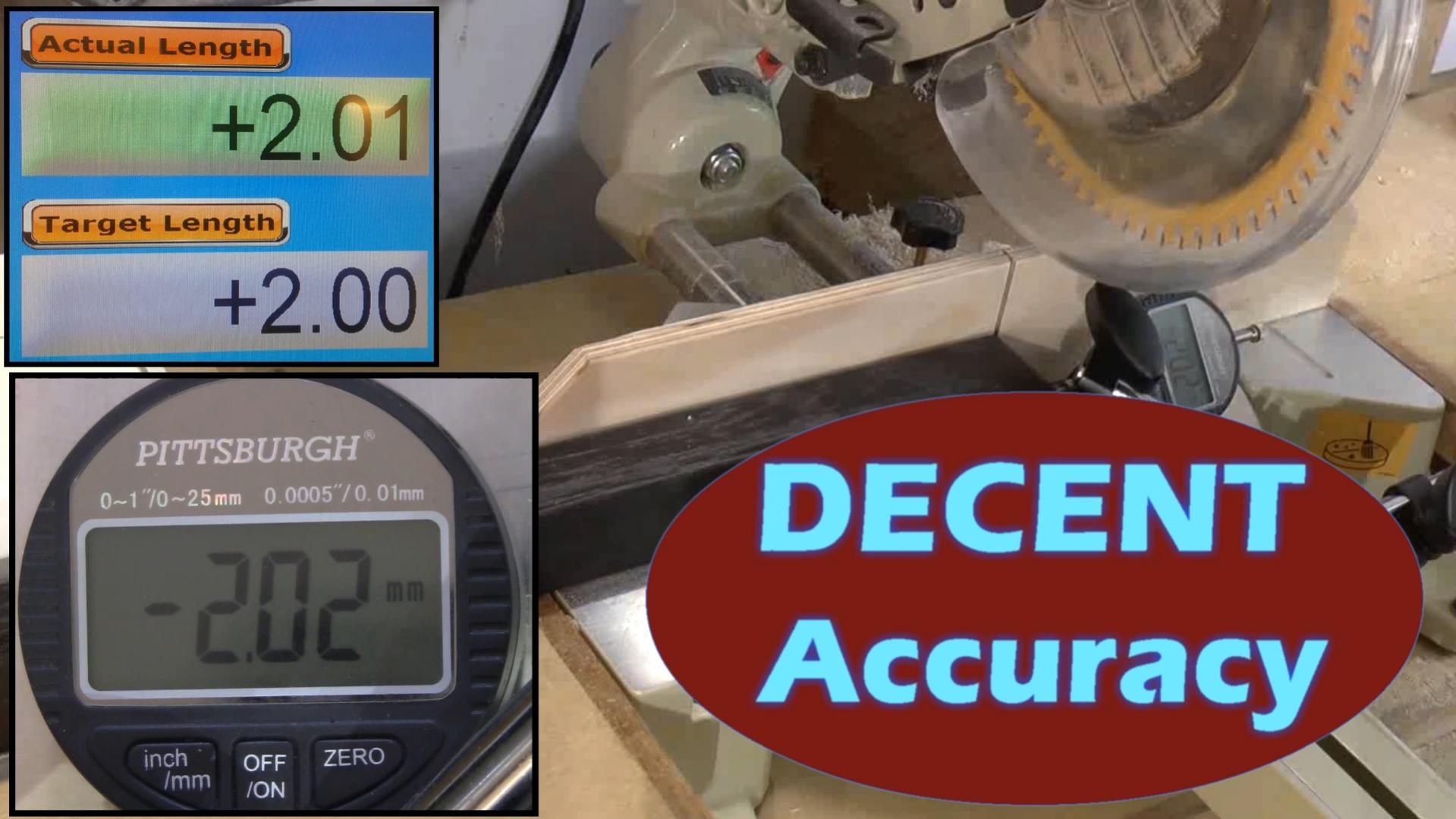

I made a setup to check the accuracy with a dial indicator ( if you want to see more from the test, and its repeat-ability, check out the video)
Attachment 22744
