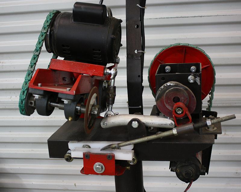

1 Attachment(s)
This might help. The blade advance and grinder lift is powered by a DC motor (originally adjusted treadmill angle). Grinding the cam was somewhat tedious, took too much off one area and had to build it back up as you can see.
