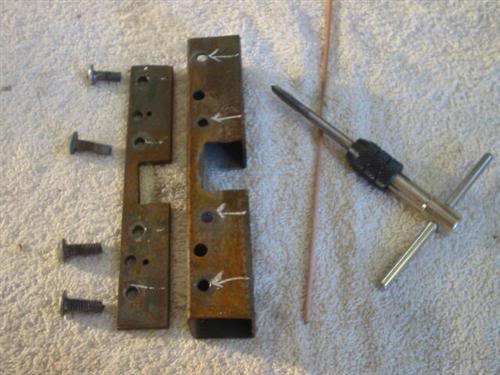

These are your basic ingredients:
Attachment 2643
Basically a piece of square tubing with a slot cut out in it and some flat metal, both about the same length.
Drill some holes to match whatever size bolt you wish to use and use a tap to make a thread in the tubing only.

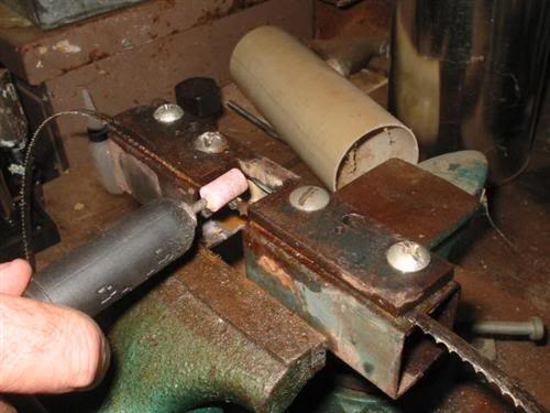

Place in a vice to hold the jig steady.
You then simply break a blade or two (I was getting quite proficient at that!) then file/sand/grind the two ends to form a scarf joint.
Attachment 2647

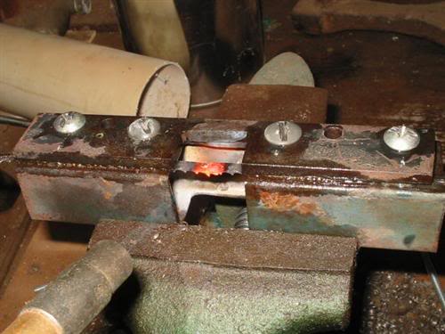

Solder away until your heart's content or you finish the solder joint :p
Attachment 2645
As you can see from my soldering, I am a woodworker :hattip:

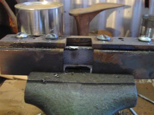

Judicious use of a grinder will smooth the blade after soldering and make you look like a better metalworker, but don't be fooled.
Attachment 2646
