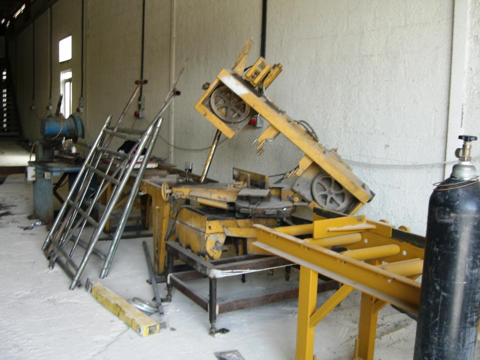

Yes I made mine for a couple of band saws that I made
Attachment 41030
Attachment 41031
Both had 1" blades the wheels had a very slight crown as in only about .010" over .750" width and a .100" wide by .050" depth relief cut next to the flanges leaving .150" of blade exposed for the teeth

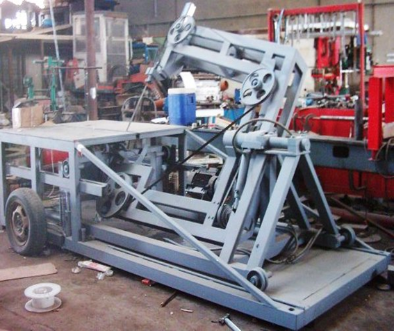

Yes and unfortunately that picture and my drawings of it is all I still have of it.
I built it to primarily saw composite panels with up to 40 CM thick. it is a hydraulically fed roll in saw which can tilt up to 45° to either side roll in through up to a 1.5 meter wide panel or the blade guides could be rotated so the panels could be cut lengthwise Also it he frame could be raised and locked imposition for up to 45° for cutting the edges of the length of the panels. 2 speed 5 hp 415v 50 hz motor and 3 speeds belt drive slow enough to cut 10" thick steel in the lowest speed and fast enough in the top speed to rip through the metal clad foam panels as fast as you could feed them through.
it was fully mobile just rotate the axle down lock in place extend the tongue on the opposite end and trailer it to the job sites We generally ran a 10-14 tooth blade on it which we bought by the roll because it was something like 24 feet long 1" wide

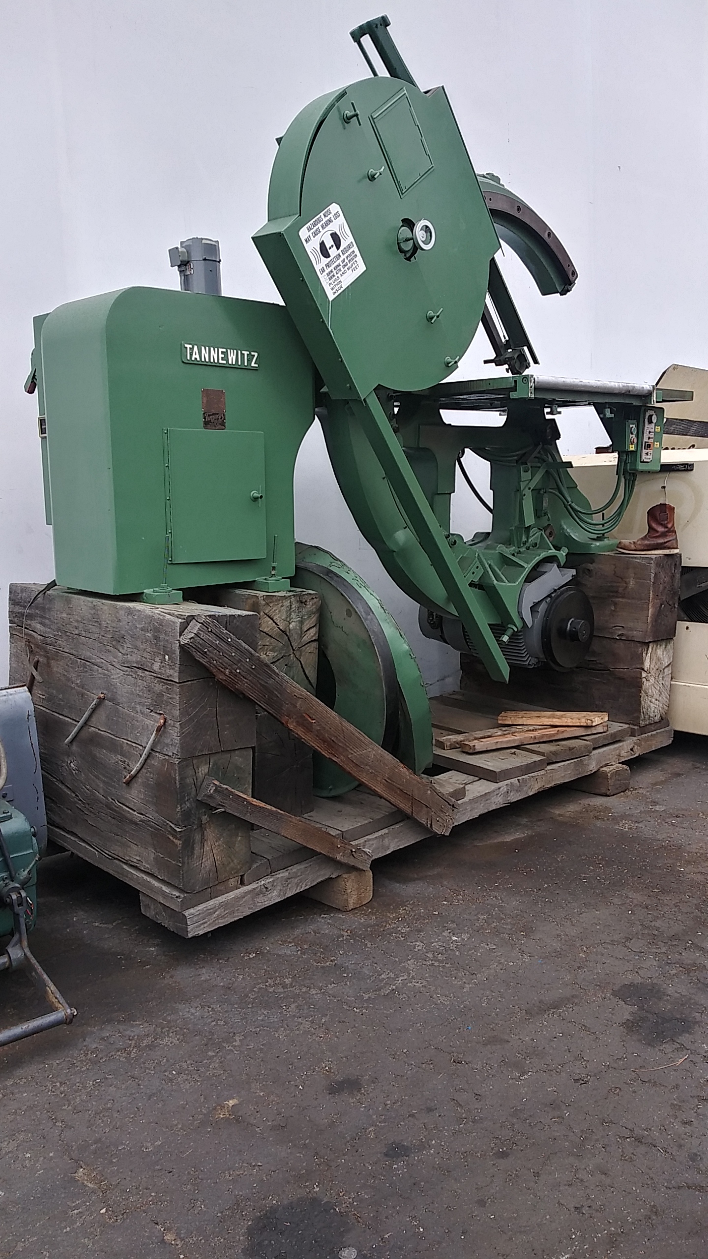

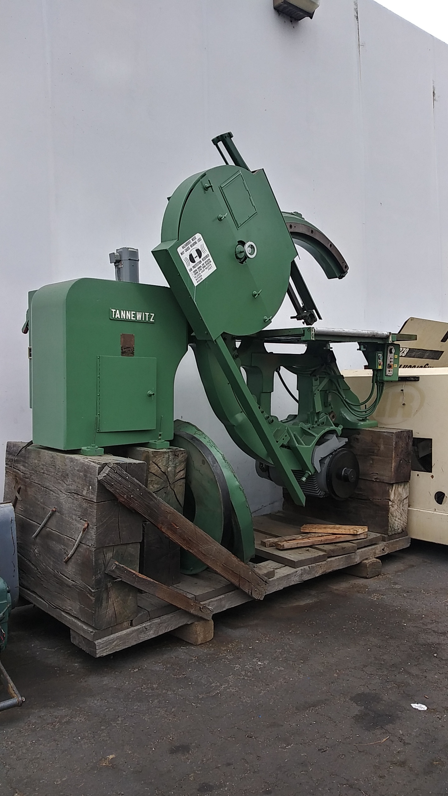

Because I couldn't get this to him first.........The operator station is in the box on left, which mounts to floor. A large undercarriage houses lower wheel, in a pit below floor level, keeping table at normal work height.
Attachment 41063
This pic I staged next, with an item added for scale, sort of a "Where's Waldo?" for perspective.
You'll find it, adding that I'm afterall, not a big guy.....
Attachment 41064
This originally equipped the Patternmaker's Shop at Long Beach Naval Ship Yard, here in CA. Along with monstrosities like a 56" double end disk sander, 6'+ swing Oliver Patternmaker lathe, horizontal doweling machines large as a boring mill, 16" or 20" radial arm saws, pool table size jointers...... Can't find apt comparison for the huge planers.
Still, Frank S's saw is remarkable, being fully fabricated, not out of commercial castings.
""Where's Waldo?" for perspective." - The boot toe?
Yup, on cribbing for the right side. Hopped around on one foot getting far enough back camera wise.
