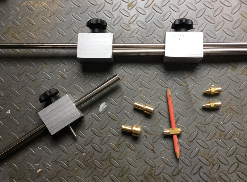

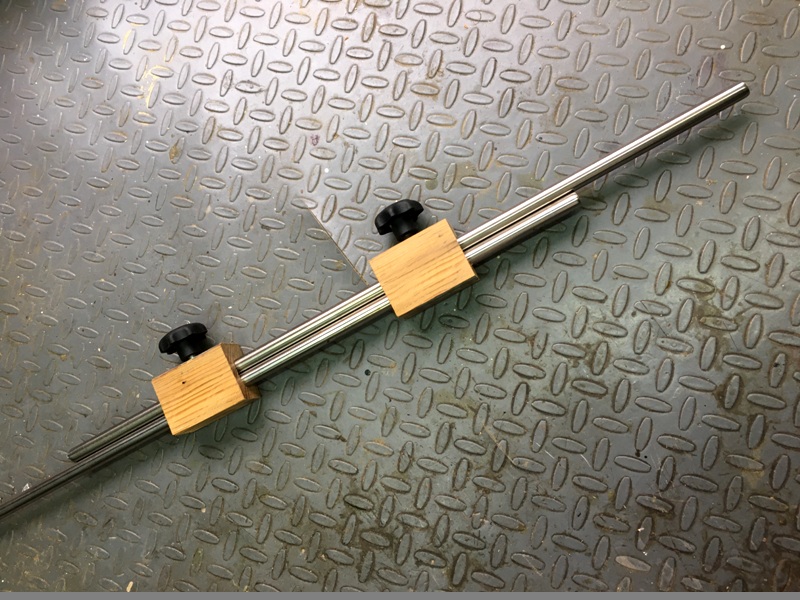

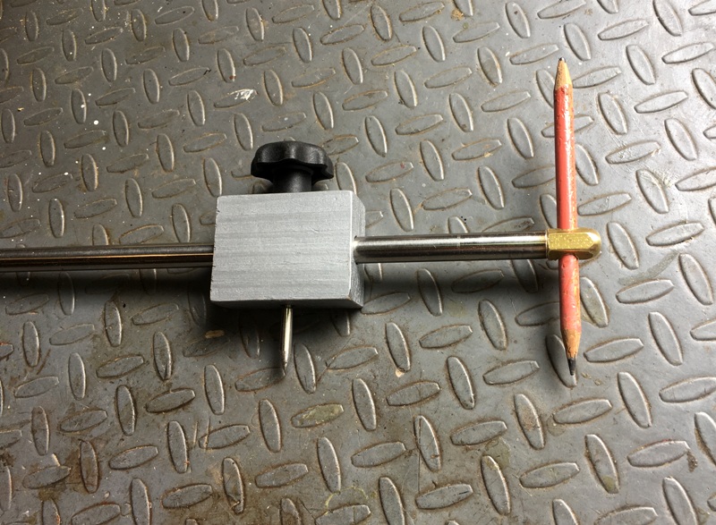

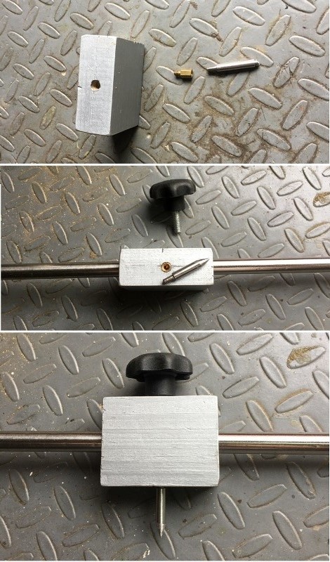

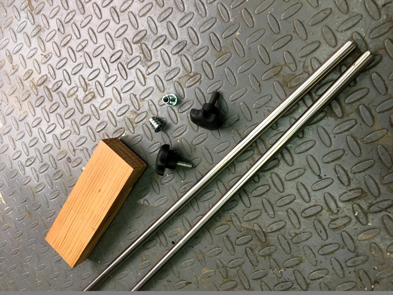

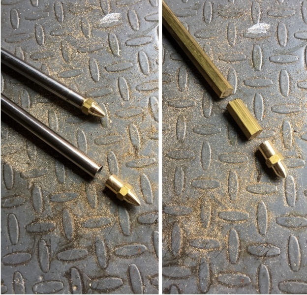

This tool is inspired in some commercial items:
Veritas Tools - Measuring Tools - Bar Gauge
https://www.woodpeck.com/onetime-too...stem-2019.html
http://www.rockler.com/rockler-3-in-1-bar-gauge

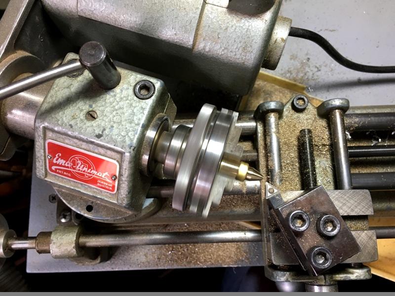

The sliding bodies are 2 x 1.75 x 1” wooden blocks, the bars are 3/8”Ø steel tubes, the trammel head and tips are brass pieces made with the Unimat lathe.
Attachment 36781
Attachment 36784
Attachment 36785
Attachment 36788
Attachment 36791
Attachment 36792
Attachment 36793
Attachment 36794

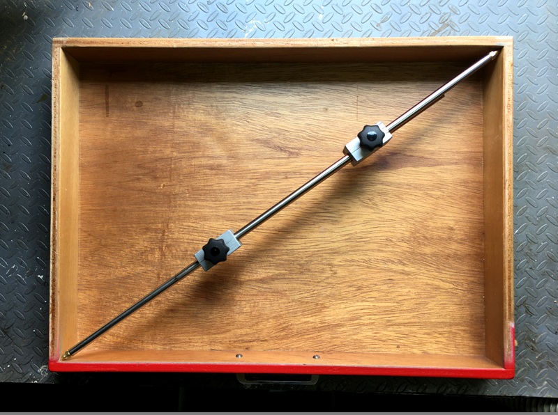

This tool is useful for inside measurements (blunt-end tips), for checking diagonals and verify that an assembly is square (arrow-shaped tips), for transferring a dimension directly to the table or miter saw, and for scribing circles or arcs (trammel head).
Regards.
