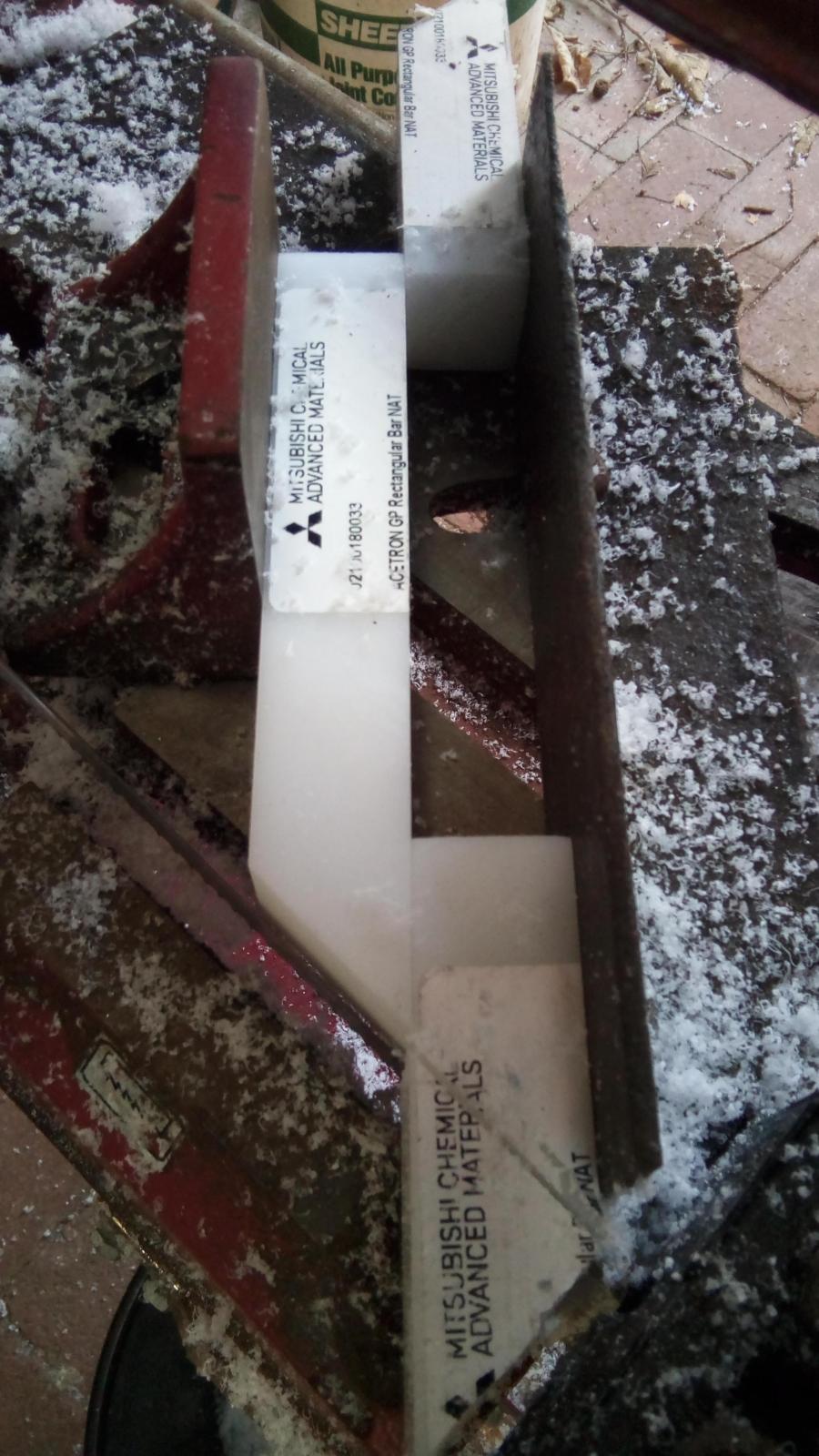

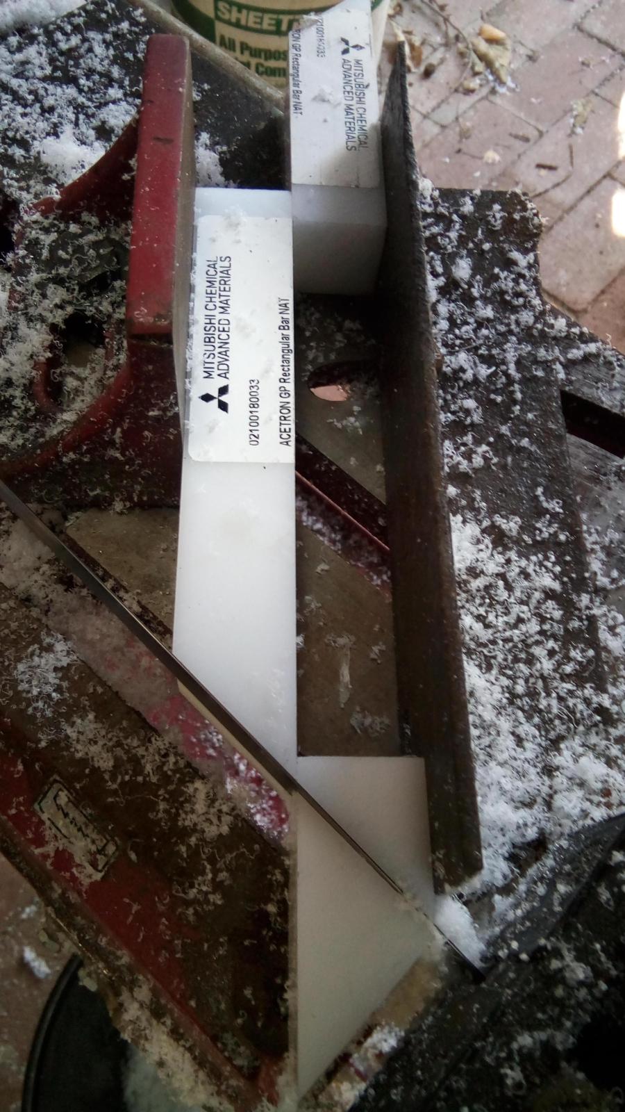

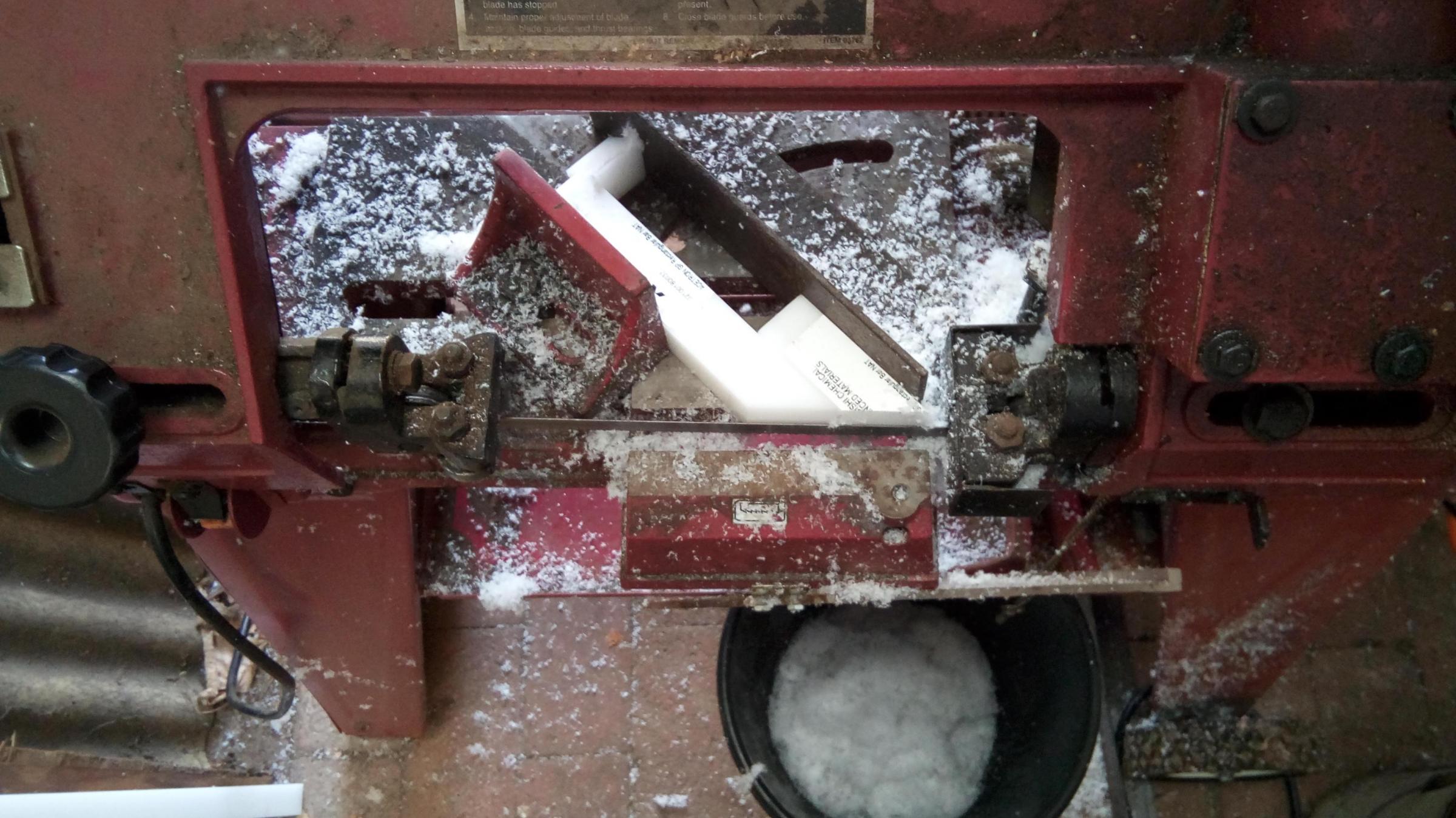

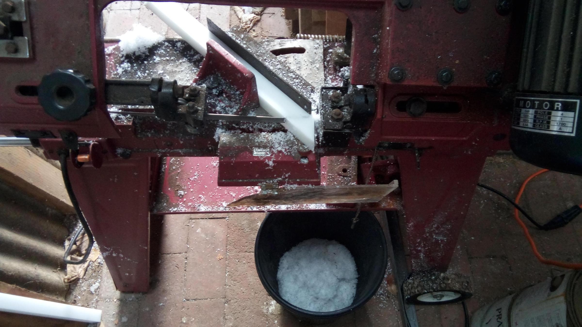

Nothing earth shattering here, but might help a new person.
Use a piece of material as a clamp extension so you can cut that last little bit off the expensive POM rod.
Note: Only use a short piece as a spacer, if you go full length you might be holding the spacer tightly but not the piece you're cutting.
Also shows Silicon Valley Snow, POM shavings. :)
