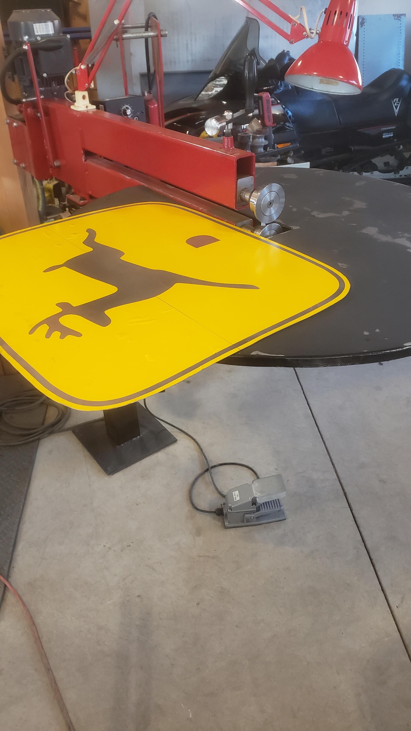

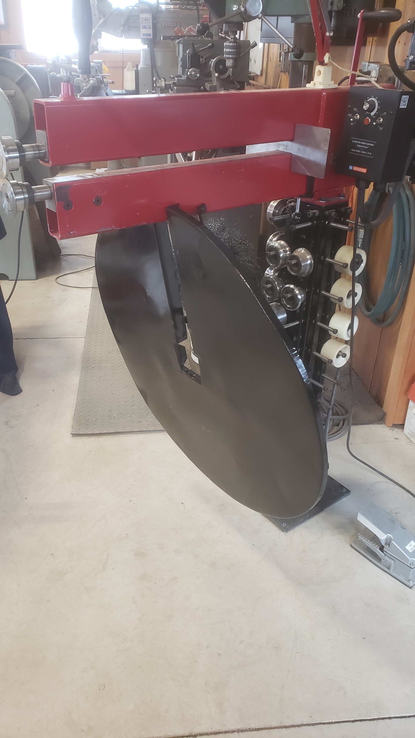

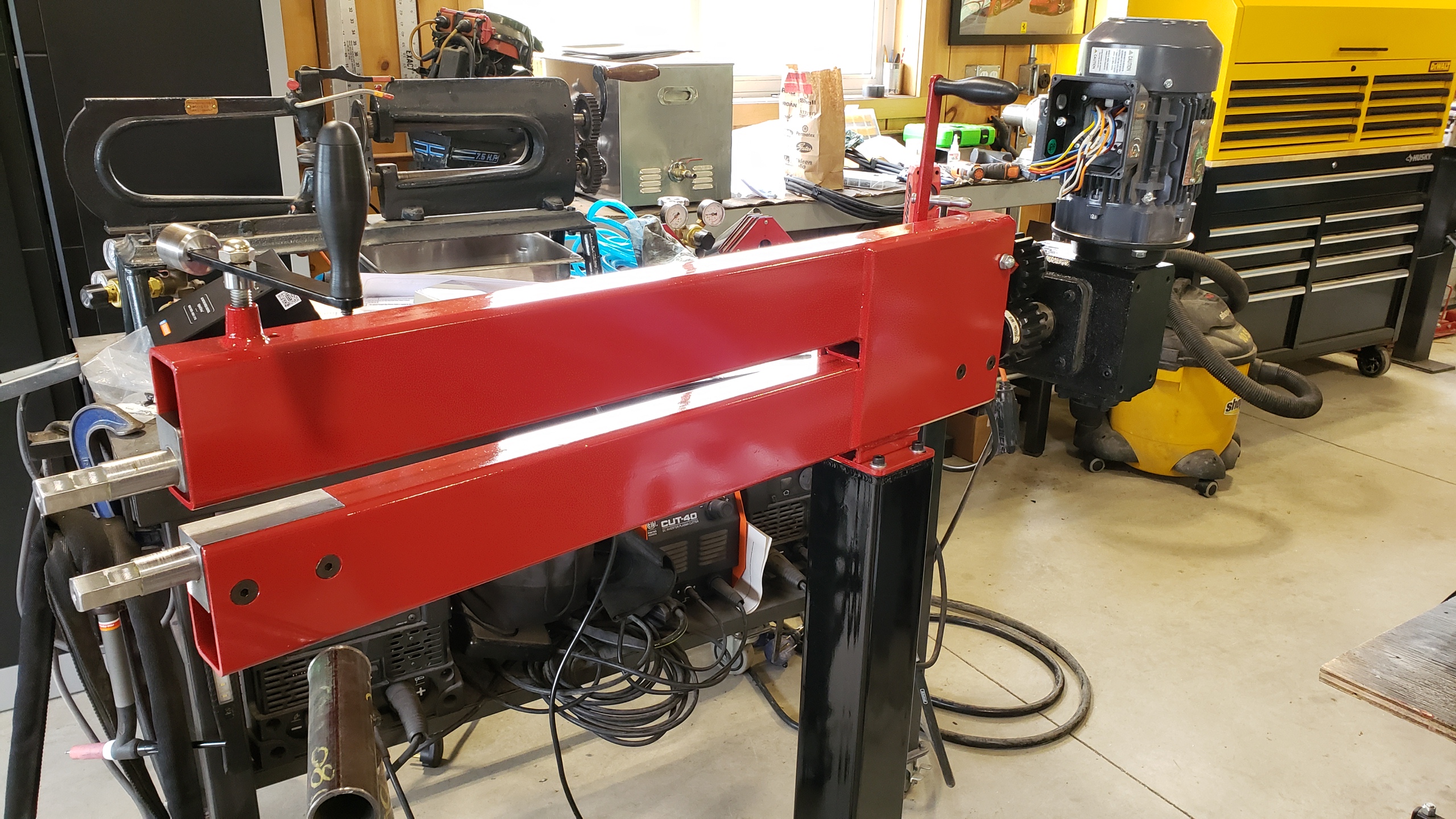

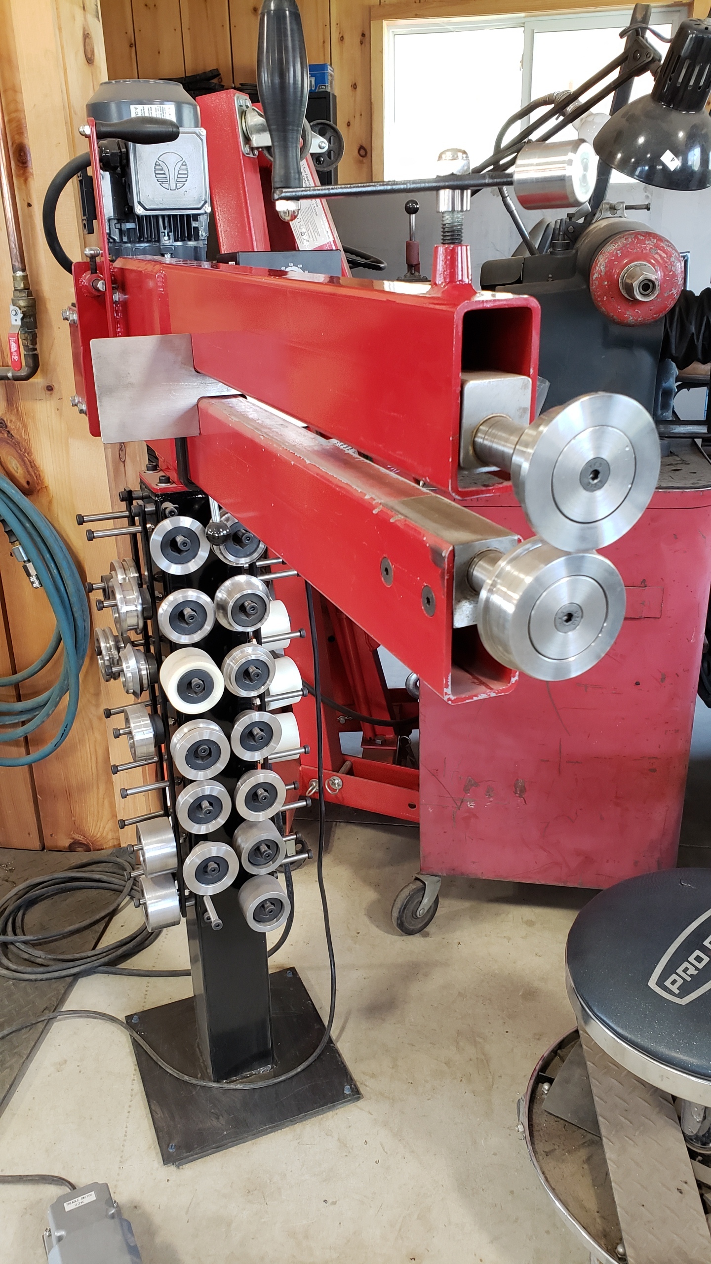

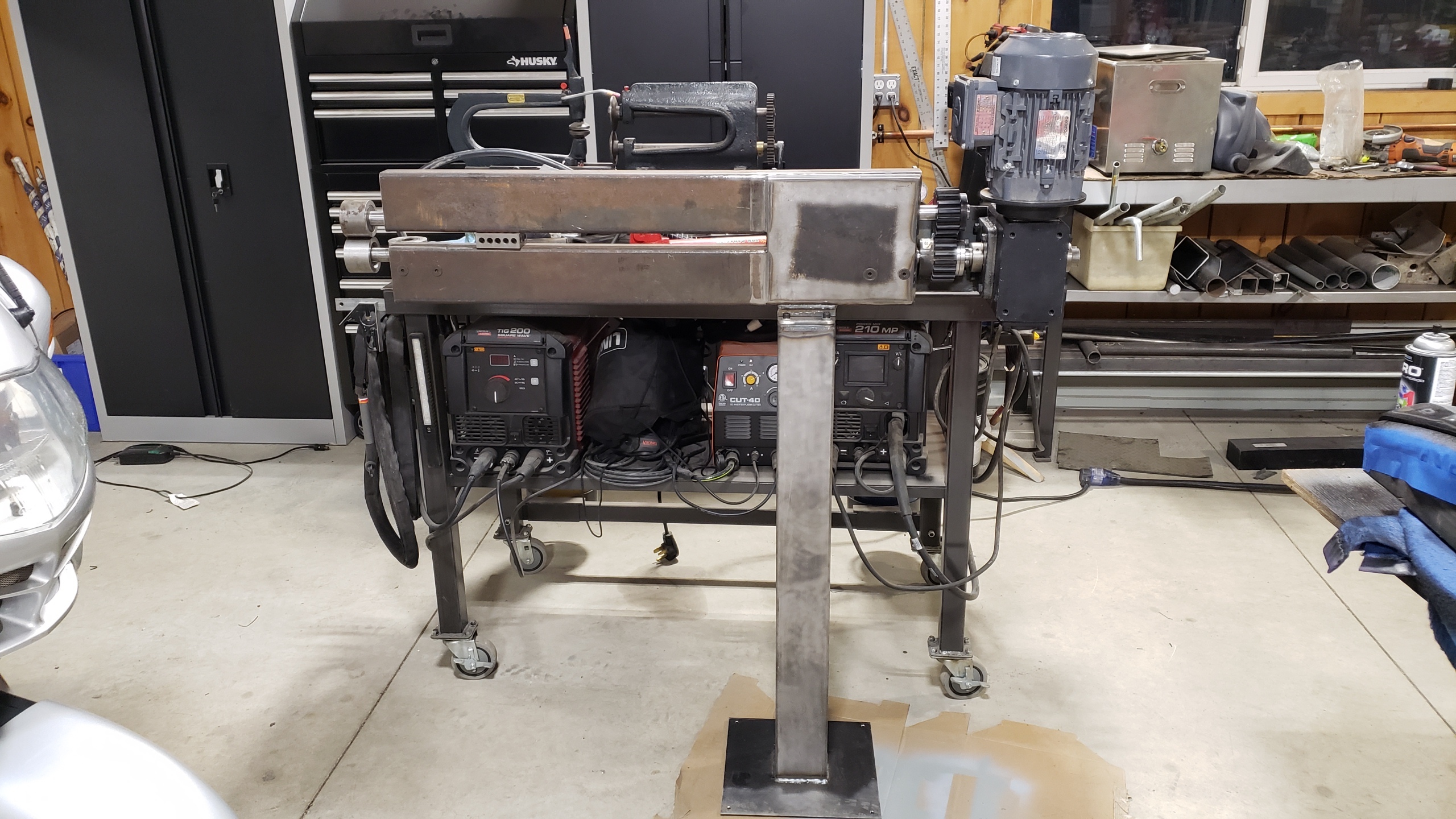

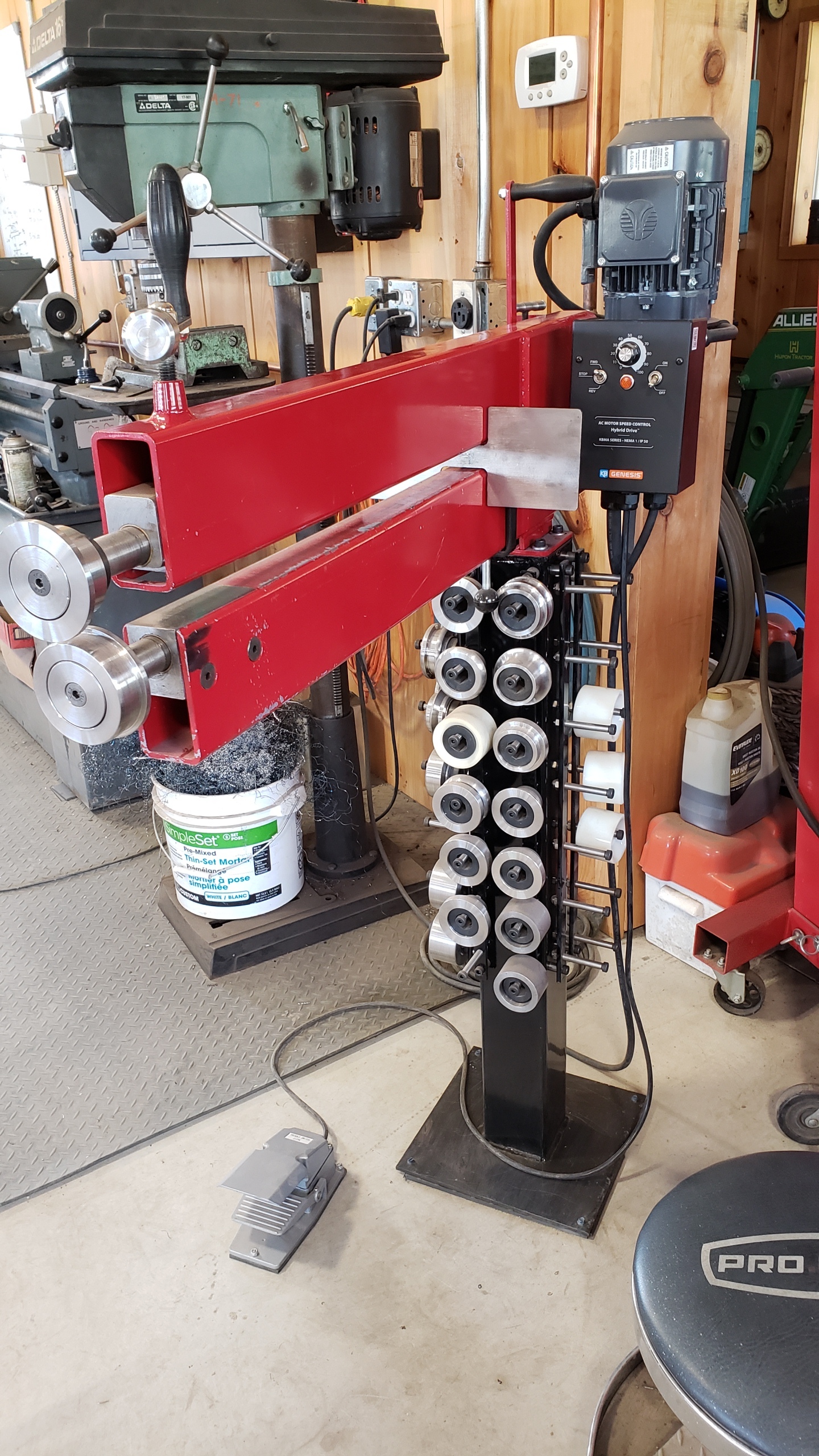

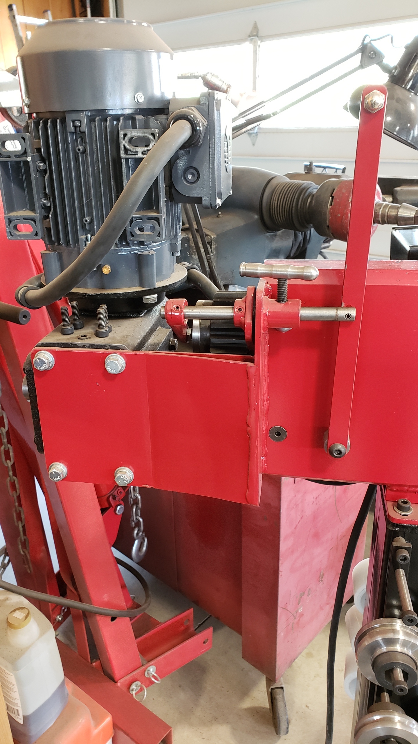

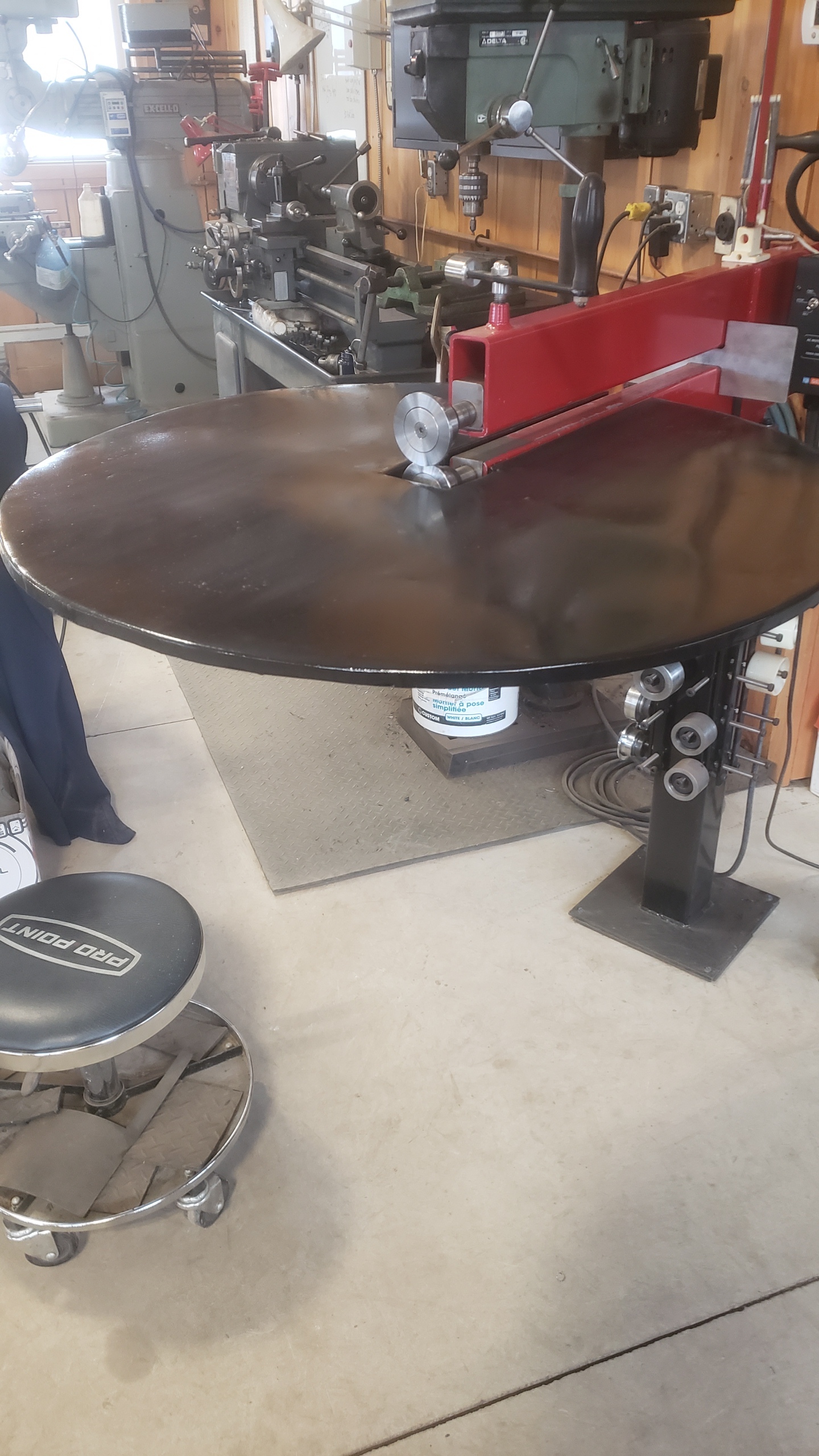

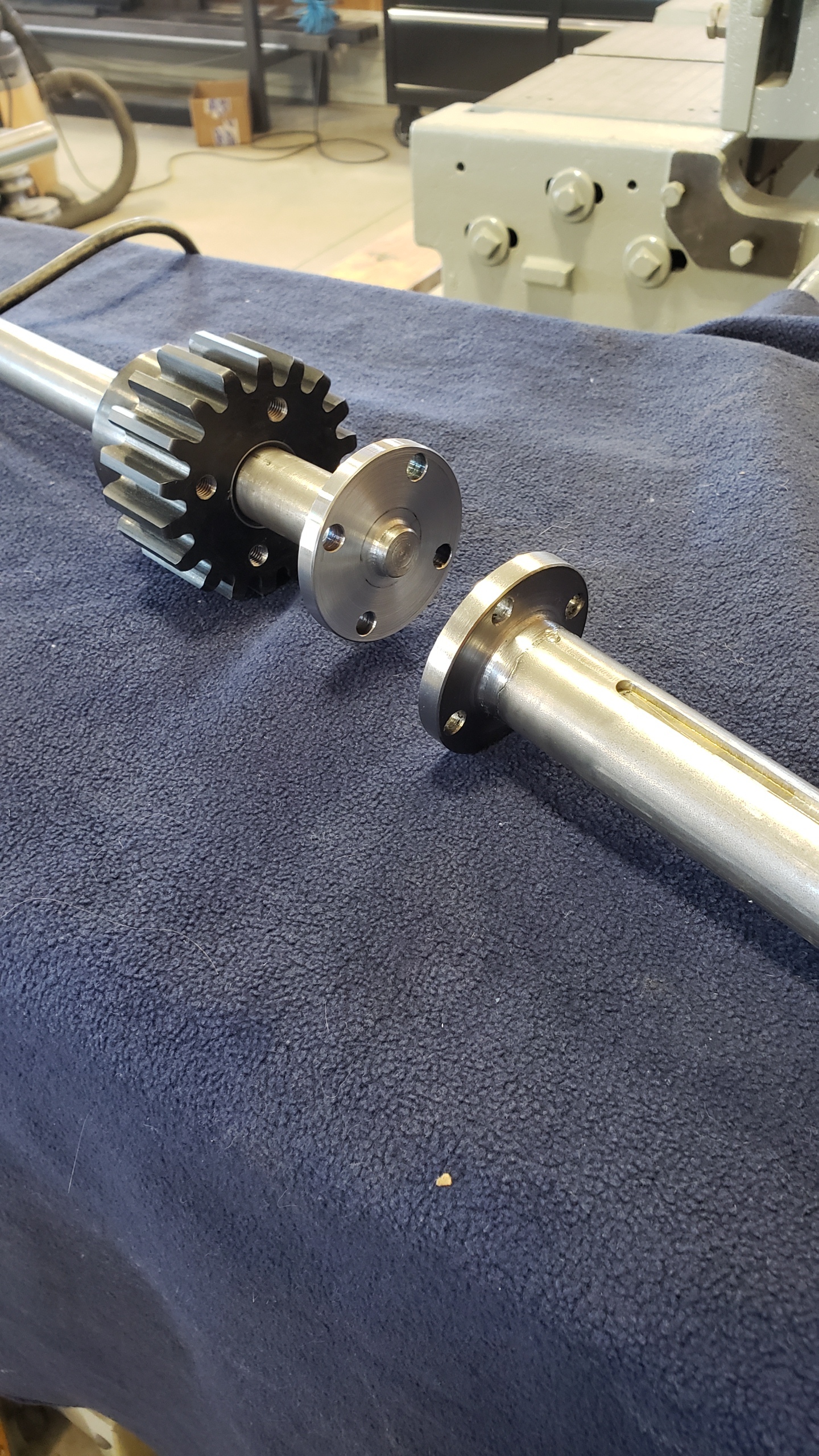

I built this bead roller a couple of years ago or more. I find that I use it for a variety of projects and I make up new dies as needed. I added the round table after the first year to make it easier to support longer pieces. Two bolts hold it up in place so it`s pretty easy to move it into position or down out of the way. I might change it as some point because I have to lower the table to change the lower die. I`ve used the machine on 20 ga. steel and it doesn`t even flinch at that so I`m sure it would handle 18 ga or heavier if needed. It`s got plenty of grunt!Attachment 48387Attachment 48388Attachment 48389Attachment 48390Attachment 48391Attachment 48392Attachment 48393Attachment 48394Attachment 48395Attachment 48396
