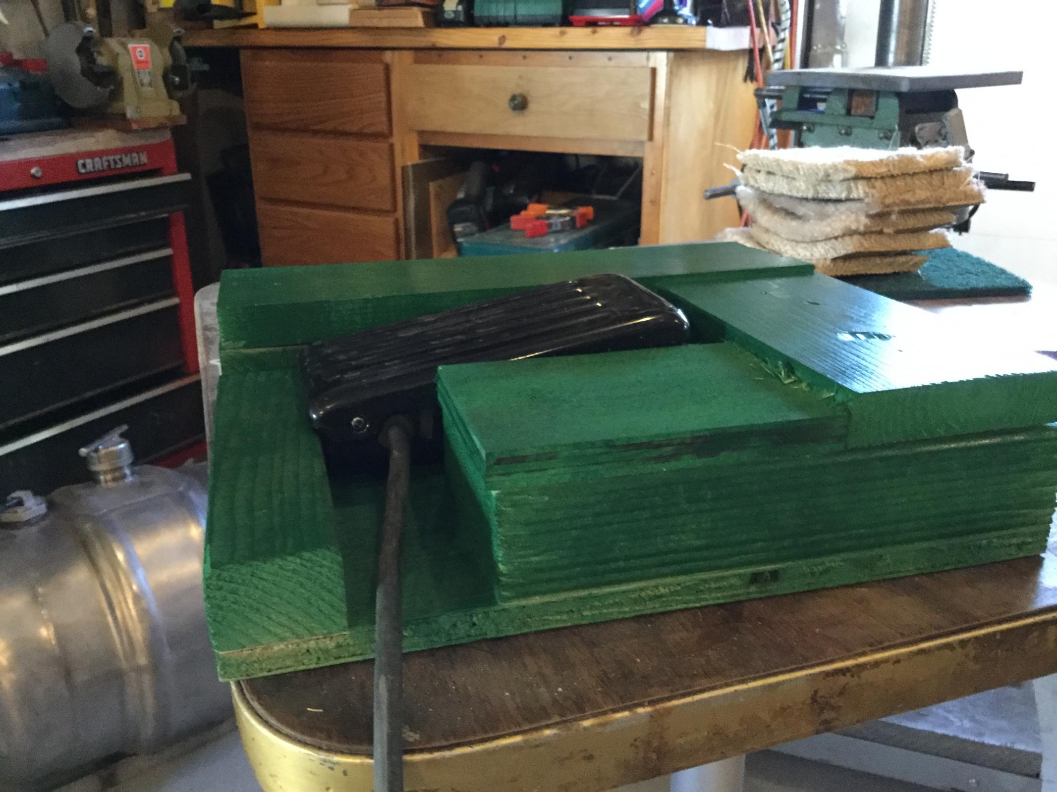

I have the usual sewing machine foot pedal speed controller for my bead roller. I was unable to accurately control the speed. I built a square plywood pad and mounted the pedal on it. On each side I put varied thickness’s of blocks. Depending on speed needed is where I put my foot
Attachment 27471Attachment 27471
Cheap, simple and it works!
