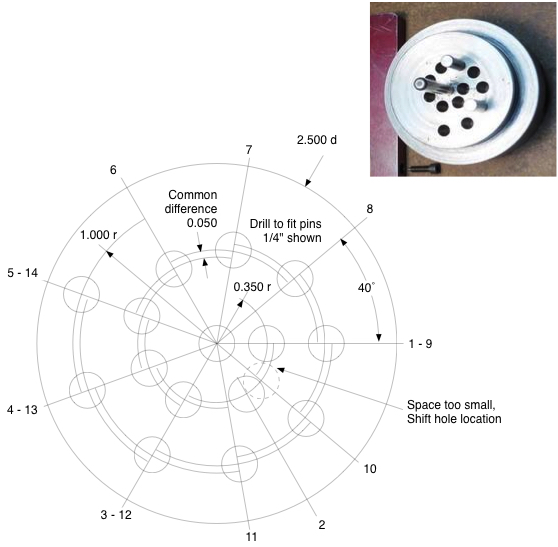

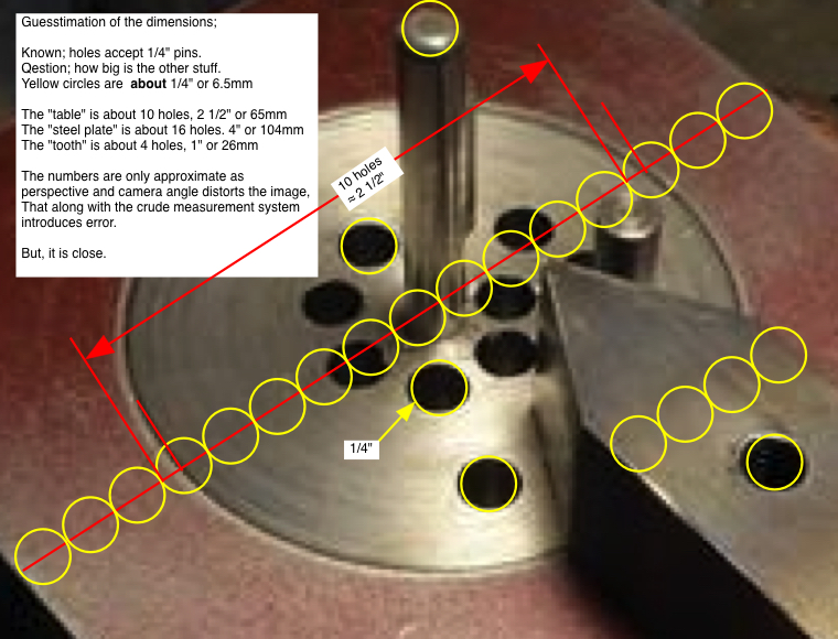

Found this thread while looking for some bender ideas. In order to begin work on mine, I did some estimating of sizes from Marv's images. I shared them here for anyone who may be interested. They may not be exact, but should be close.
Attachment 49639
This hole layout is not an actual Archimedean Spiral. It is simply a geometric construction for a set of holes varying in distance from a center point.
It is to scale so if you print it so the main circle is 2 1/2", the rest will be correct.
Attachment 49640
Just beginning the project, will provide details on the completed project in a new post at a later date.
I wanted to give credit to Marv for the inspiration.
