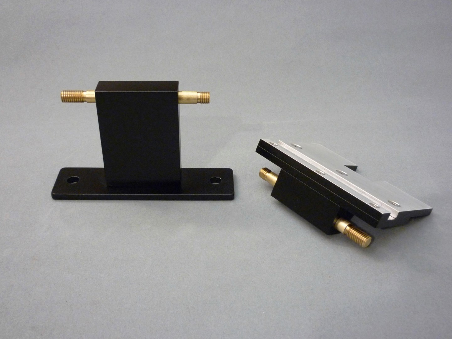

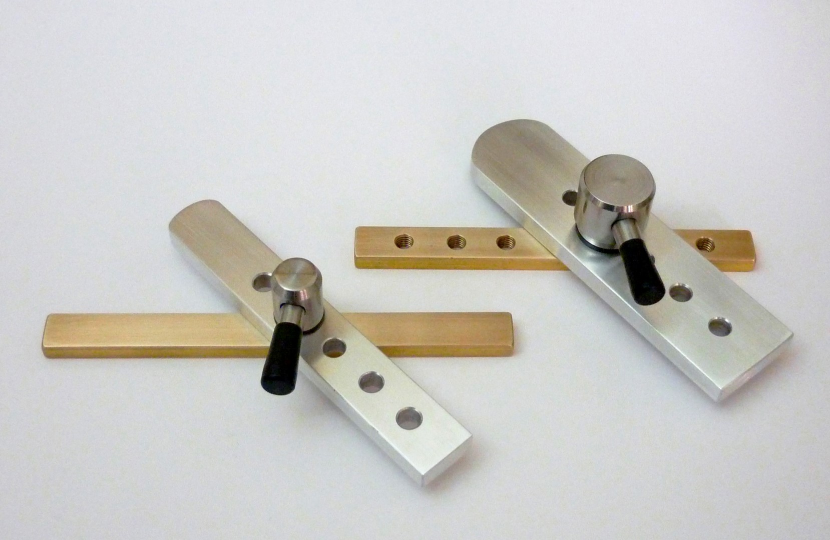

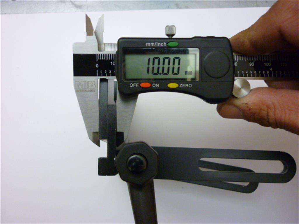

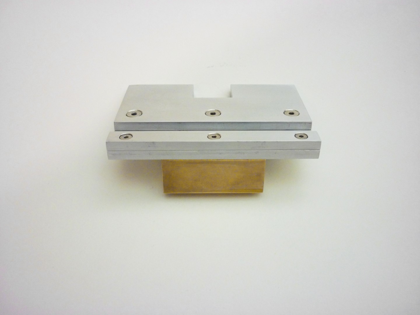

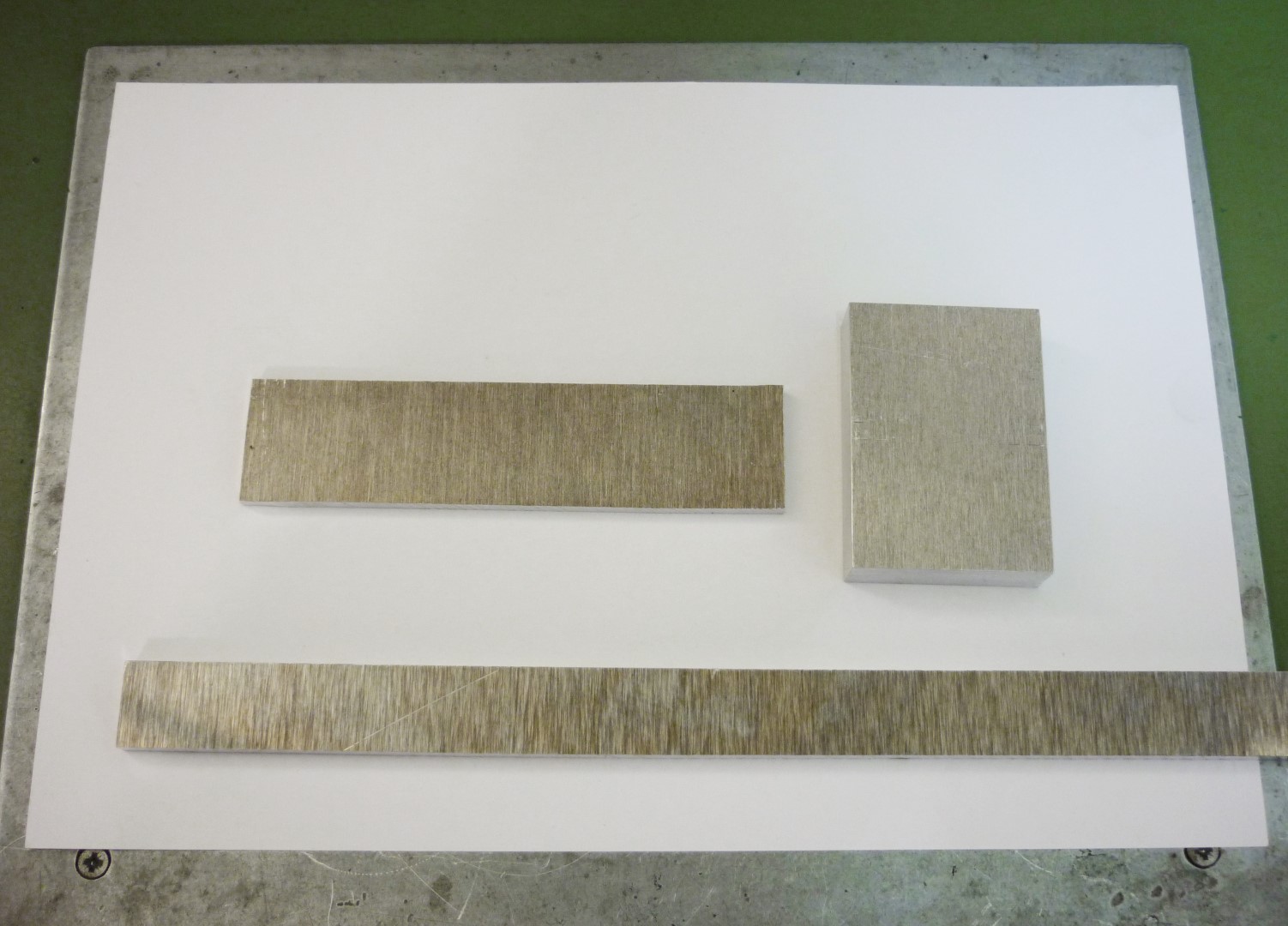

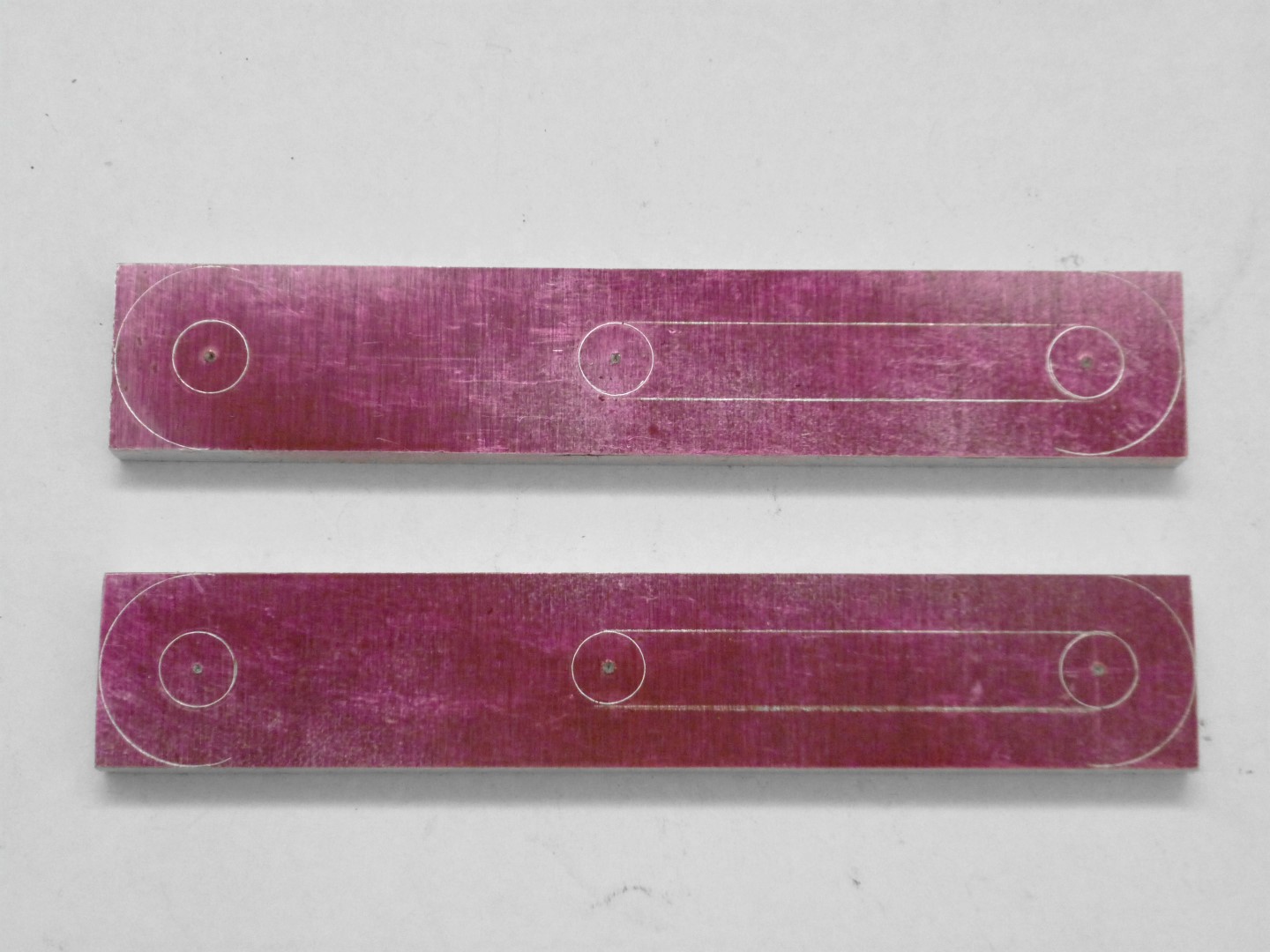

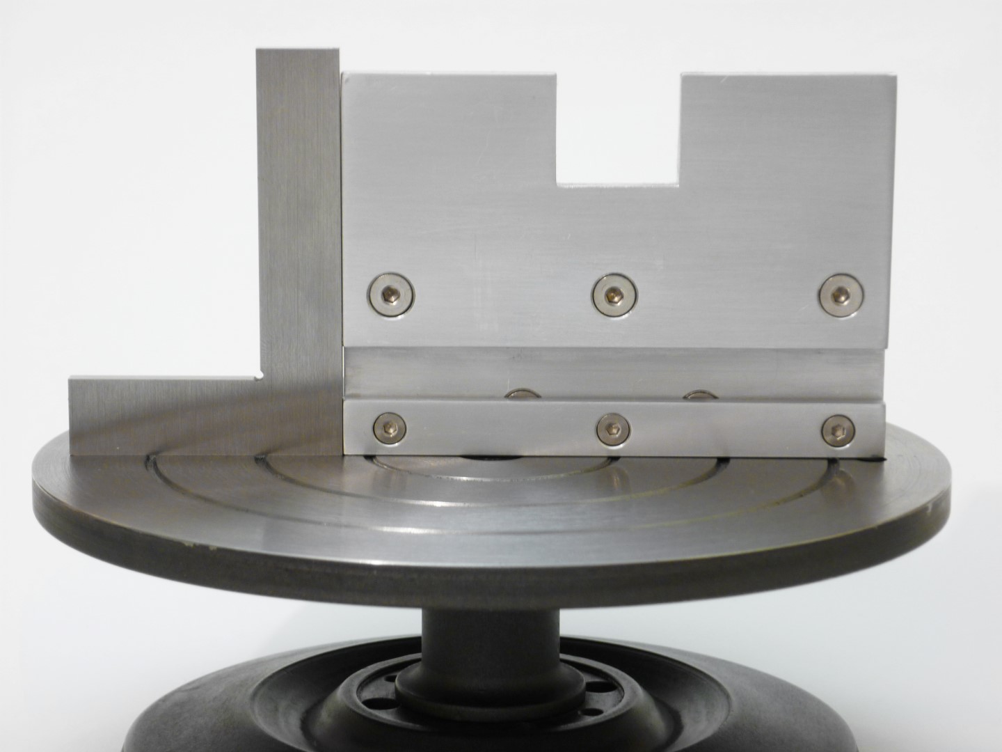

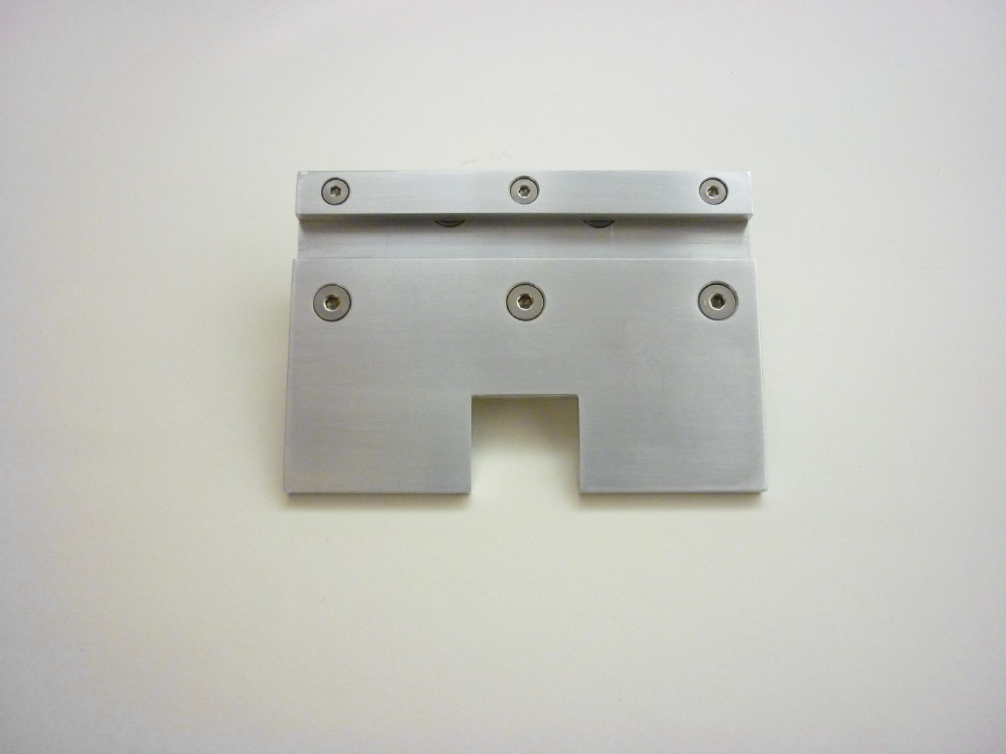

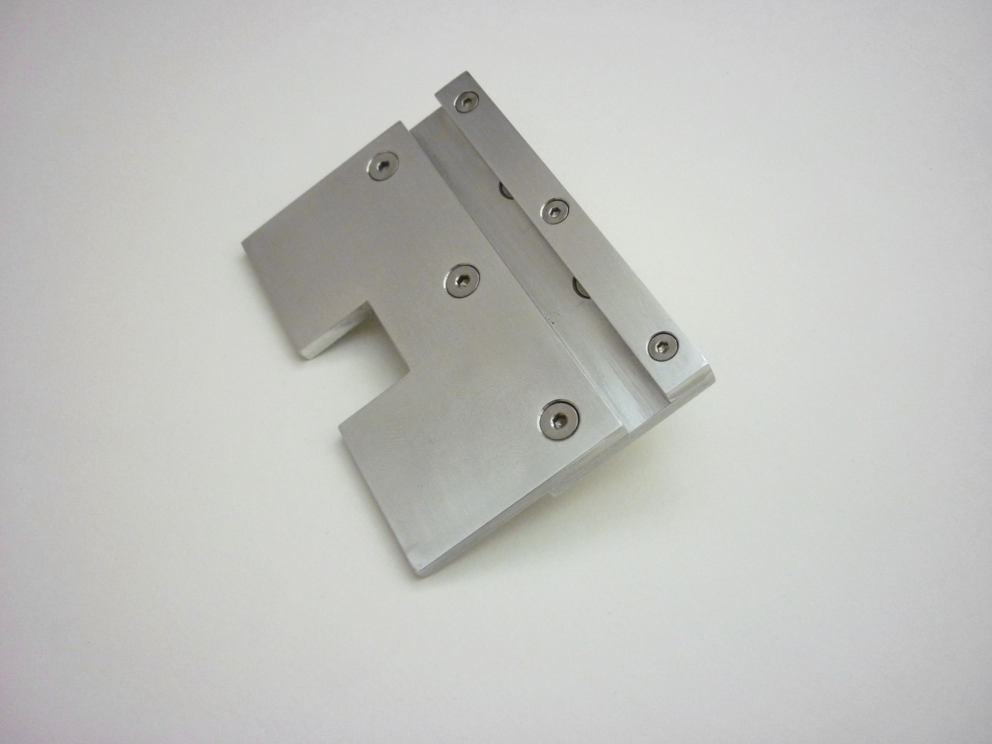

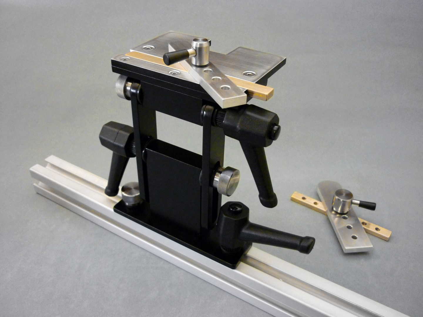

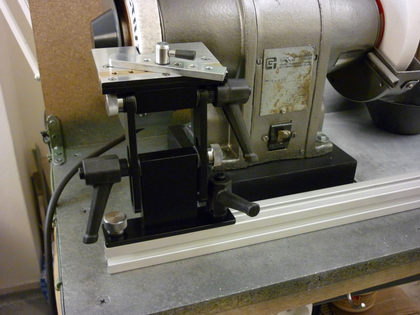

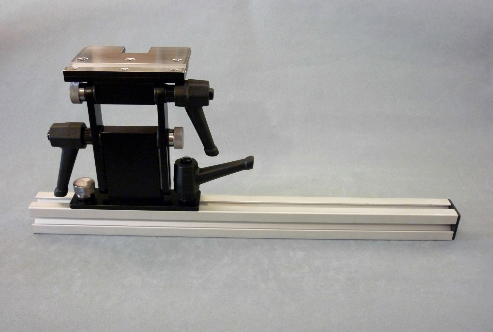

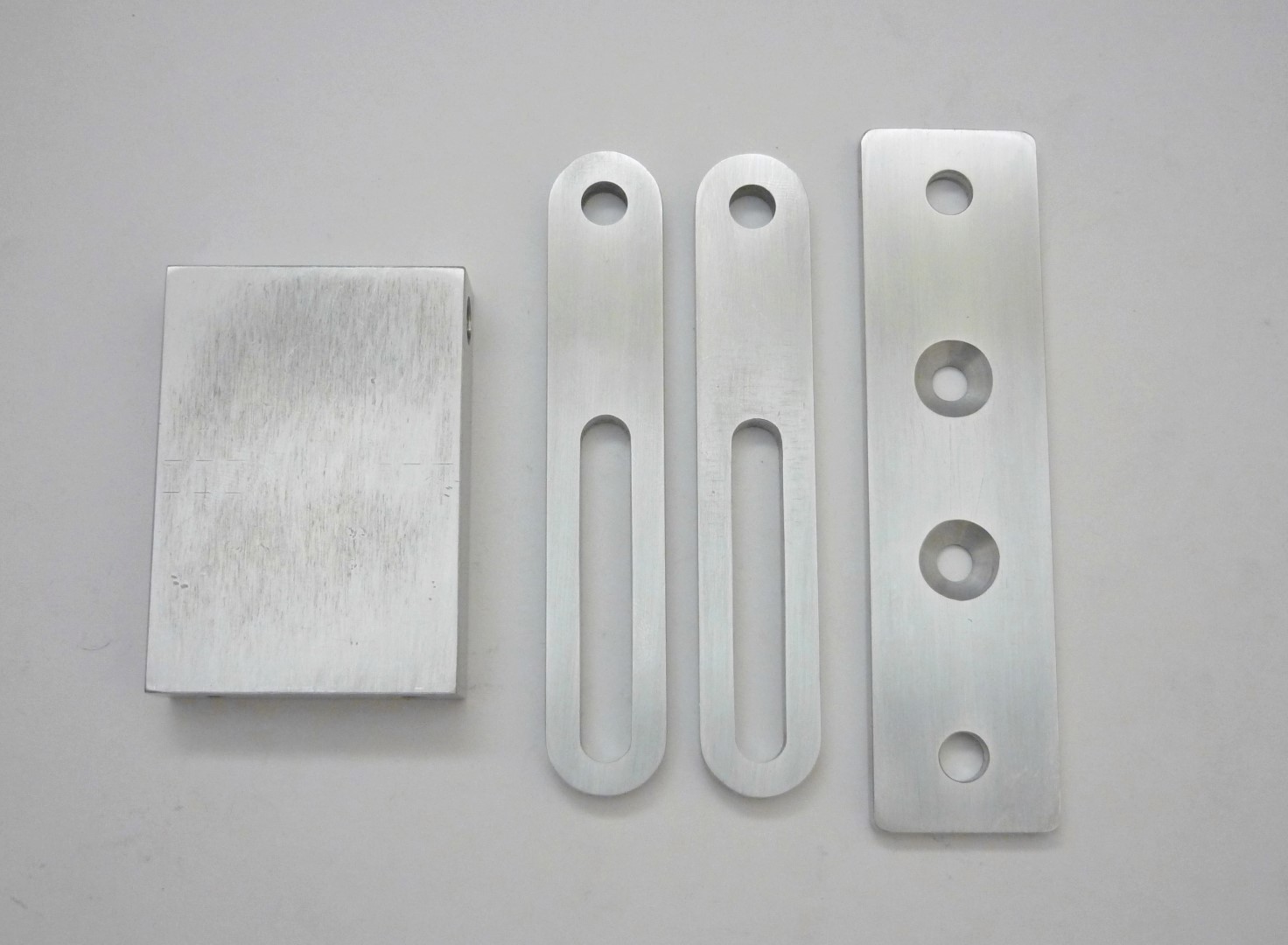

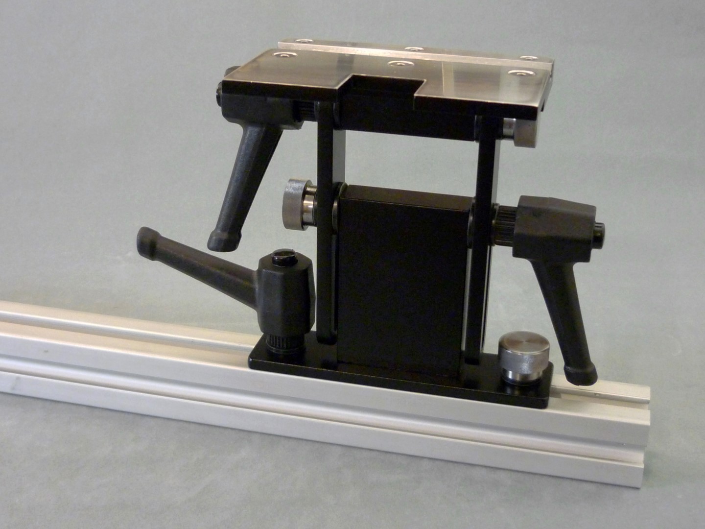

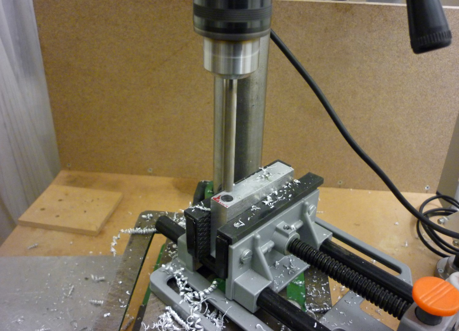

I would like to share with you one of my favorite projects, the bench grinder tool rest.
My bench grinder didn’t have tool rests. So, I decided to do something about it; I wanted a tool rest to help me grind accurately HSS and carbide tools. I searched the web and found a few different types; the one that attracted my attention is commercially produced by VERITAS®. So, I tried to make something similar as well as adding a few extra features to make it more versatile.
You will find three series of pictures showing the construction of the tool rest; each series is followed by a video as well. I hope that you will find it interesting.
All the best
Dimitris

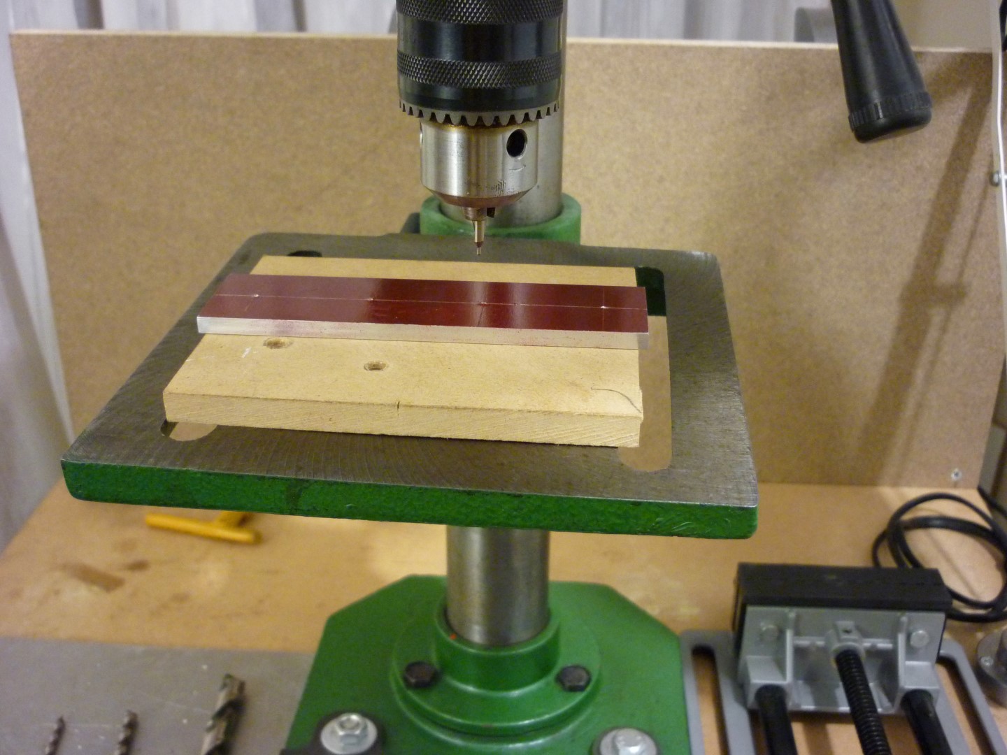

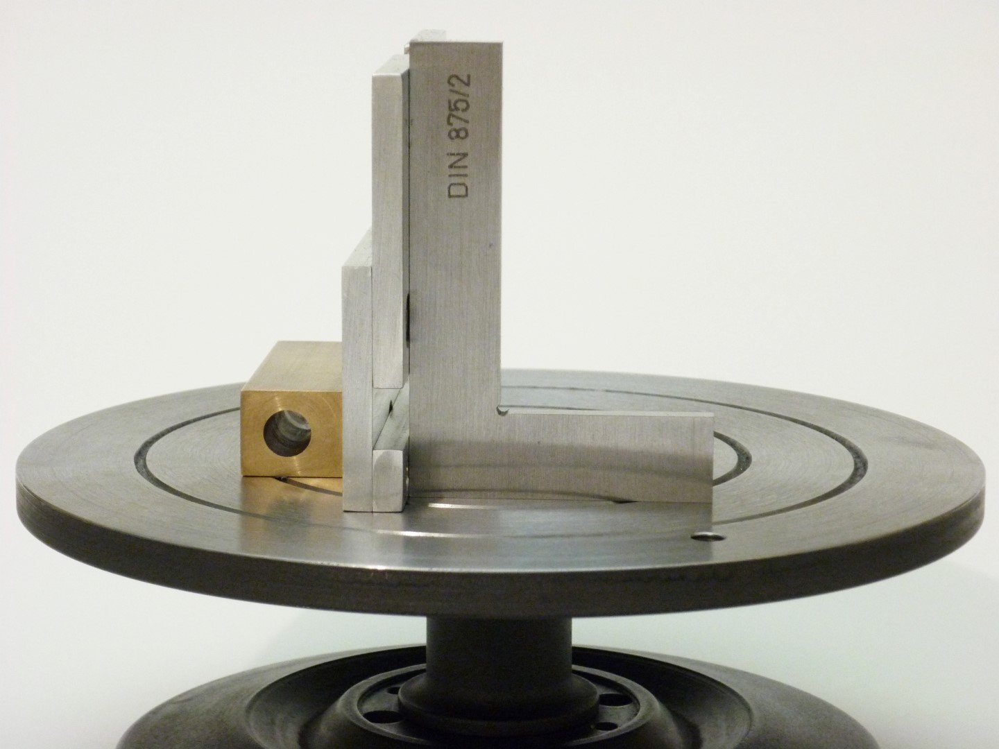

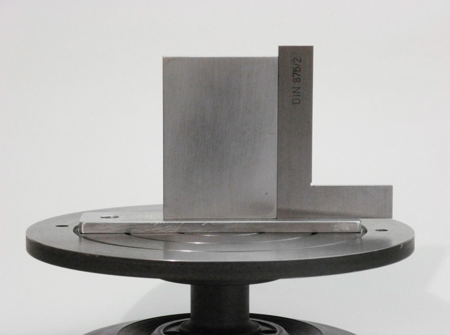

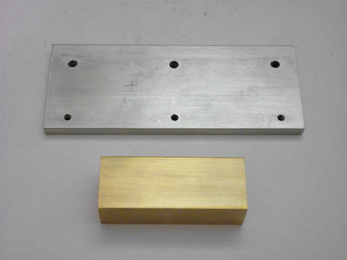

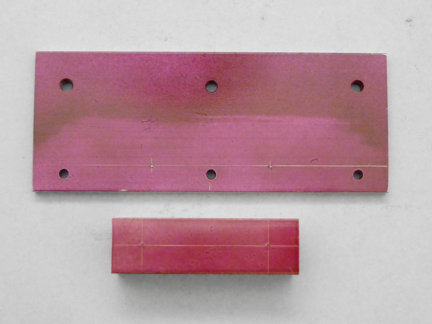

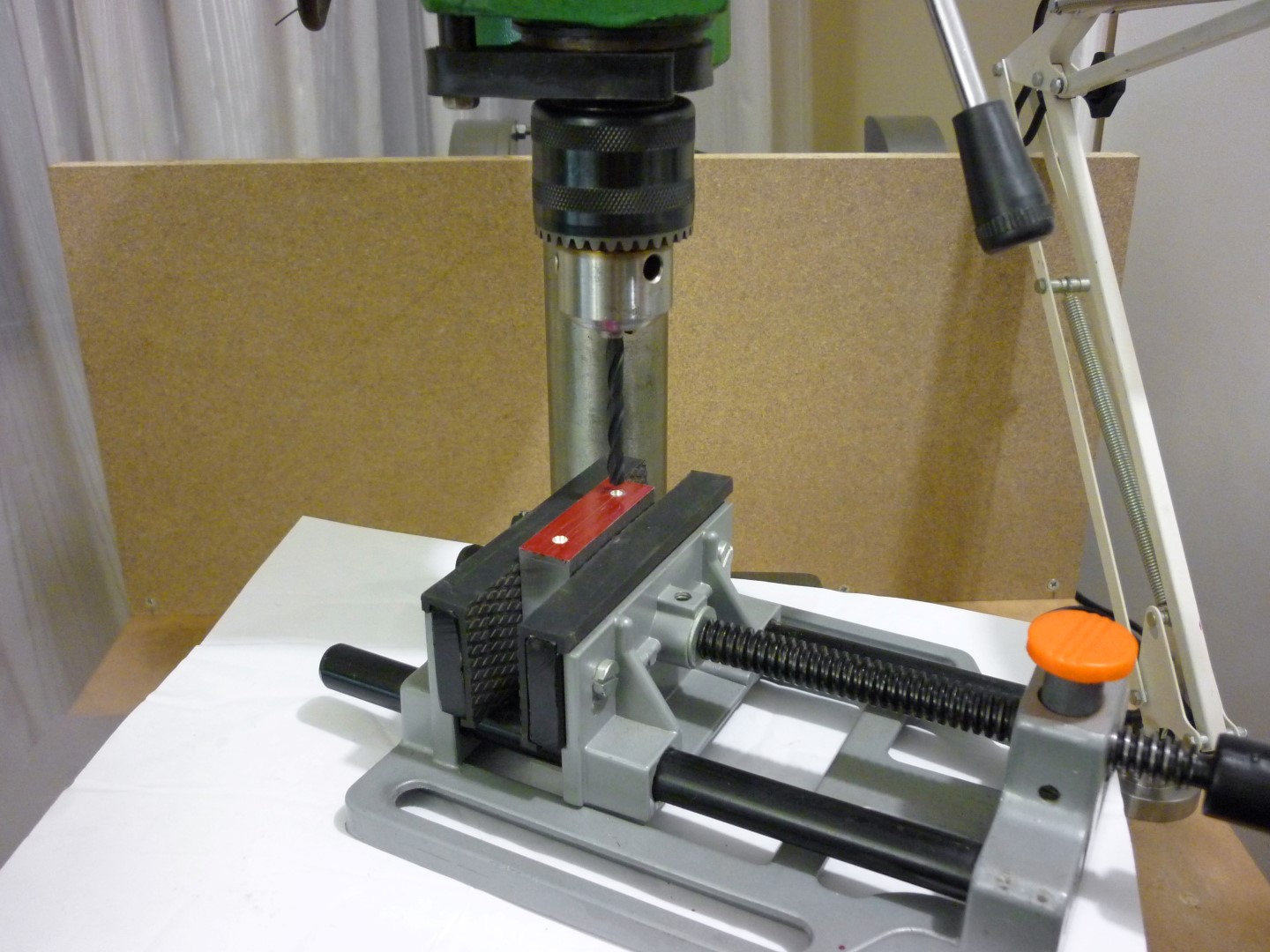

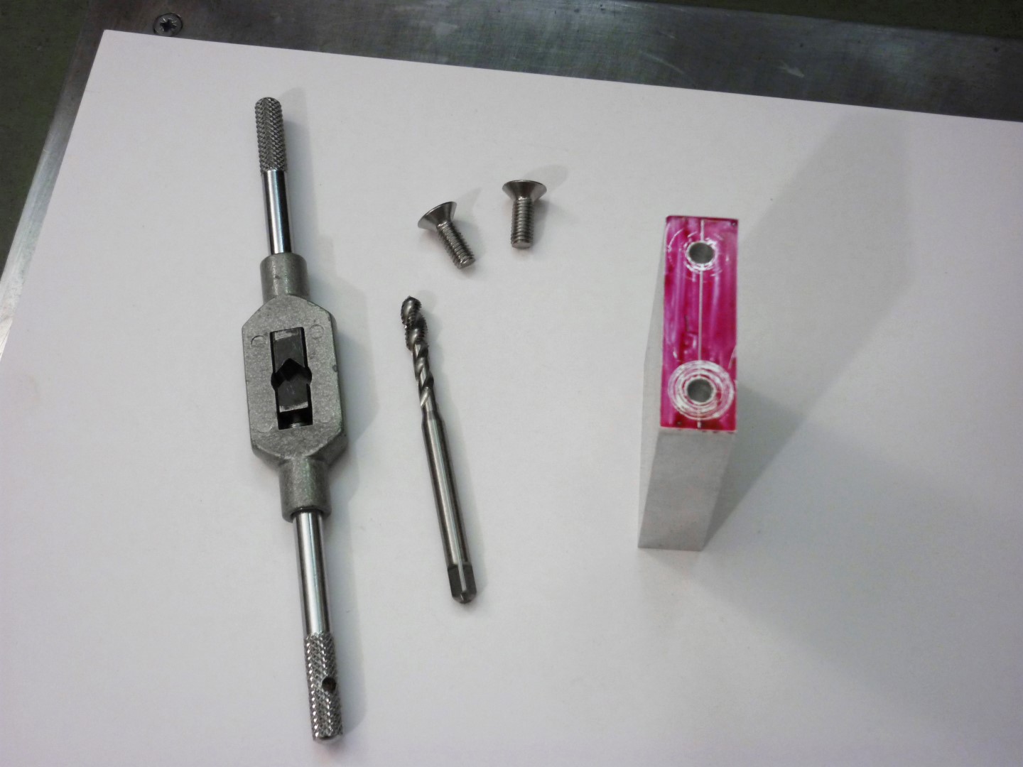

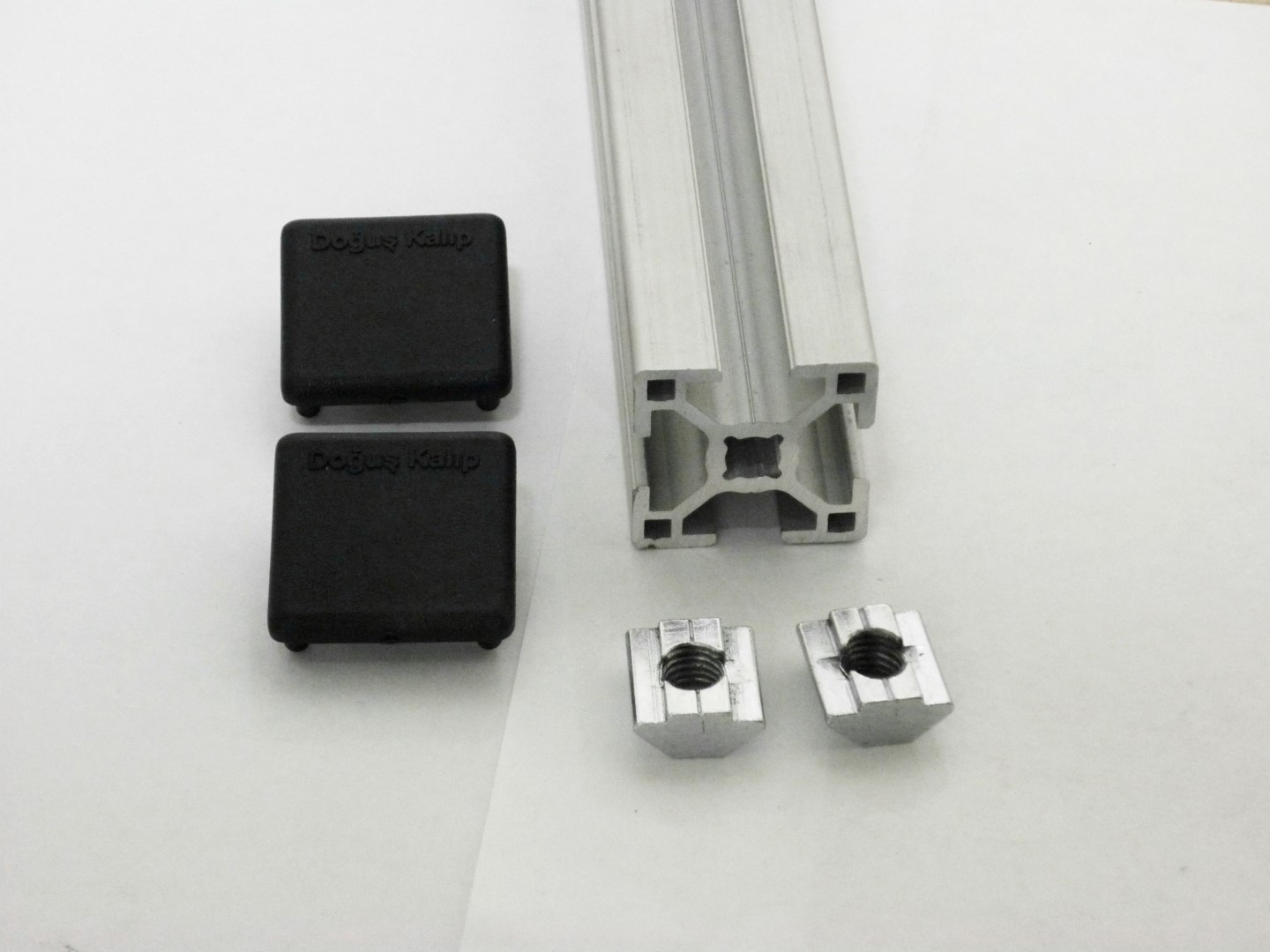

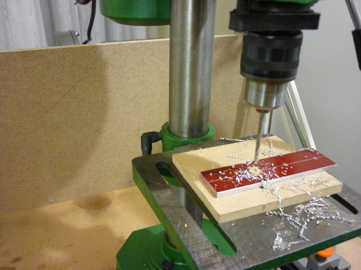

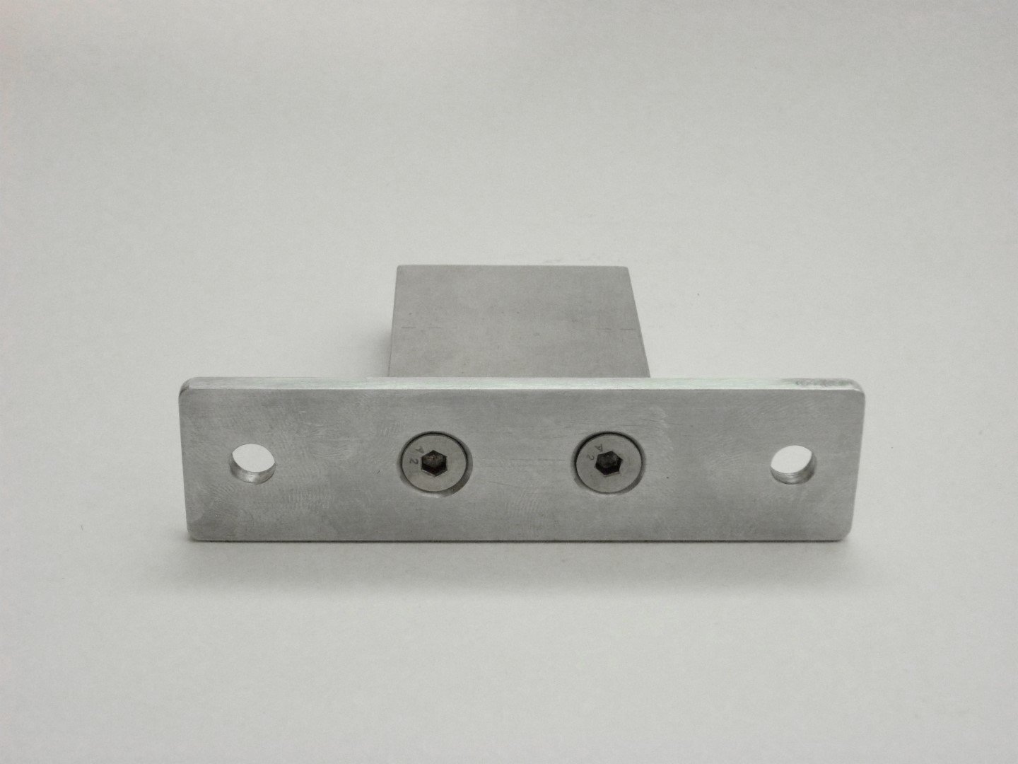

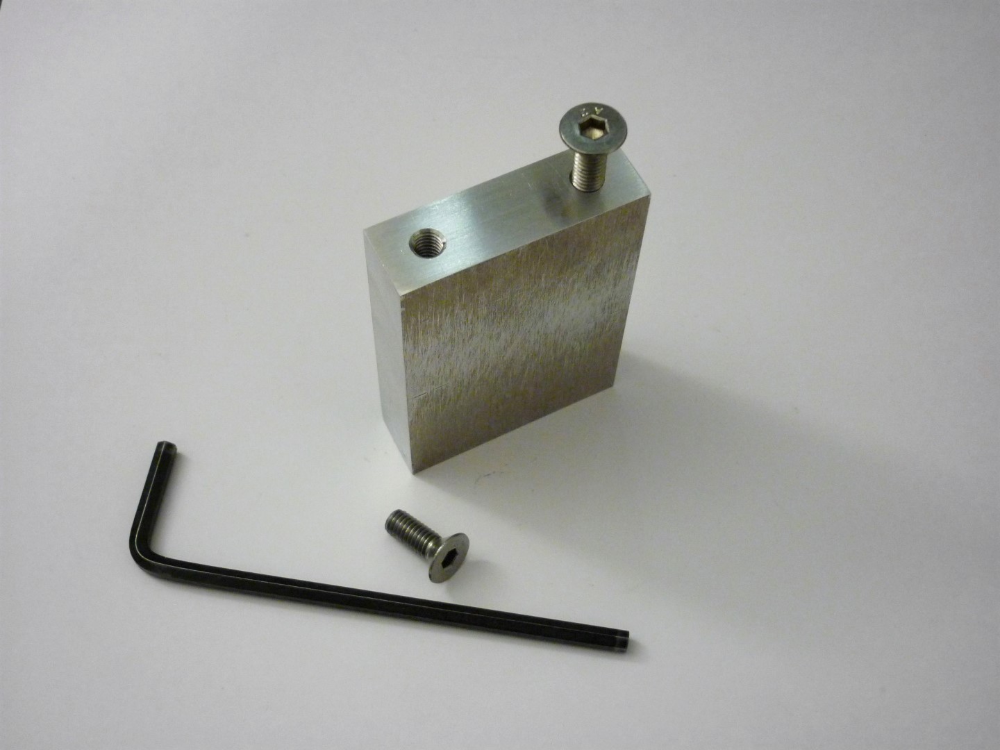

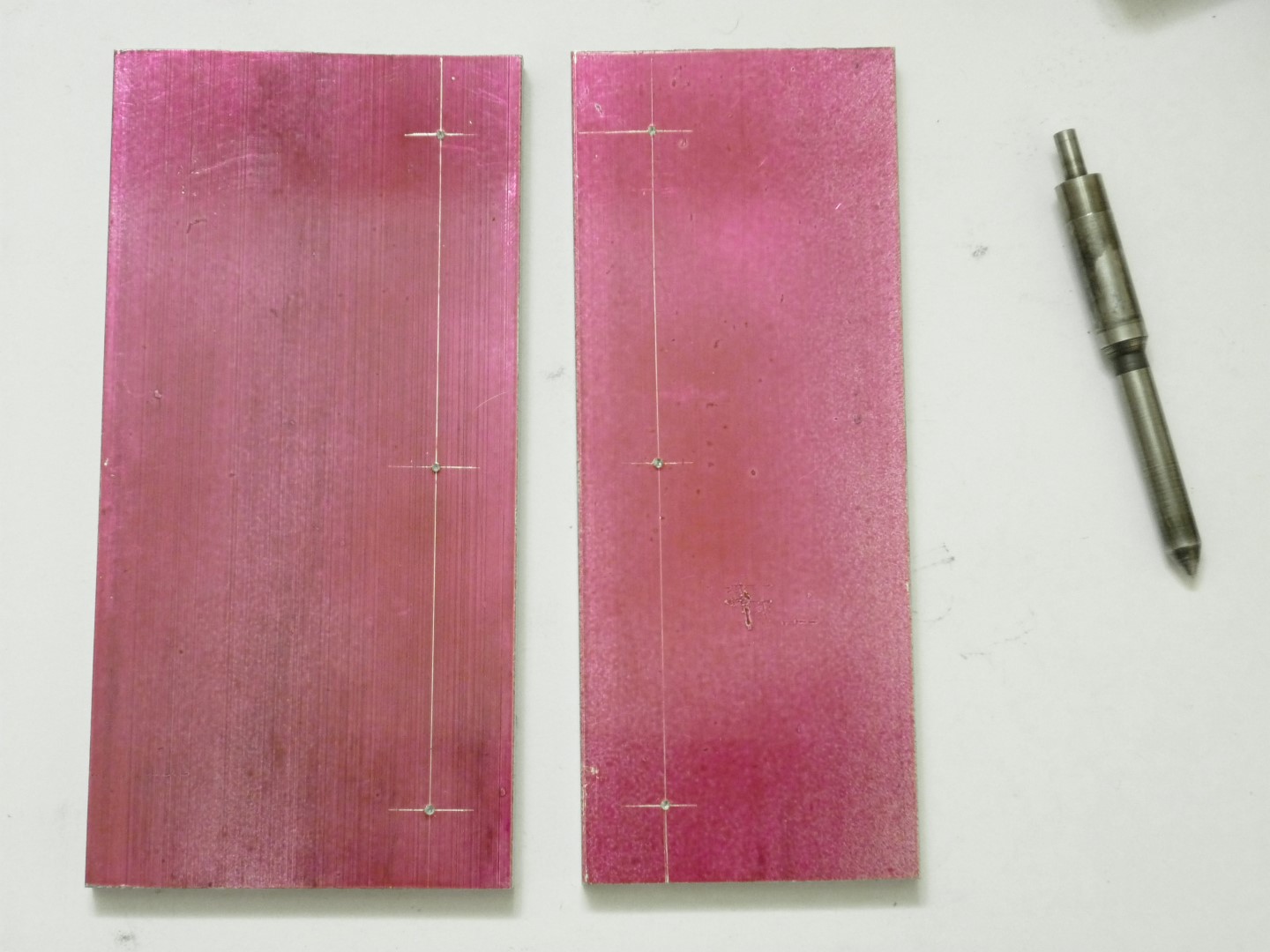

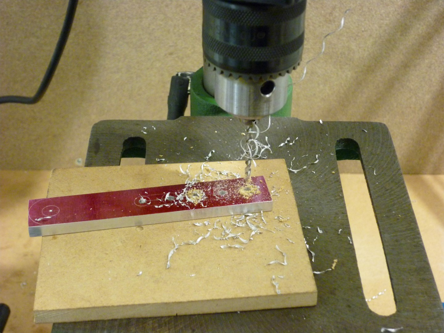

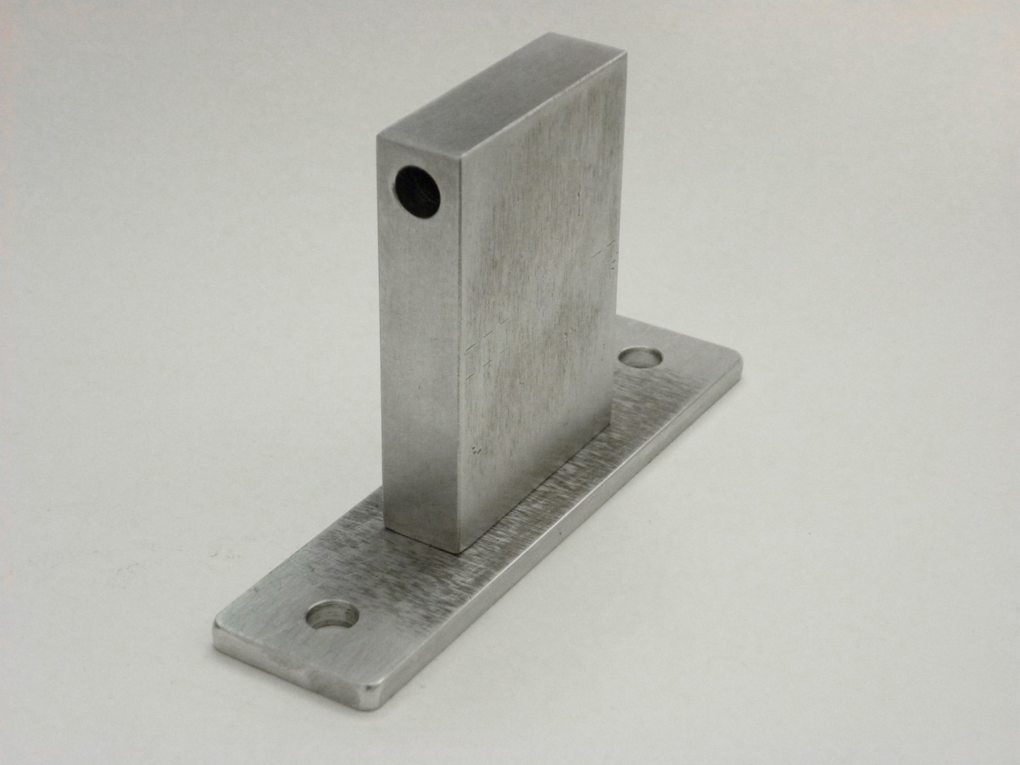

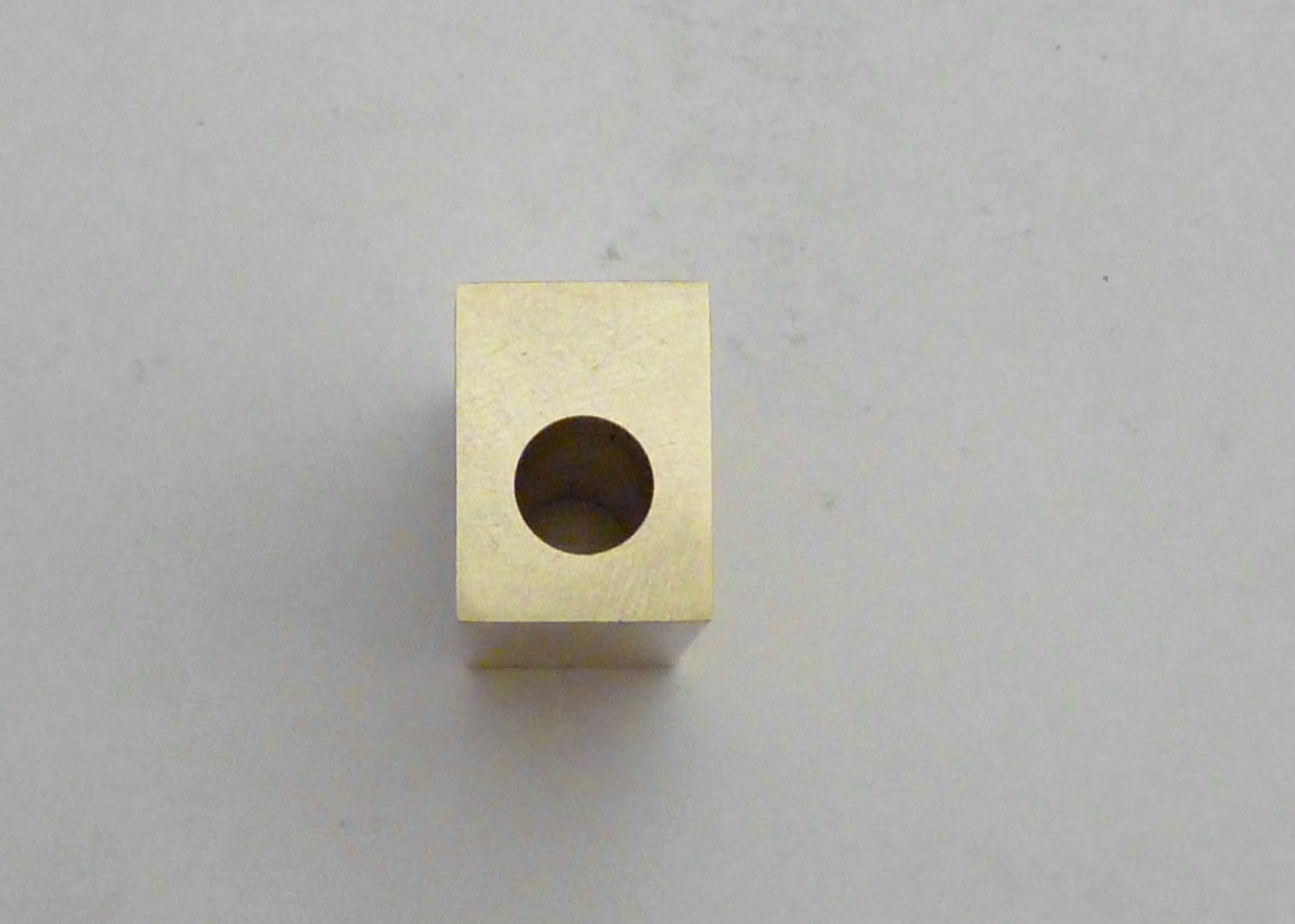

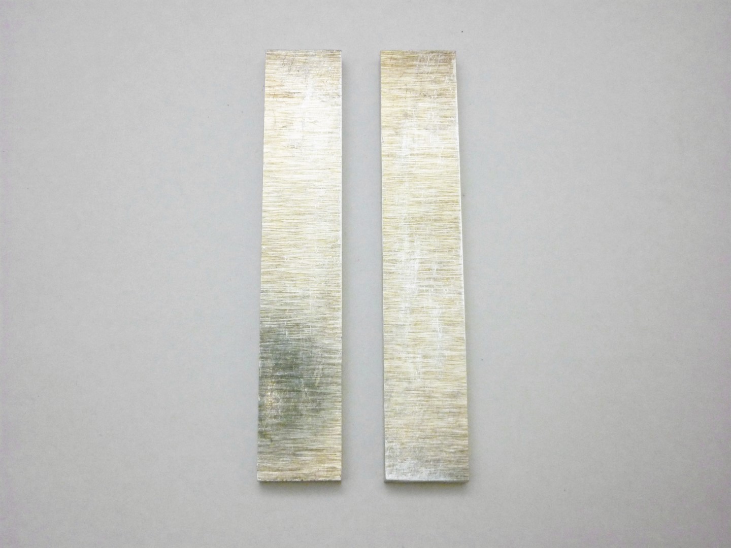

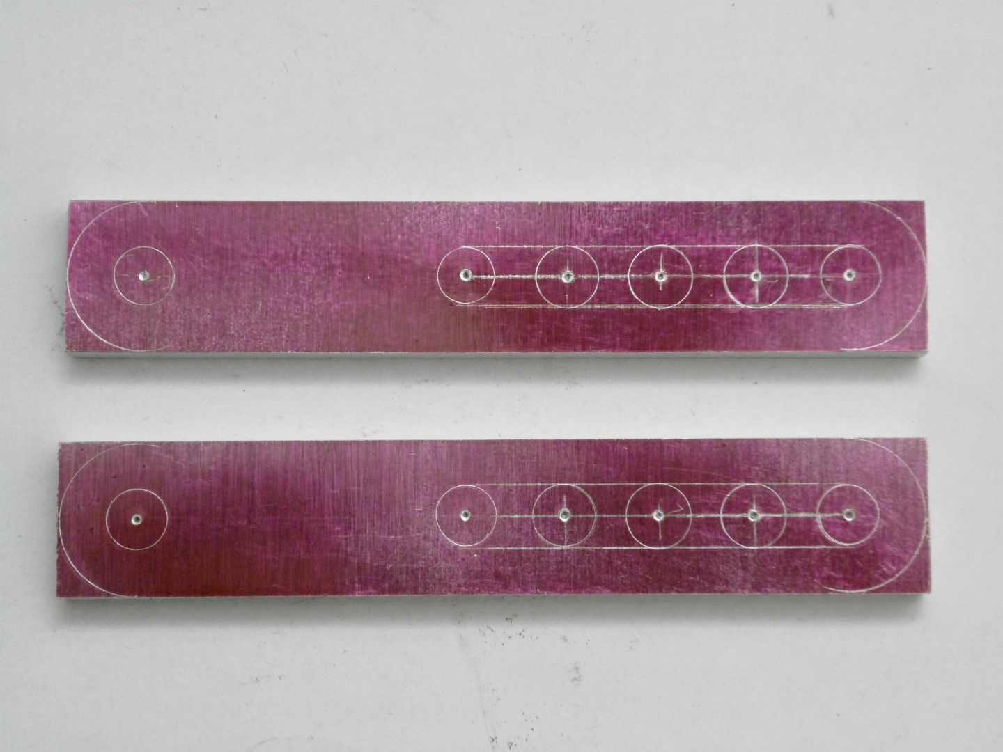

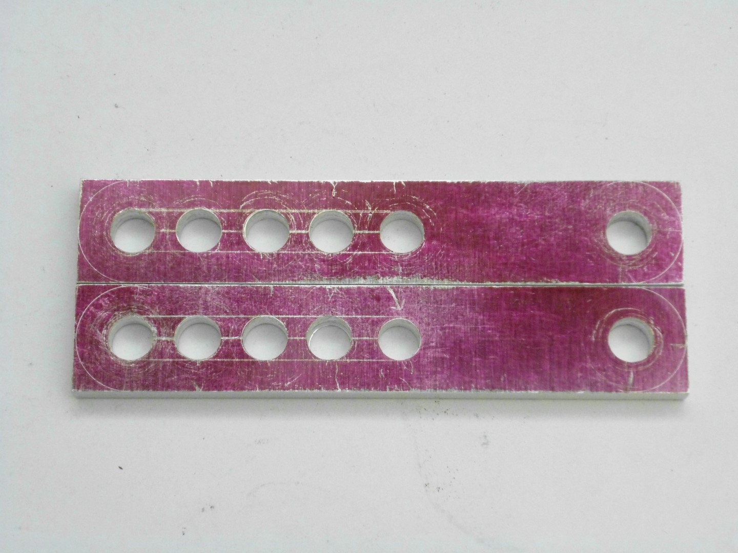

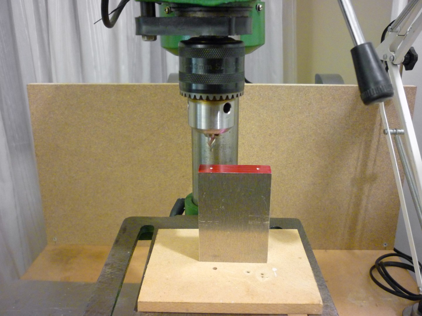

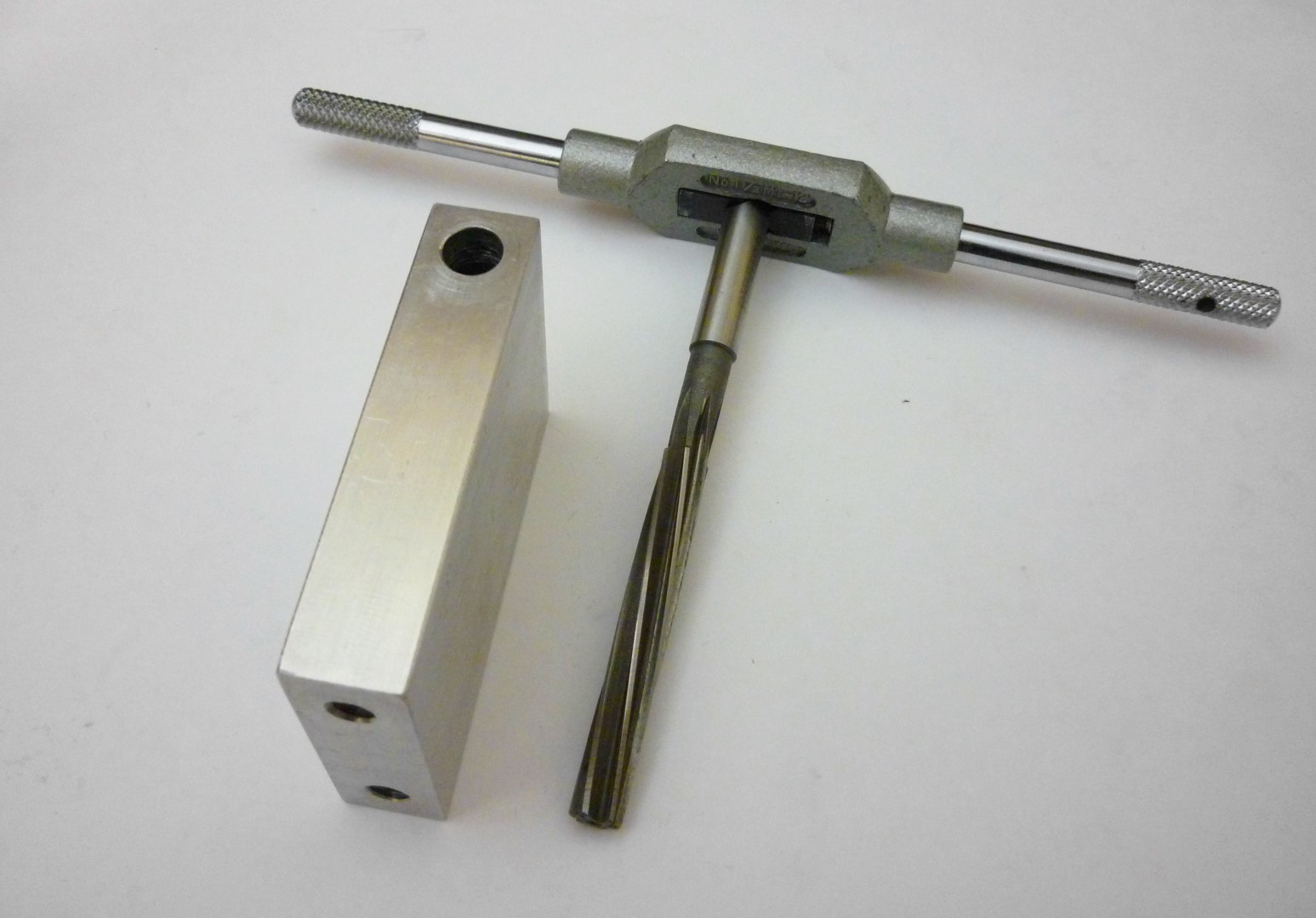

Making the main body and the arms
Attachment 26537 Attachment 26538 Attachment 26539 Attachment 26540 Attachment 26541 Attachment 26542 Attachment 26543 Attachment 26544 Attachment 26545 Attachment 26546 Attachment 26547 Attachment 26548 Attachment 26549 Attachment 26550 Attachment 26551 Attachment 26552 Attachment 26553 Attachment 26554 Attachment 26555 Attachment 26556 Attachment 26557
https://www.youtube.com/watch?v=tp55y0WC-Hk&t=232s

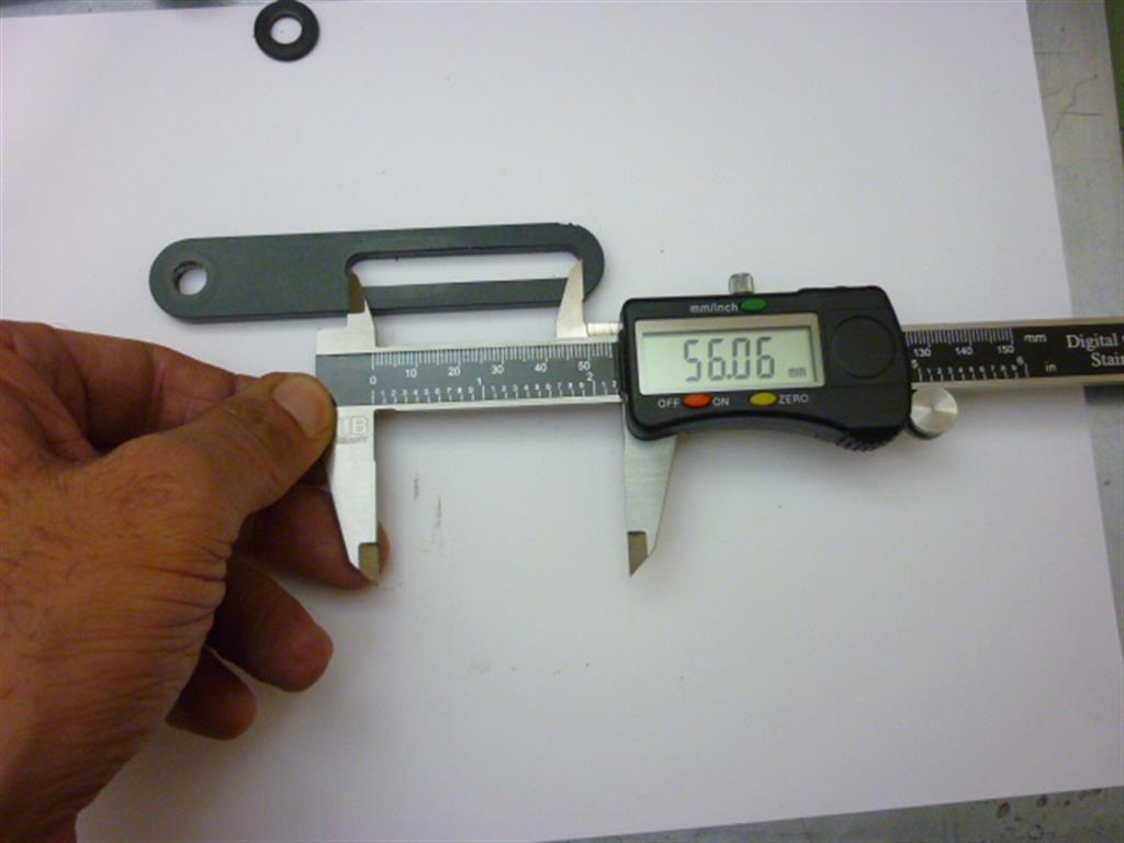

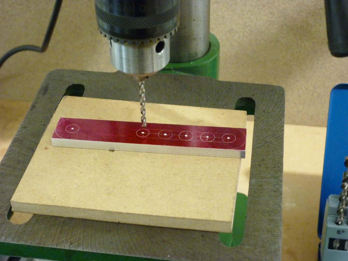

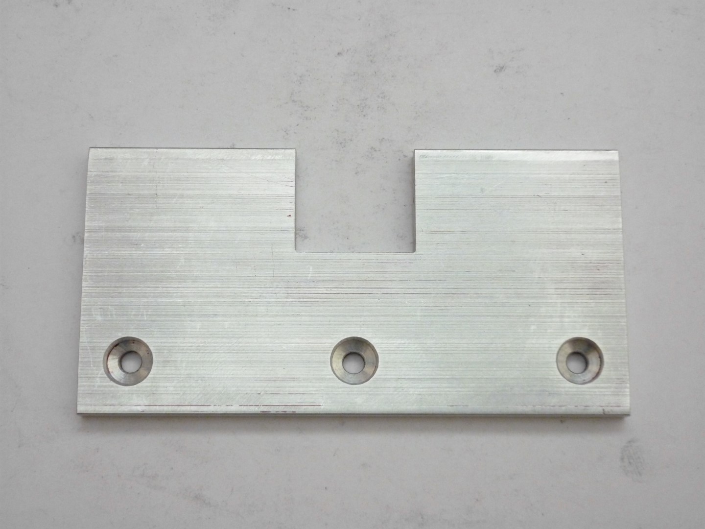

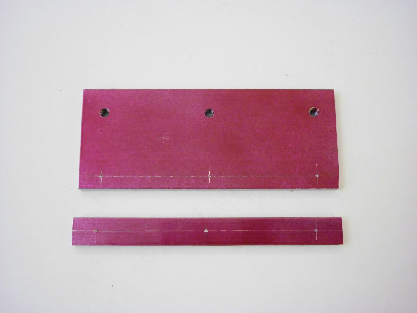

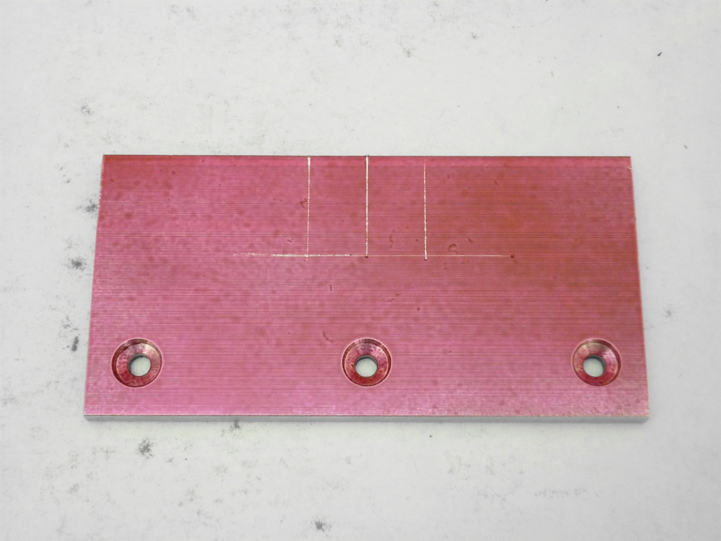

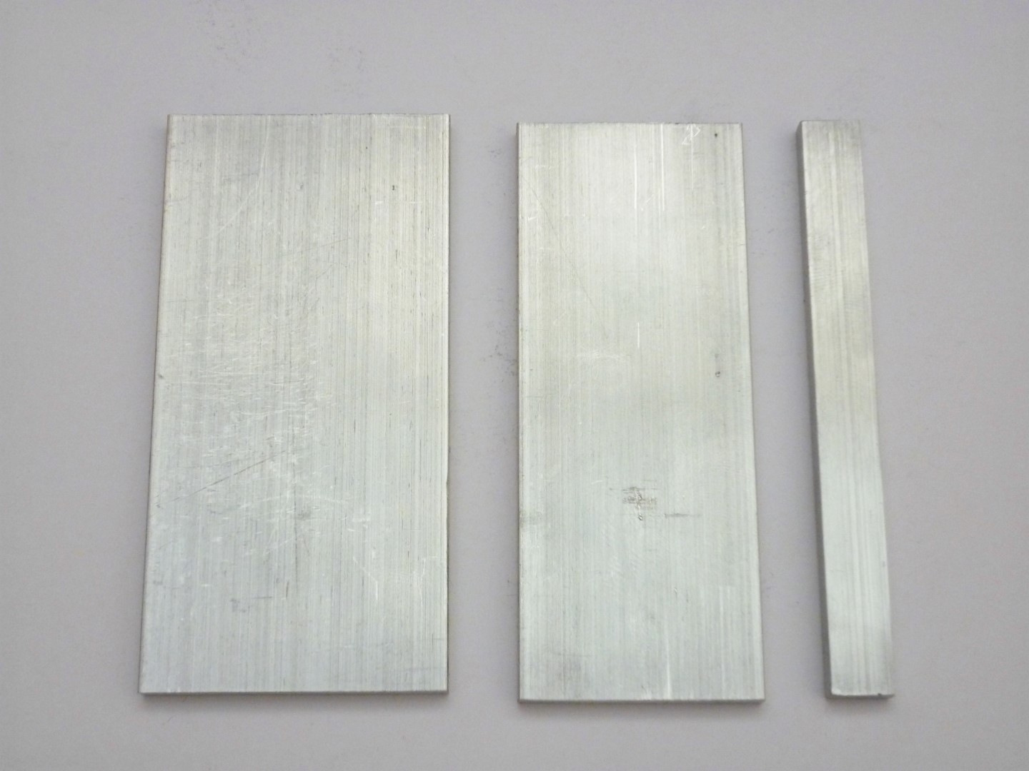

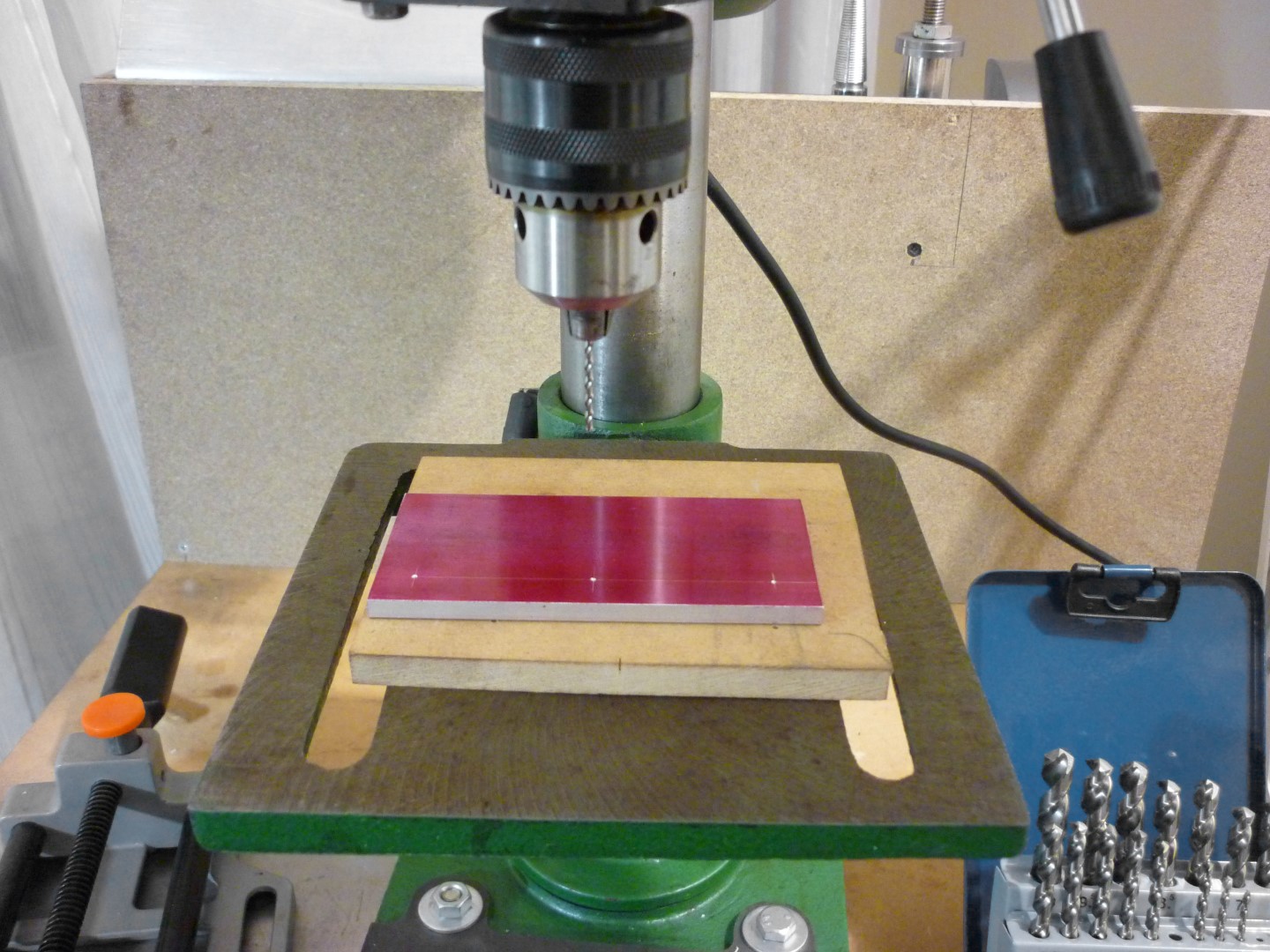

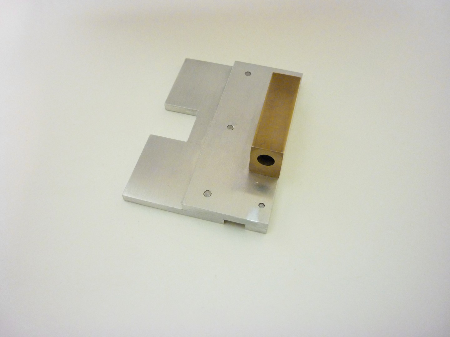

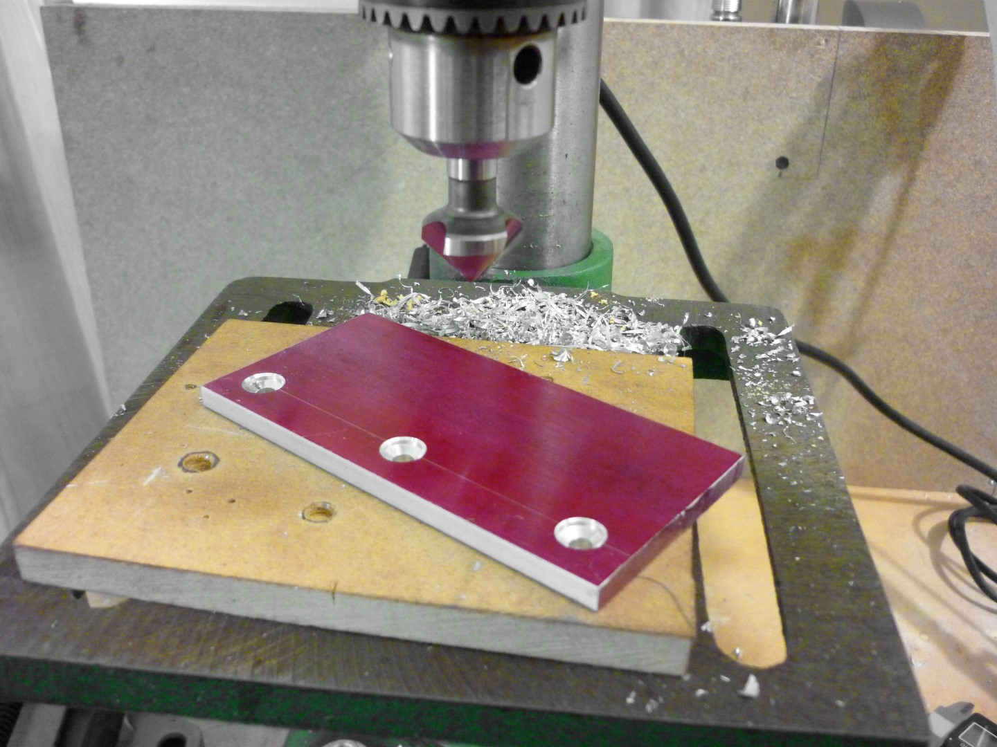

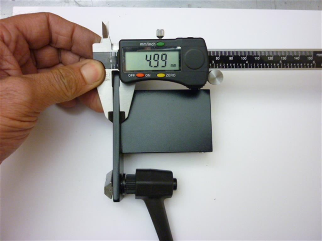

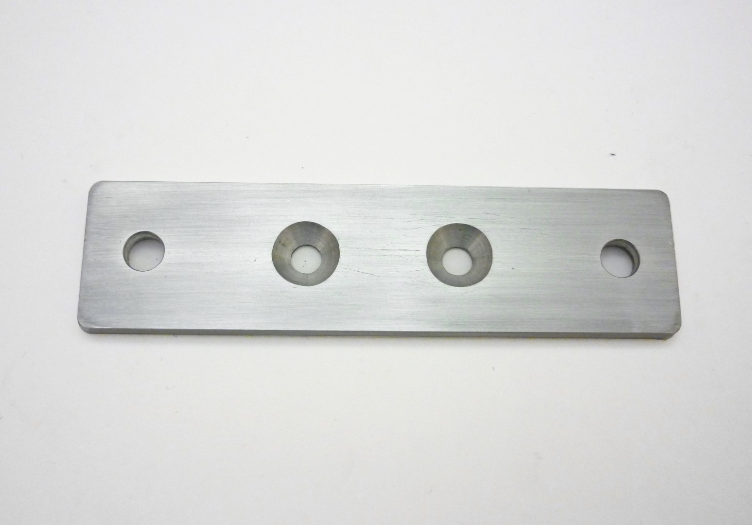

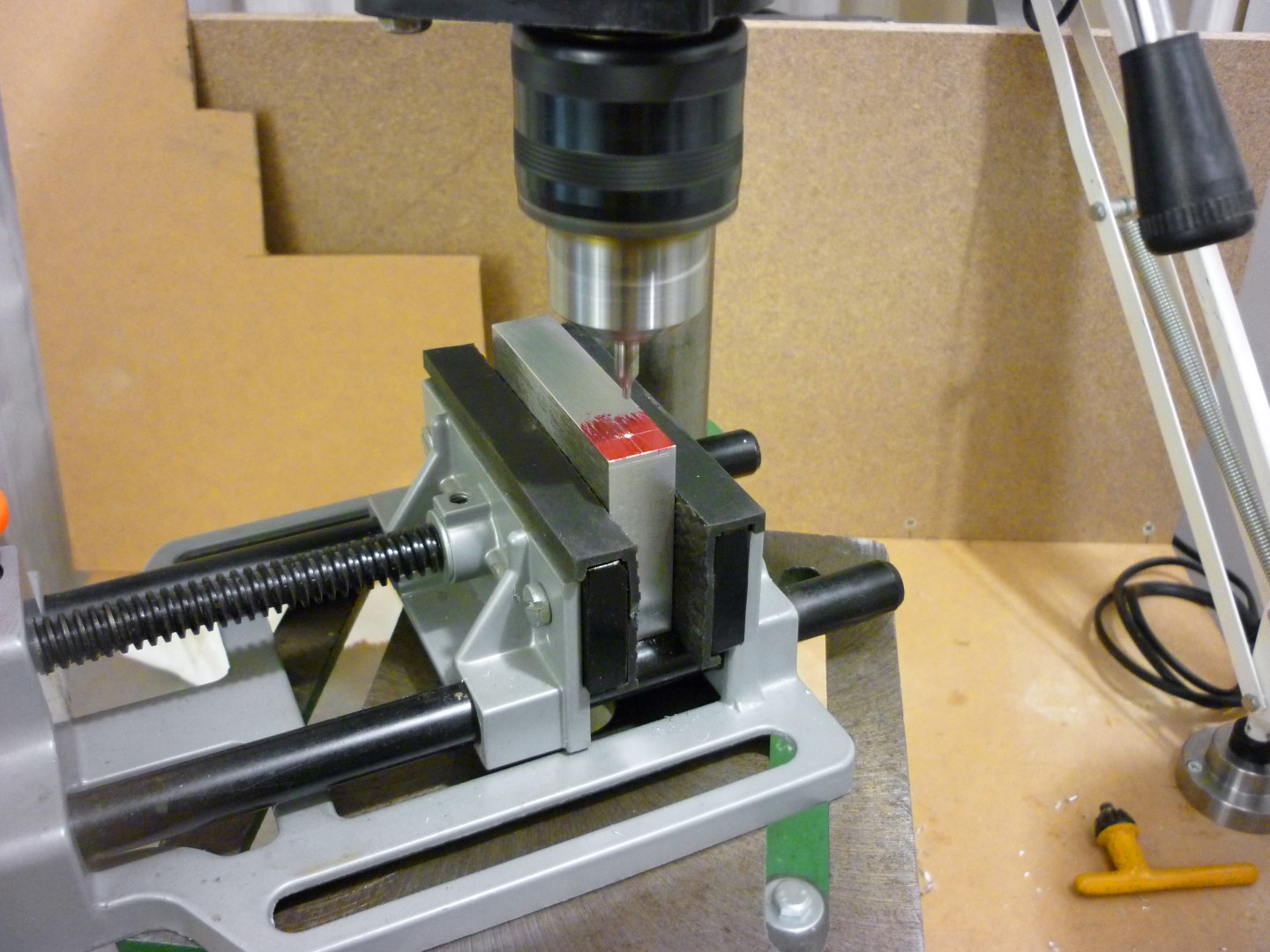

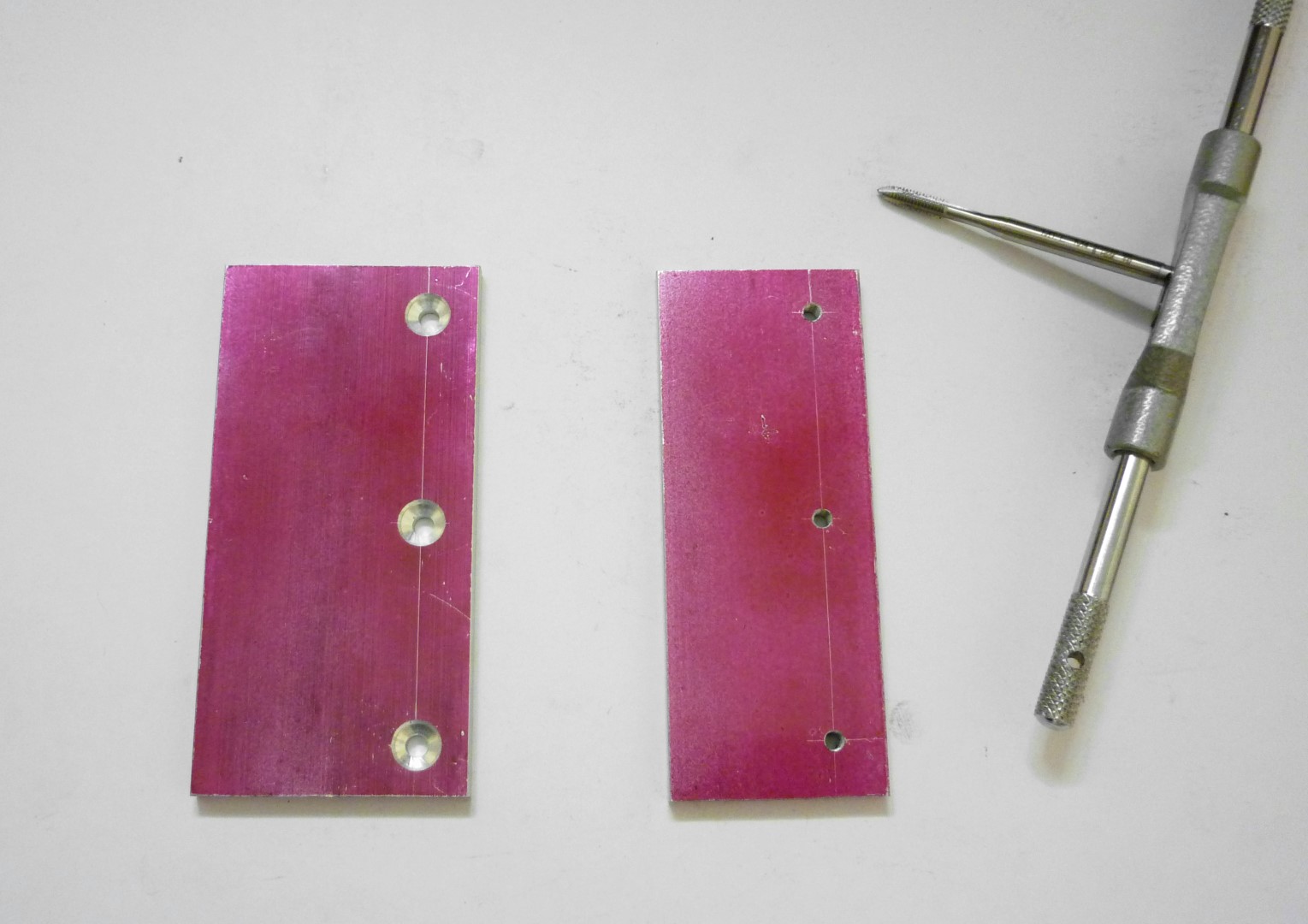

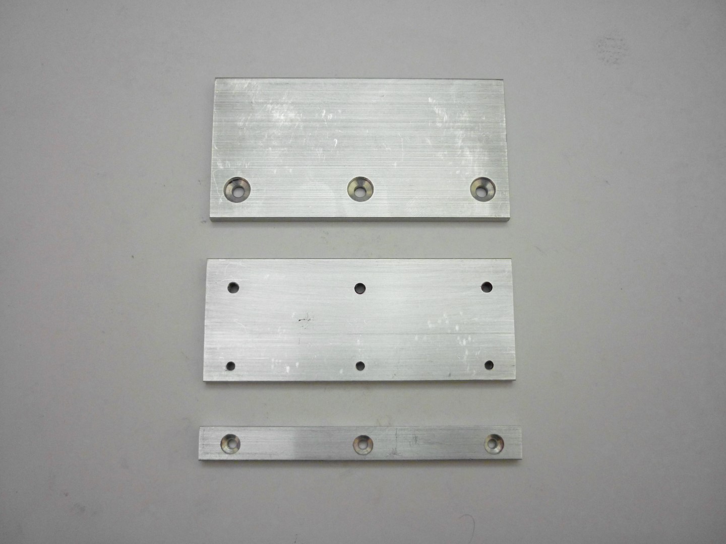

Making the tool rest plate
Attachment 26558 Attachment 26559 Attachment 26560 Attachment 26561 Attachment 26562 Attachment 26563 Attachment 26564 Attachment 26565 Attachment 26566 Attachment 26567 Attachment 26568 Attachment 26569 Attachment 26570 Attachment 26571 Attachment 26572 Attachment 26573 Attachment 26574 Attachment 26575 Attachment 26576 Attachment 26577 Attachment 26578
https://www.youtube.com/watch?v=0I3u0BW-TTU

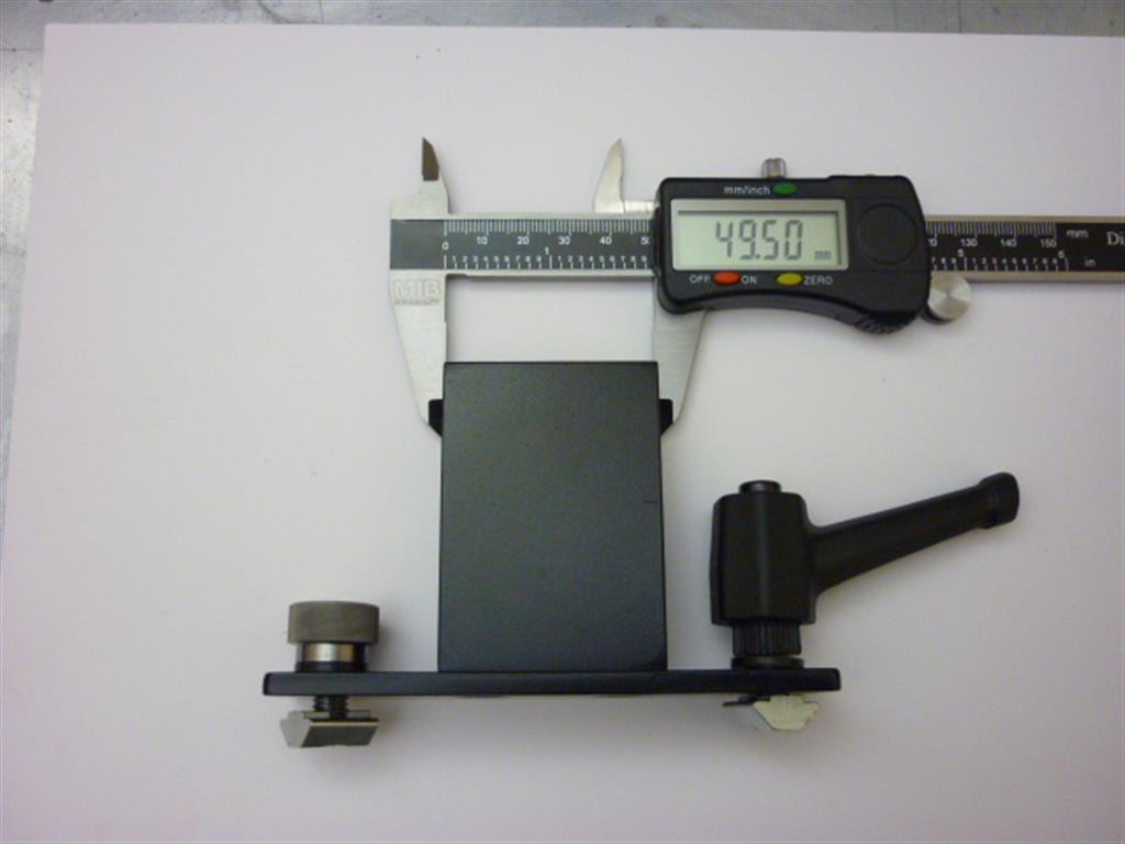

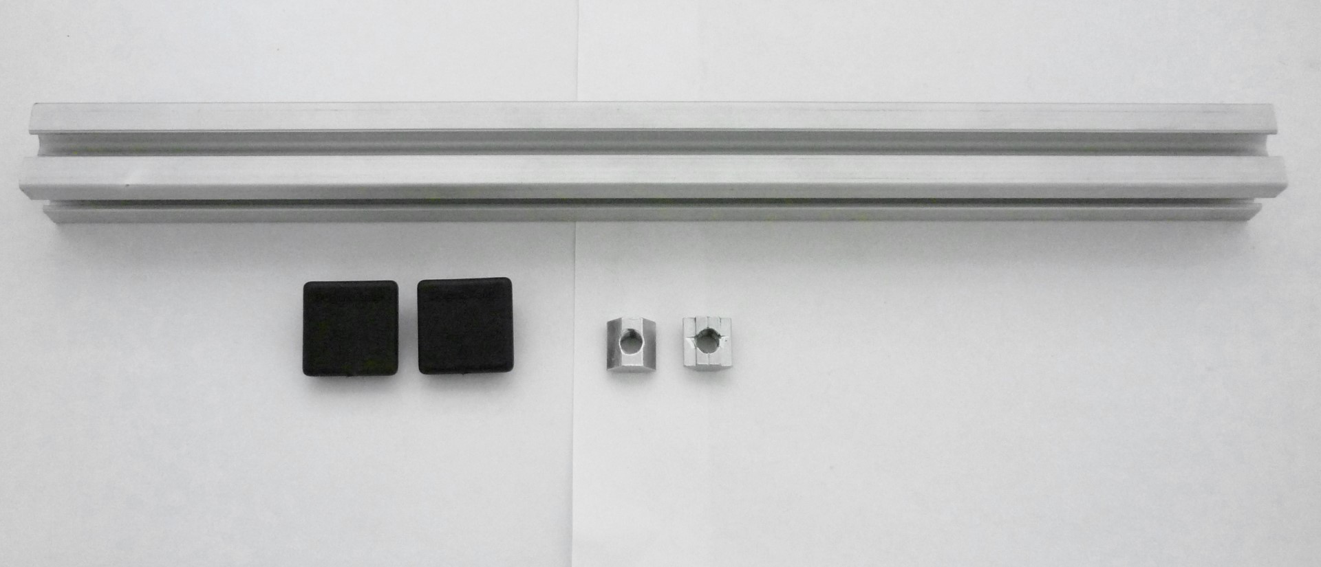

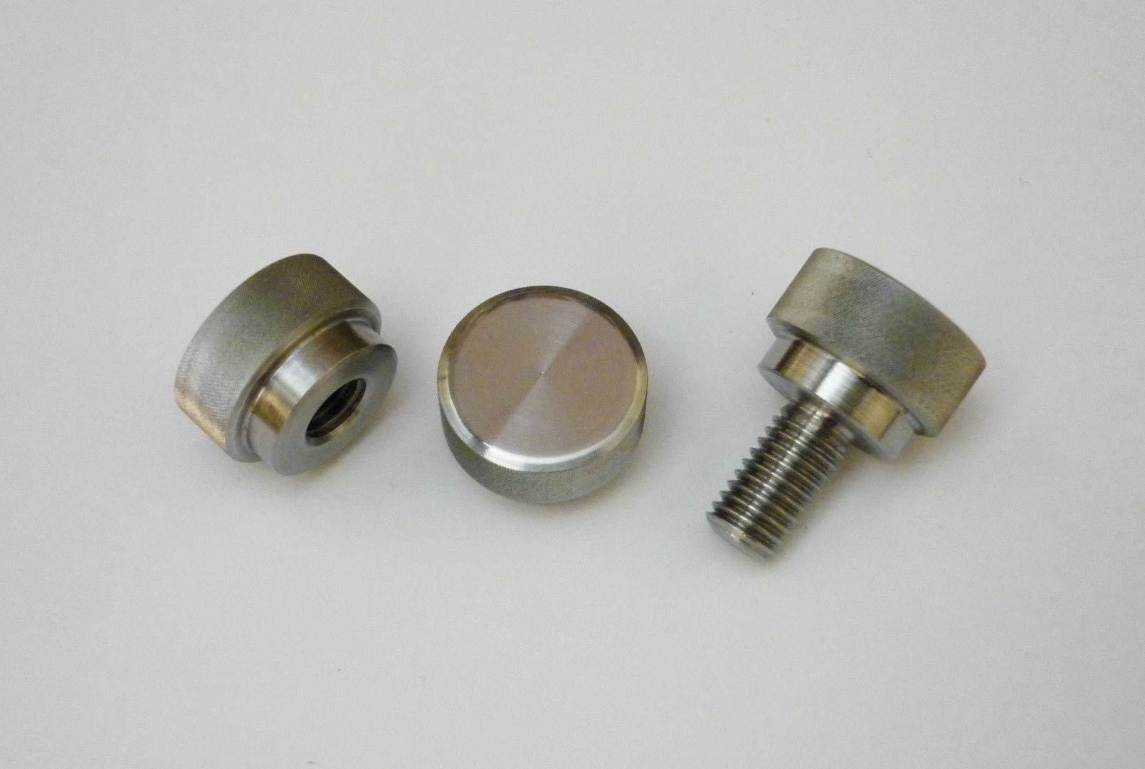

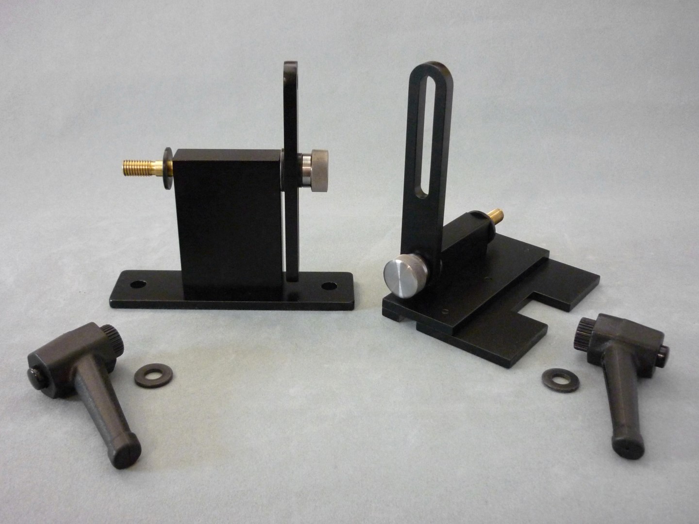

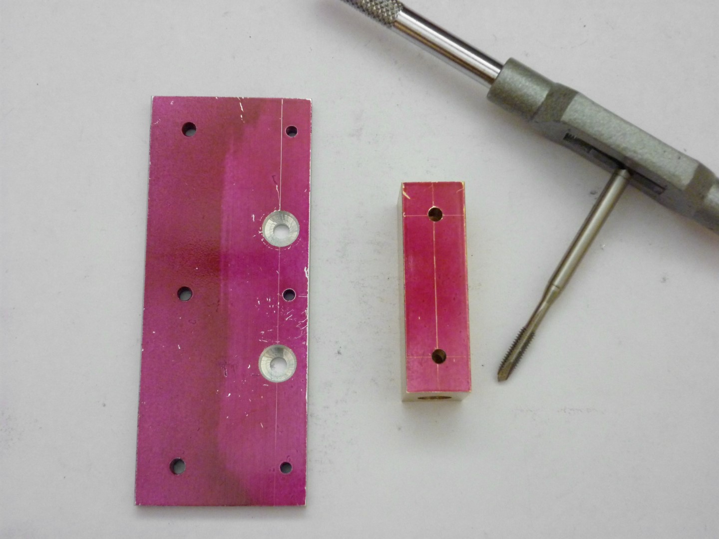

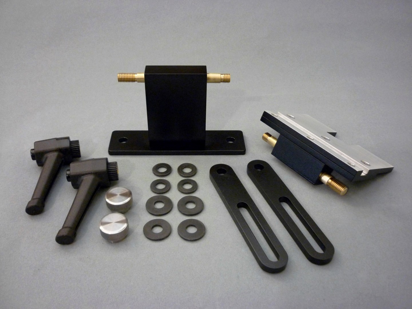

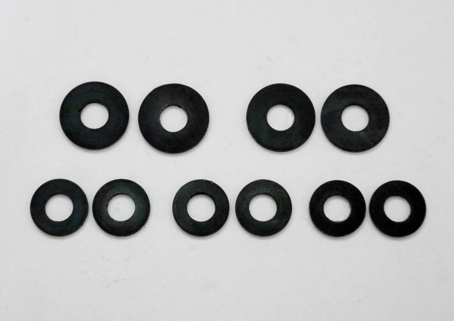

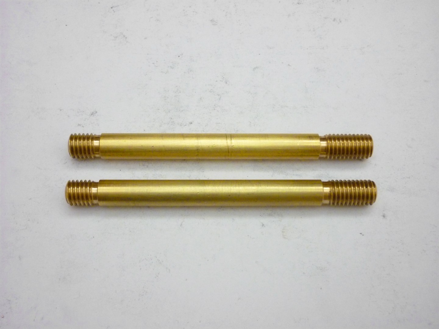

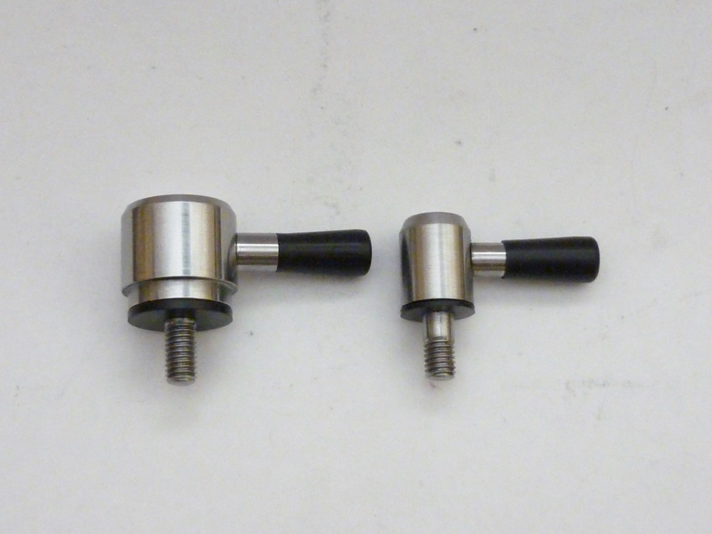

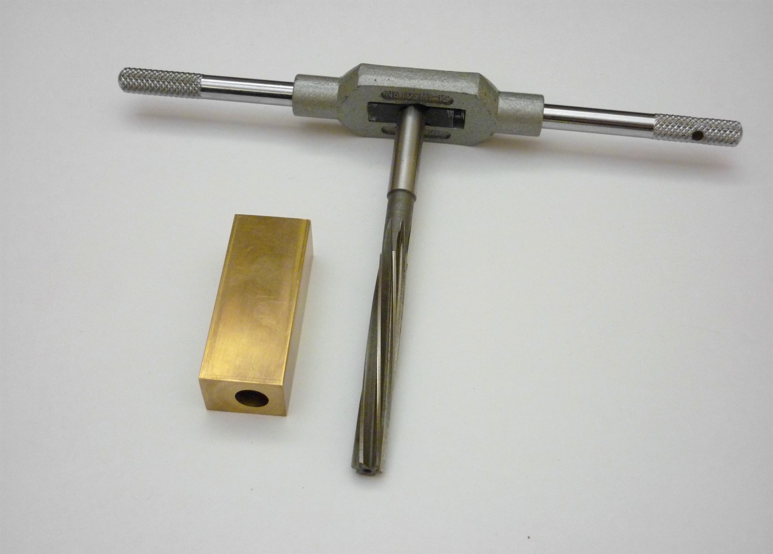

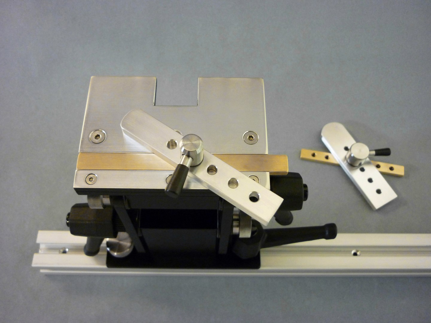

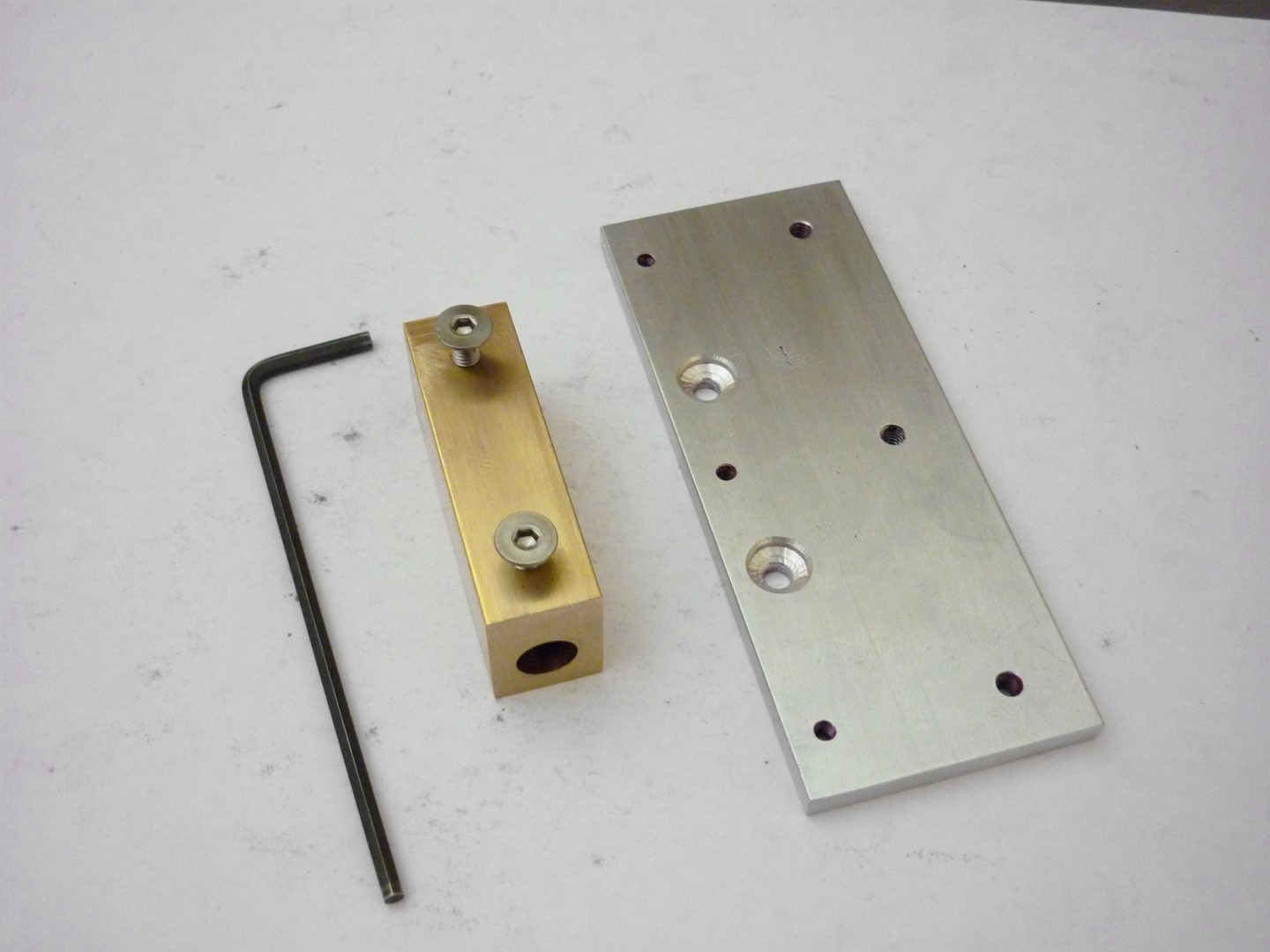

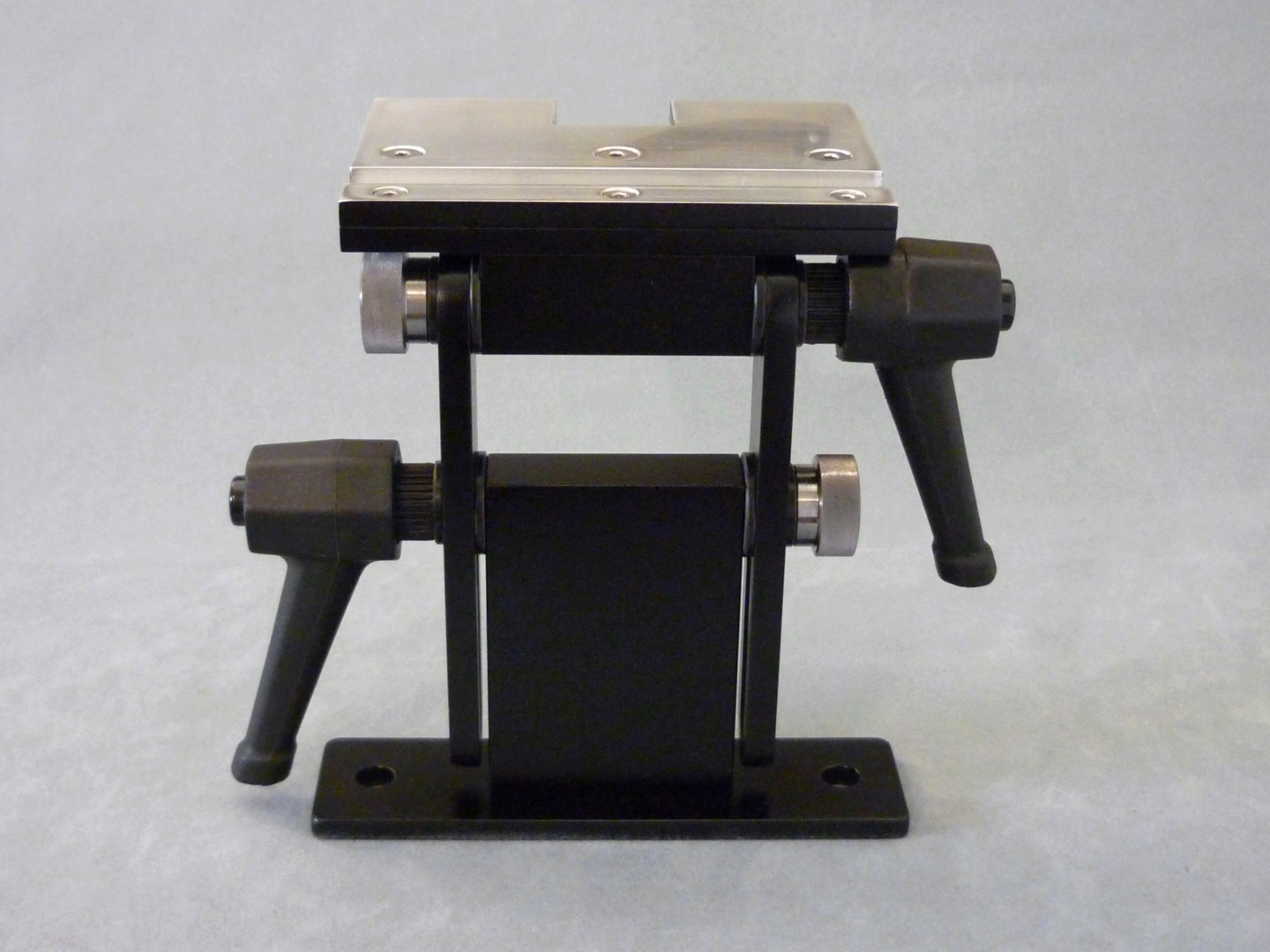

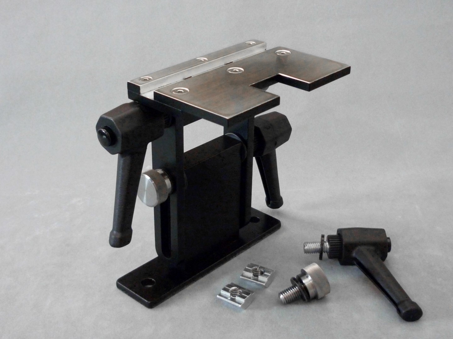

Making all the small parts and final assembling
Attachment 26579 Attachment 26580 Attachment 26581 Attachment 26582 Attachment 26583 Attachment 26584 Attachment 26585 Attachment 26586 Attachment 26587 Attachment 26588 Attachment 26589 Attachment 26590 Attachment 26591 Attachment 26592 Attachment 26593 Attachment 26594 Attachment 26595

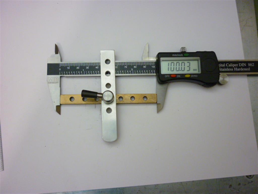

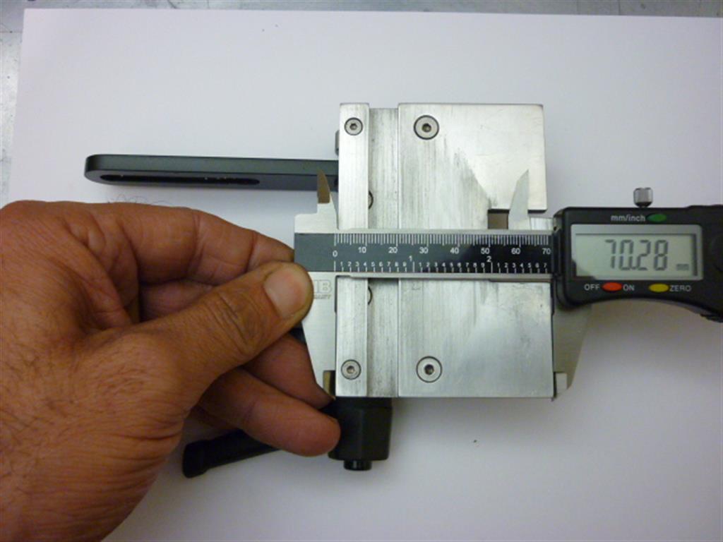

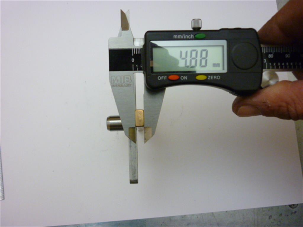

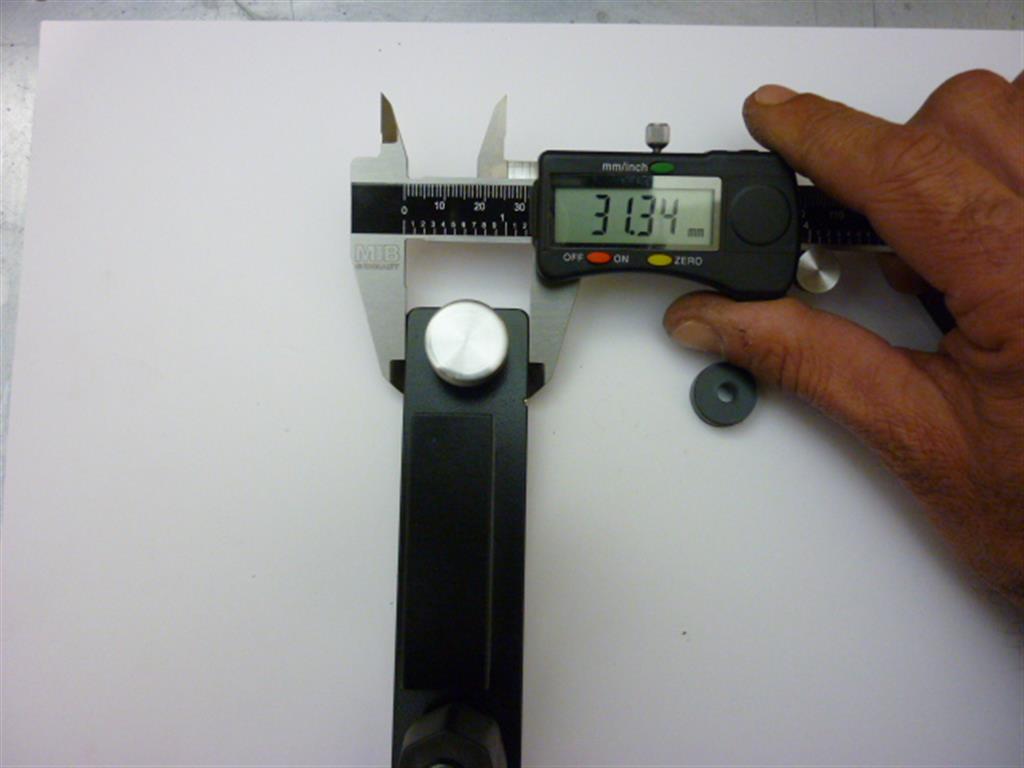

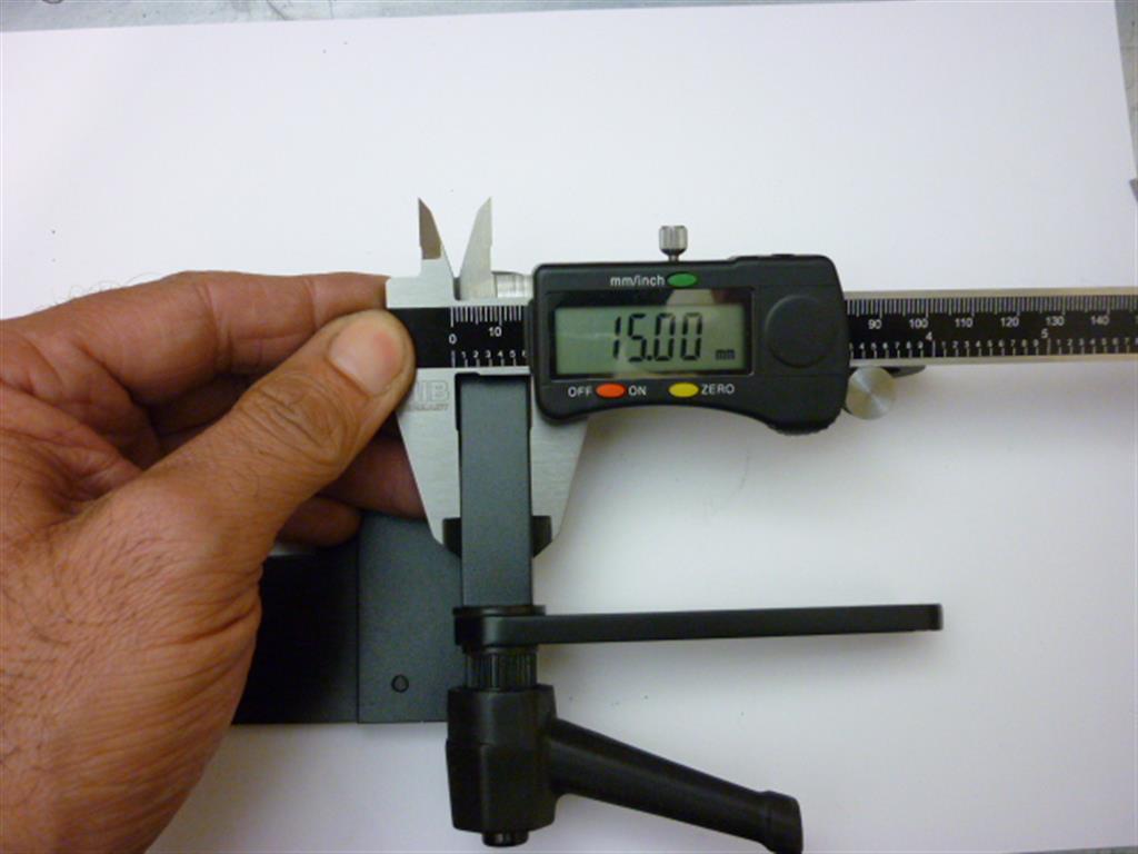

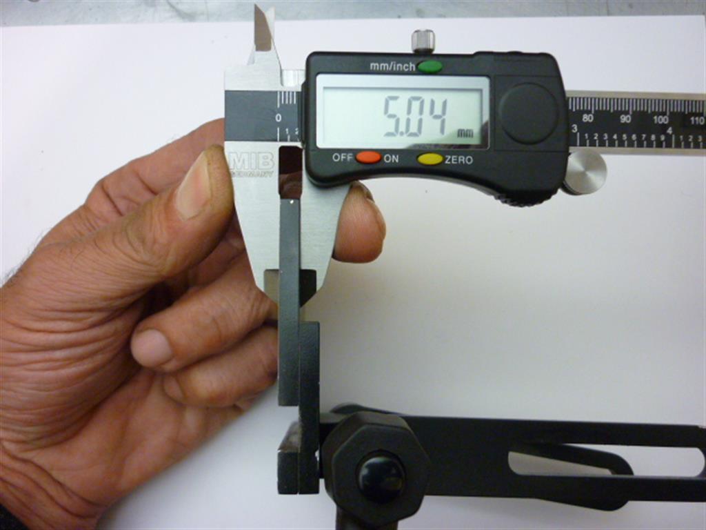

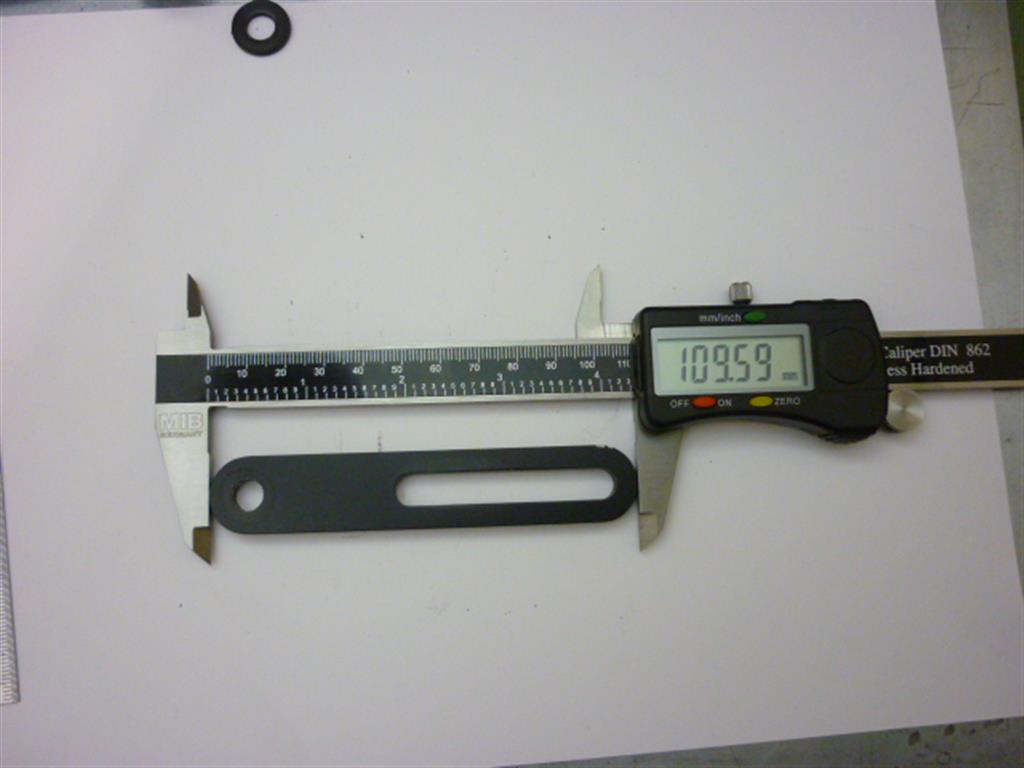

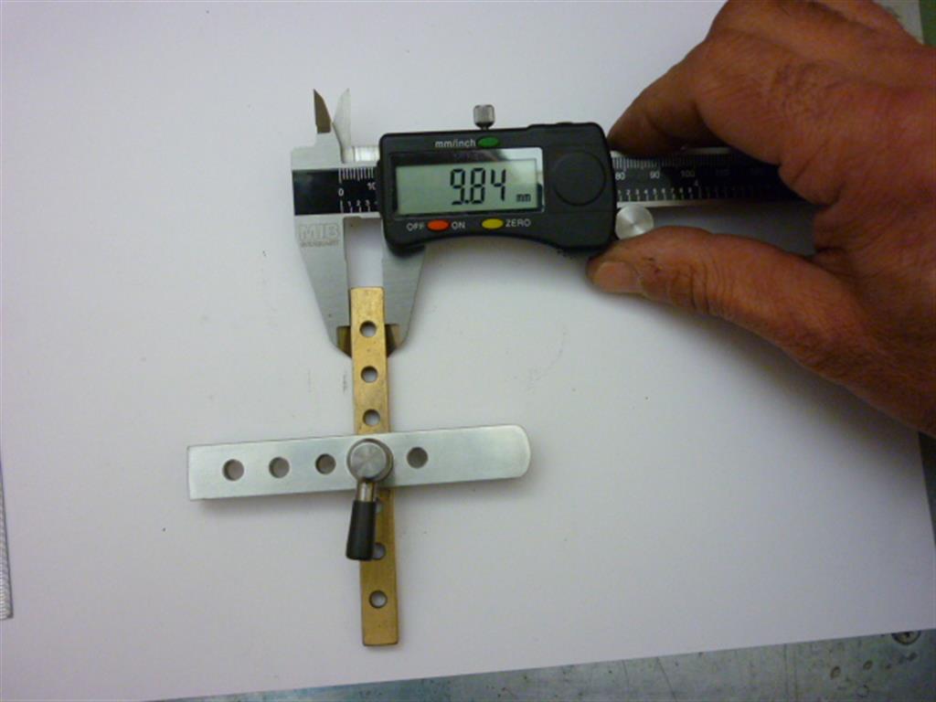

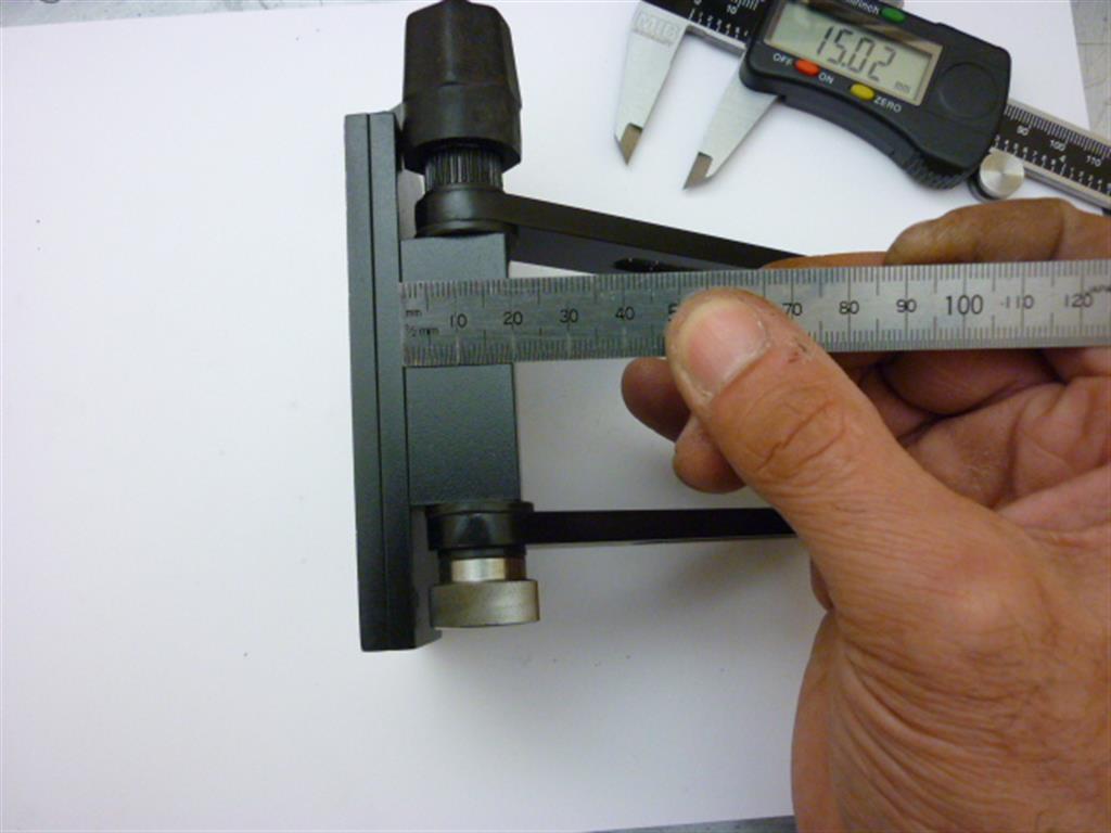

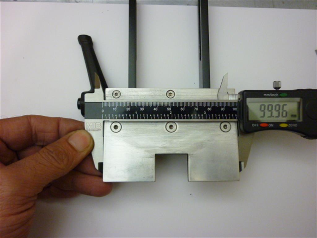

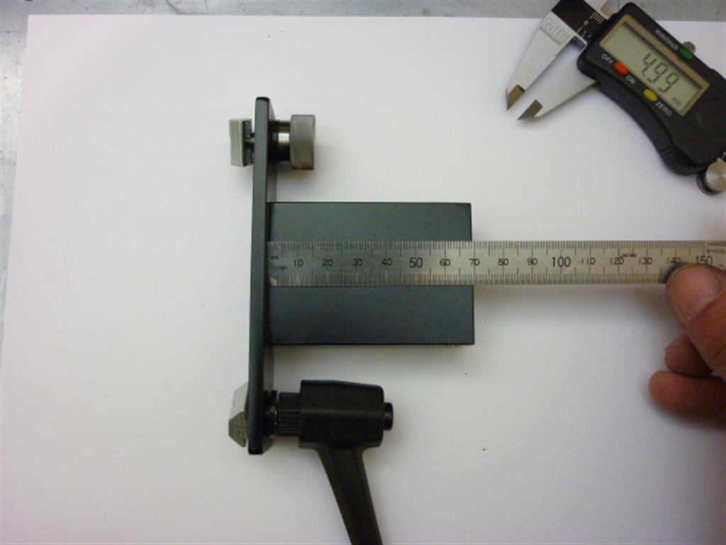

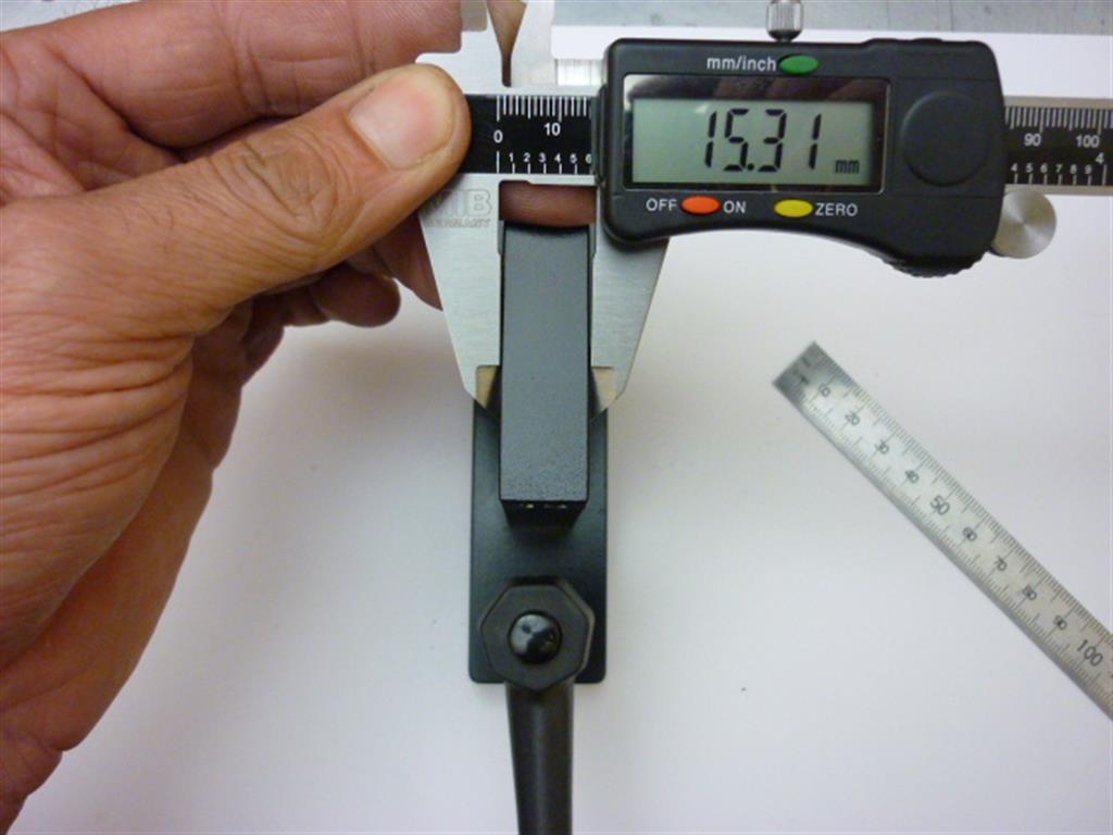

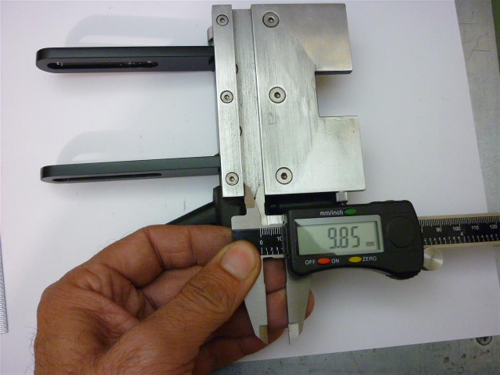

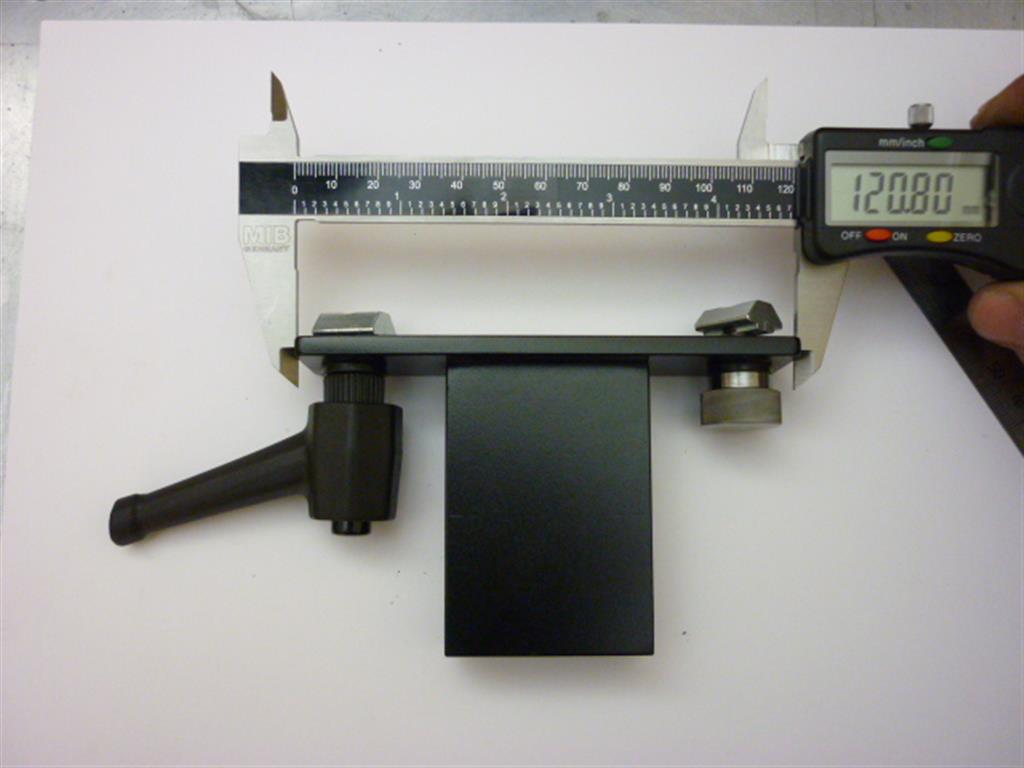

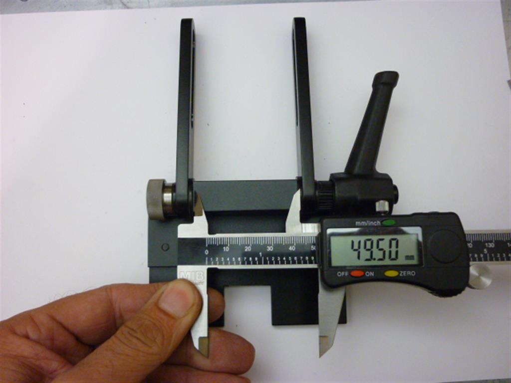

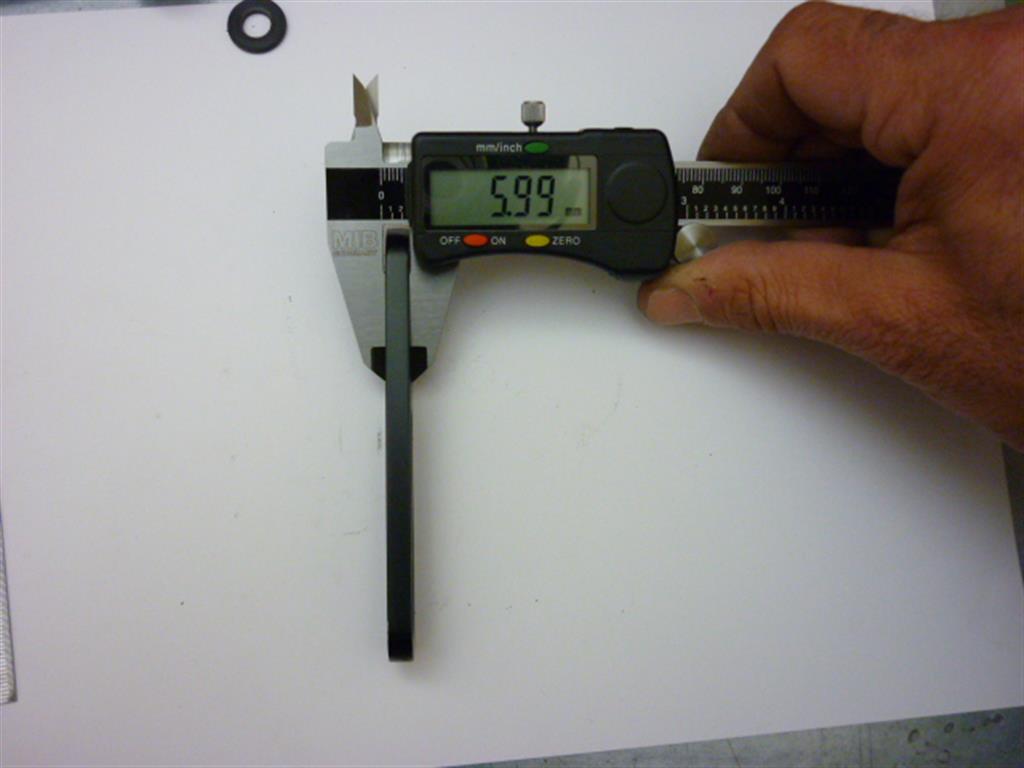

Now, if anyone wants to make this 'tool rest', here are some pictures with measurements (is in metric system, but you can easily convert it in inches).
I know that drawings would help a lot; unfortunately I don't have drawings, because I don’t know how to make them.
Best wishes
Dimitris
Attachment 26596 Attachment 26597 Attachment 26598 Attachment 26599 Attachment 26600 Attachment 26601 Attachment 26602 Attachment 26603 Attachment 26604 Attachment 26605 Attachment 26606 Attachment 26607 Attachment 26608 Attachment 26609 Attachment 26610 Attachment 26611 Attachment 26612 Attachment 26613 Attachment 26614 Attachment 26615
