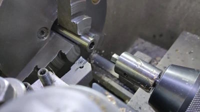

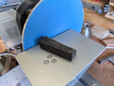

This is my home-made smoothing plane, made out of beech, bog oak, brass, steel and stainless steel. I made it mainly because I thought it would be an interesting project but also because I wanted to try out an idea I'd had for a plane that could be used in either a bevel-up or bevel-down configuration.

The only parts you can see in that image that I didn't make were the shorter two screws (the one near the front knob which holds the knob in place and the one on the far right which holds the blade to the cap iron).
