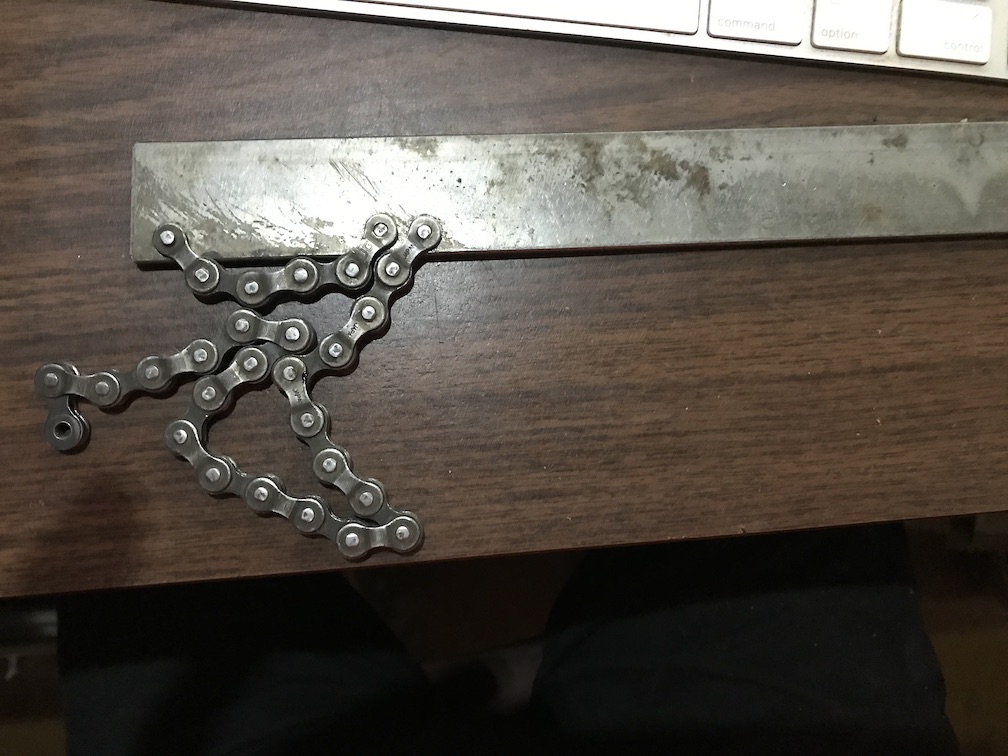

    They look expensive! Chain type oil filter wrenches do the same job even if the links don't match.

    Piece of steel bar(~12" long) an old bicycle chain and some time with a chain tool. I didn't make this one, but it's done me well for years:
    Those pliers look like Park Tool colors, big bicycle too company...

    Spot on, Bruce...and $80 US! My bar tool is just like yours and always worked just fine in my bike mechanic days in the mid 70s...now, I've become the de facto neighbourhood Mr Fixit for kids bikes...still enjoy it, too...cheers
