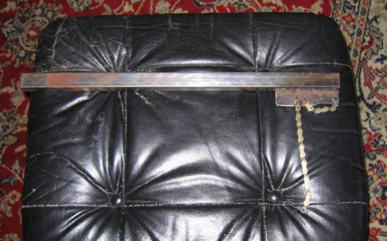

Attachment 244this is used to remove threaded cogs on fixed gear/track bike wheels, welded it together and it has never failed to loosen even the most recalcitrant cog ;-) Chain whips are also need on multi gear bikes to prevent the cassette from spinning when removing the lockring
