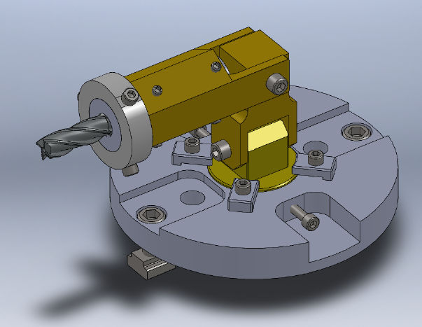

Bill Redd - Simplified Mill/Drill Sharpener Jig for Vertical End Mill operation
http://www.homemadetools.net/forum/i...es/hat_tip.gifAttachment 2740 I liked the sharpening jigs I down loaded, and I Plan to build a Bonelle that was posted. I designed a simplified jig system to use on a vertical mill for both mills and drills. 3 configurations are provided, project was uploaded as a ZIP, 3 Solidworks EA and 4 PDF files. Other tools can be sharpened if the builder makes adapters for them. A "quill" would have to be built by the user for individual model vertical end mills for periphery sharpening. Since there are thousands of types, I have no plans to build a quill for anything but a Harbor Freight quality ZAY7032G...it's what I could afford and convert to CNC. ( I want a Tormach, no way to afford a FANUC ) A grizzly type tool sharpener can be used for "end sharpening only" with carefull adjustment.
Solidworks 11 used to provide more user compatibility since backward compatibility is not provided. PDF and EASM files also available for those that cannot view them, but allow video dissections and infinite viewing angles. I have several other projects that I plan to upload as well. The link to this one is on Grabcad at https://grabcad.com/library/mill-drill-sharpening-jig-1Attachment 2741Attachment 2741 ( I think, that's what was in the URL window ) If not, search for SharpJigEZ.SLDASM . My email is unlimited_design@msn.com
