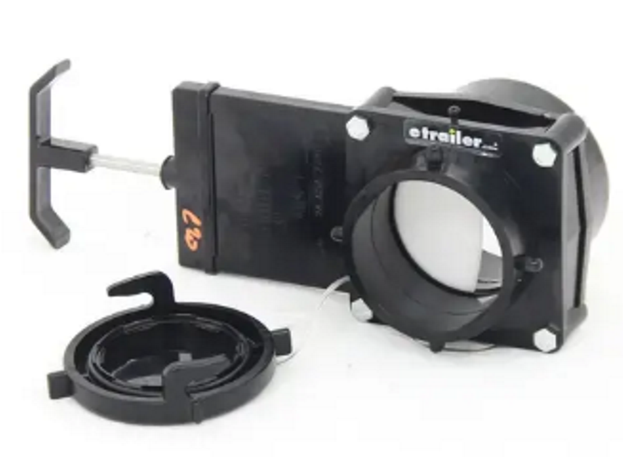

My question is why go to all the trouble to buld the blast gates wouldn't an RV black water dump valve do the same thing. It is already air and watertight.

Something like this is what I am talking about since it already has tight seals there will be no vacuum loss they can be bought in sizes ranging from 1 1/2" thought 3" openings. I haven't seen anything larger than that until you get into industrial quality valves.
Yes his craftsmanship is above reproach.
Attachment 44721
Inexpensive models have the simple pull handle, but you can buy these valves with 12V and air powered opening and closing attachments.
Down side of those plastic valves would be erosion of the valve by abrasive dust. He uses it wood and metal shavings. Even just wood chips would erode the plastic valve
