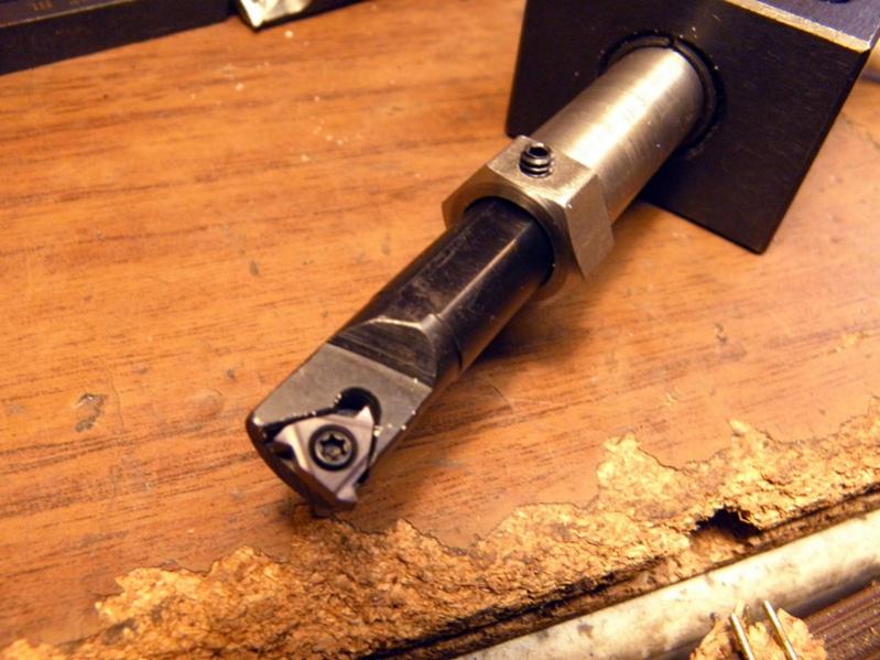

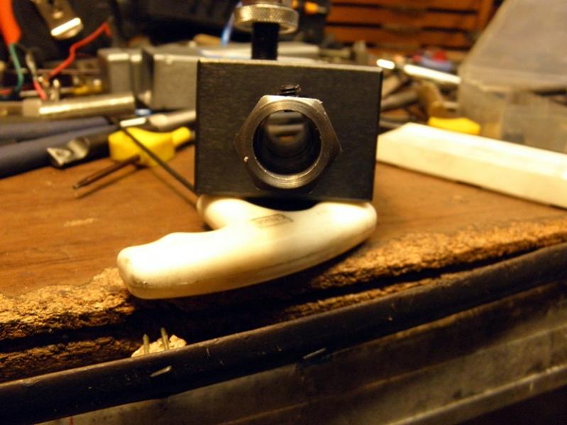

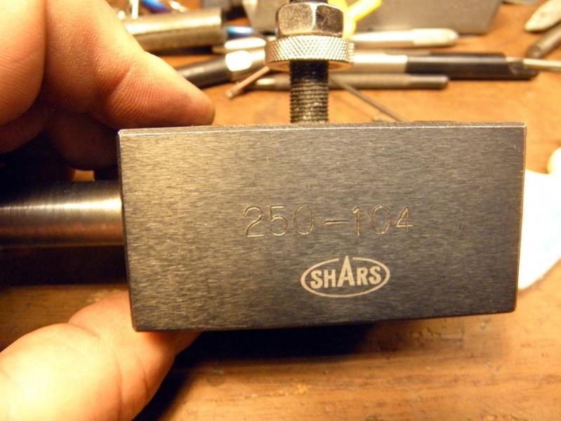

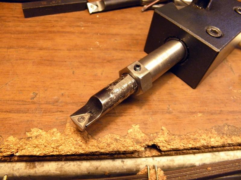

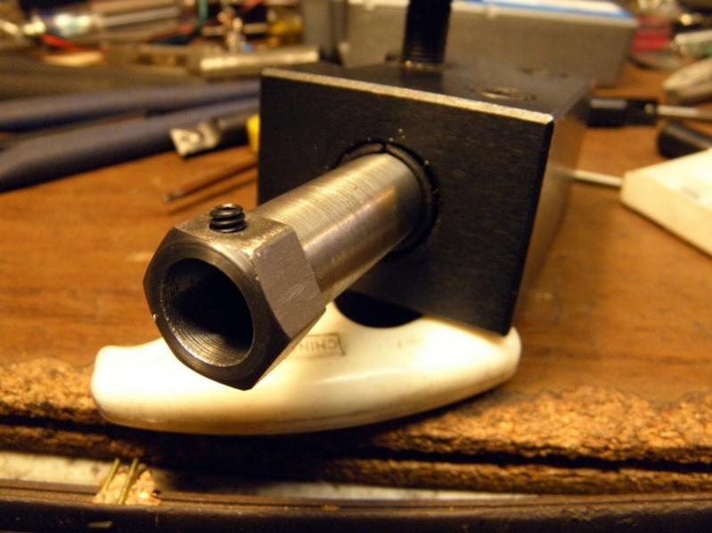

Boring Bar-Inside Thread bar Adapter shaft for 3/8 from 1/2 inch. Photos show it in the out position is now
pushed in.

Thanks Captainleeward, nice simple idea for threading and boring bar. :clapping: Did you just turn down hex stock and bore to size?
Hi PJS, YES and YES....:O)
