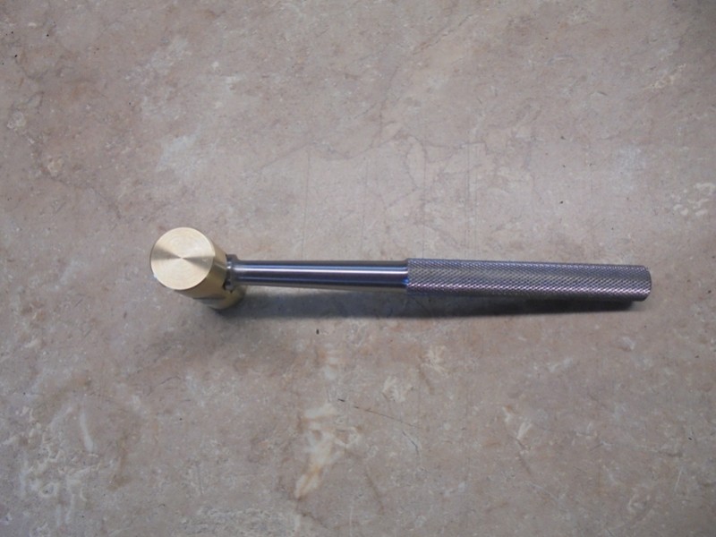

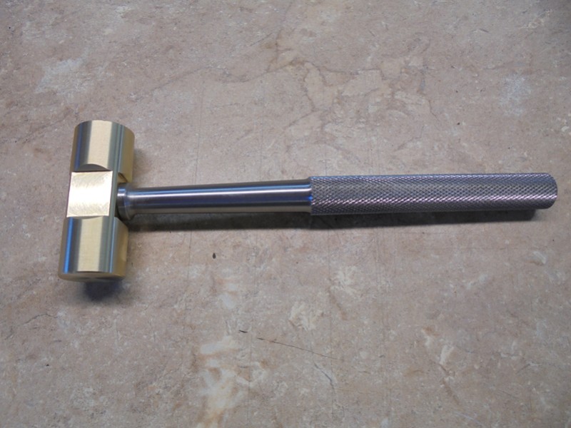

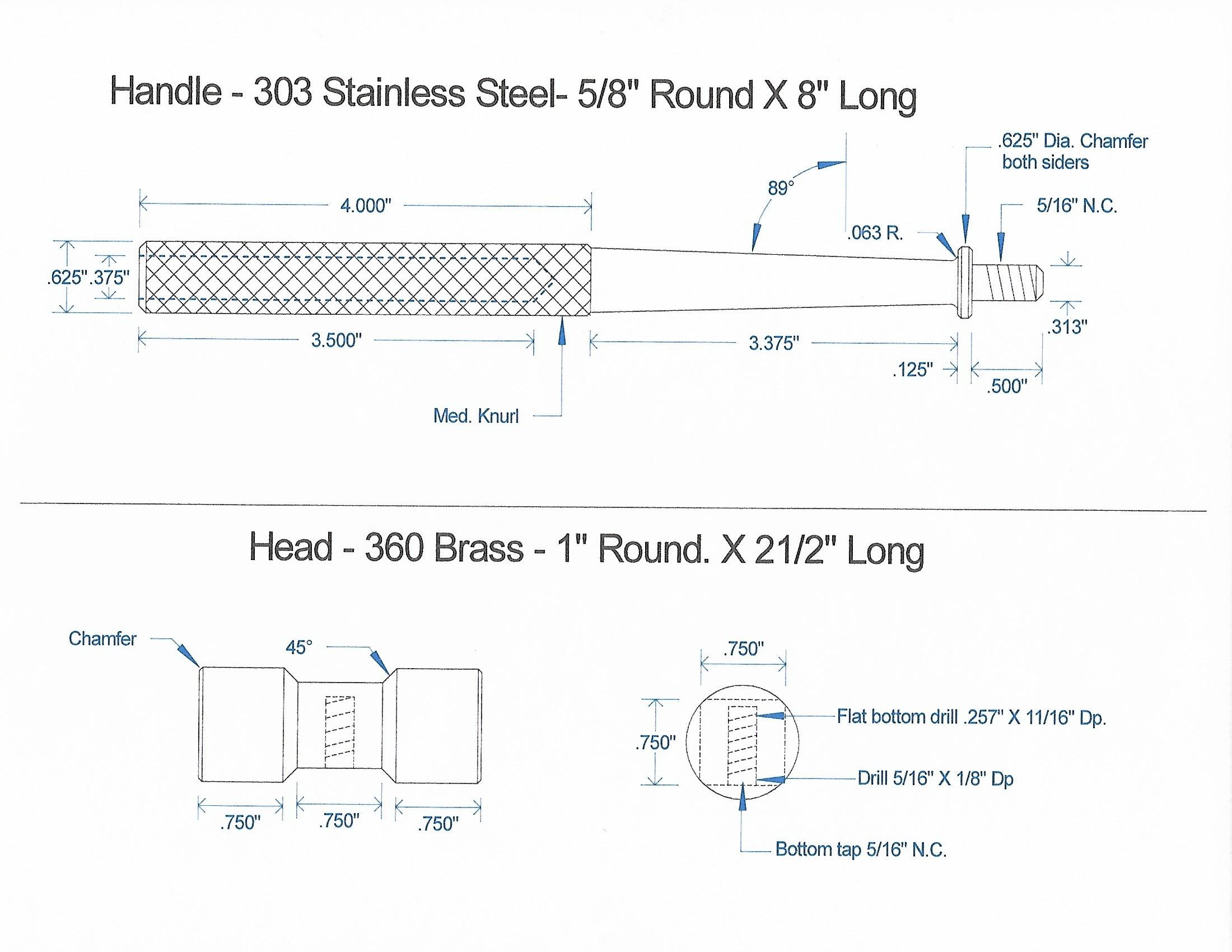

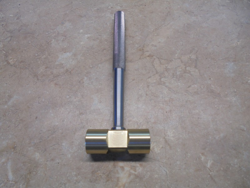

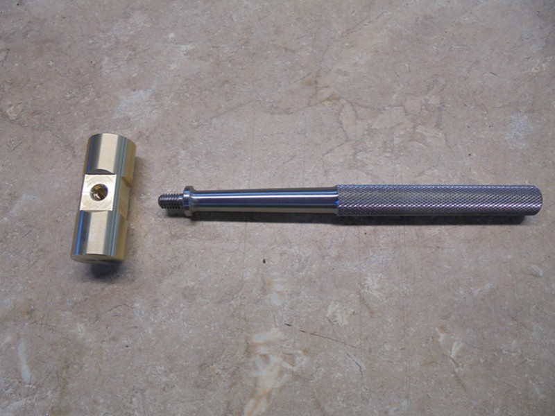

    I made this little hammer for adjusting work in the lathe chuck, seating parts in the mill vise Etc. It's just an all around light tapping hammer for whatever, I have for a long time just used a 1" diameter piece of brass about 3" long with no handle just to bump something lightly, So I decided to make something a little more appropriate.
    The head weighs 6oz. and made from 1" diameter 360 round brass, the handle is made from 5/8" diameter 303 stainless steel round with a medium knurl, the knurled end of the handle is drilled 3/8" diameter X 3.5" deep, this balanced the hammer very good, the handle screws into the head with a drop of Loctite, different heads could be made of lead, plastic, copper, Etc.
    Below you will find some photos and a cad drawing of the completed hammer
    as always, thanks for looking and happy machining
    Doug

    Parts of the hammer

    Assembled

    Another view

    Cad drawing

    Very nice looking hammer and just the right size for light tapping. Thank you for sharing your plans. I would have never guessed 89 degrees for the on each side for the taper.
    Paul

    The taper is 1° from the horizontal plane, the 89° is taken from a vertical plane

    Very nice. The .257" tap drill is correct, also known as a letter F drill, but most people will just have a 1/4' bit handy which will work just as well.

    Quote Originally Posted by Ron 2 View Post
    I drill and tap a 5/16" hole using a 17/64" drill, works just fine, 1/4" drill is getting a little to tight, anything over 17/64" is getting to loose, pick your poison

    (5/16 - 1/4) * 18 / 0.013 = 86.5 % depth of thread (quite tight)
    (5/16 - 17/64) * 18 / 0.013 = 64.9 % depth of thread (much better, easier to tap, very little loss of strength)
    For comparison, an 'F' drill gives...
    (5/16 - 0.257) * 18 / 0.013 = 76.8 % depth of thread (deeper than necessary)
    For the source of these calculations see...
    http://www.homemadetools.net/forum/c...7424#post37045
    Regards, Marv
