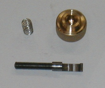

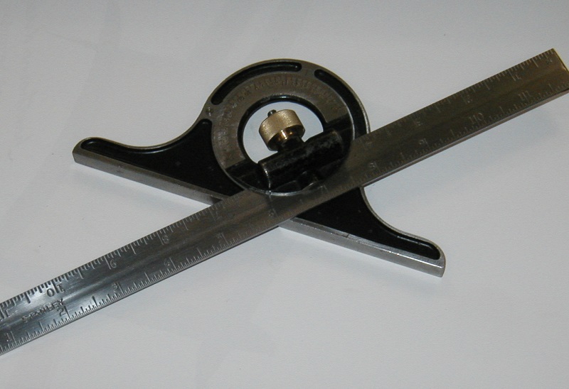

I did find an older B&S protractor head on E-bay with no blade or the nut and stud that retains it. I made a blade to fit it with one from an inexpensive Stanley adjustable square. Made the stud from scratch and turned a real nice, brass nut for it. That brass nut is oversized and has a fine knurl so it is very nice on my 75 year old fingers. I like it better than my newer Starrett that I found in a local pawn shop. For one thing I made the blade's width to have it sit dead flush with the base of the protractor when it is set to zero degrees. I like that in a protractor head and, as far as I know, none of the manufacturers make them that way.

Thanks, i was very lucky. That's a great job you did with the protractor.
