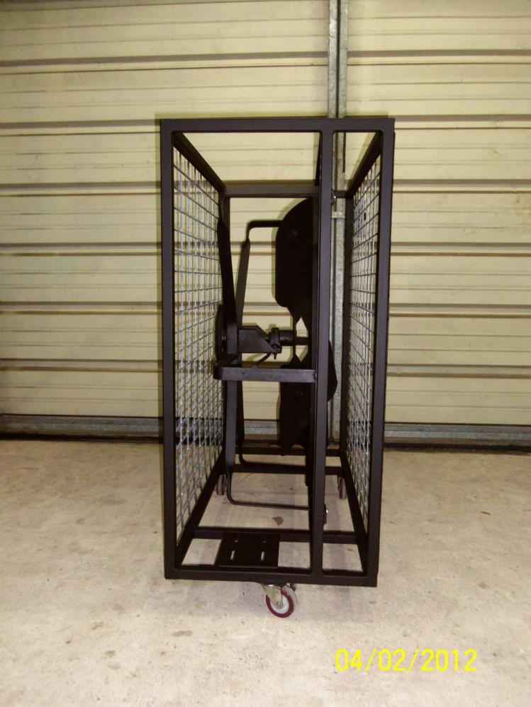

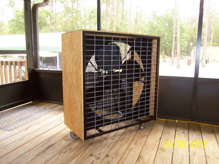

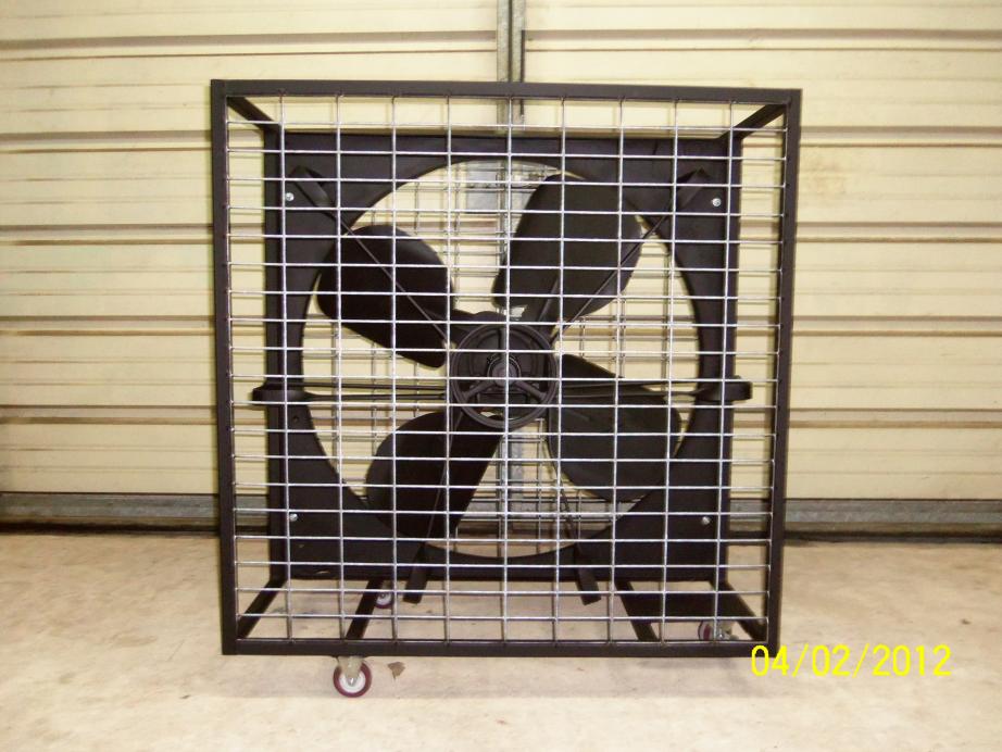

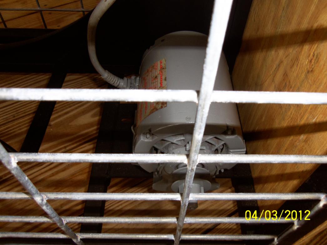

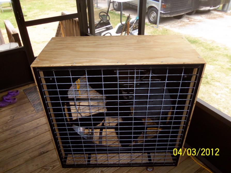

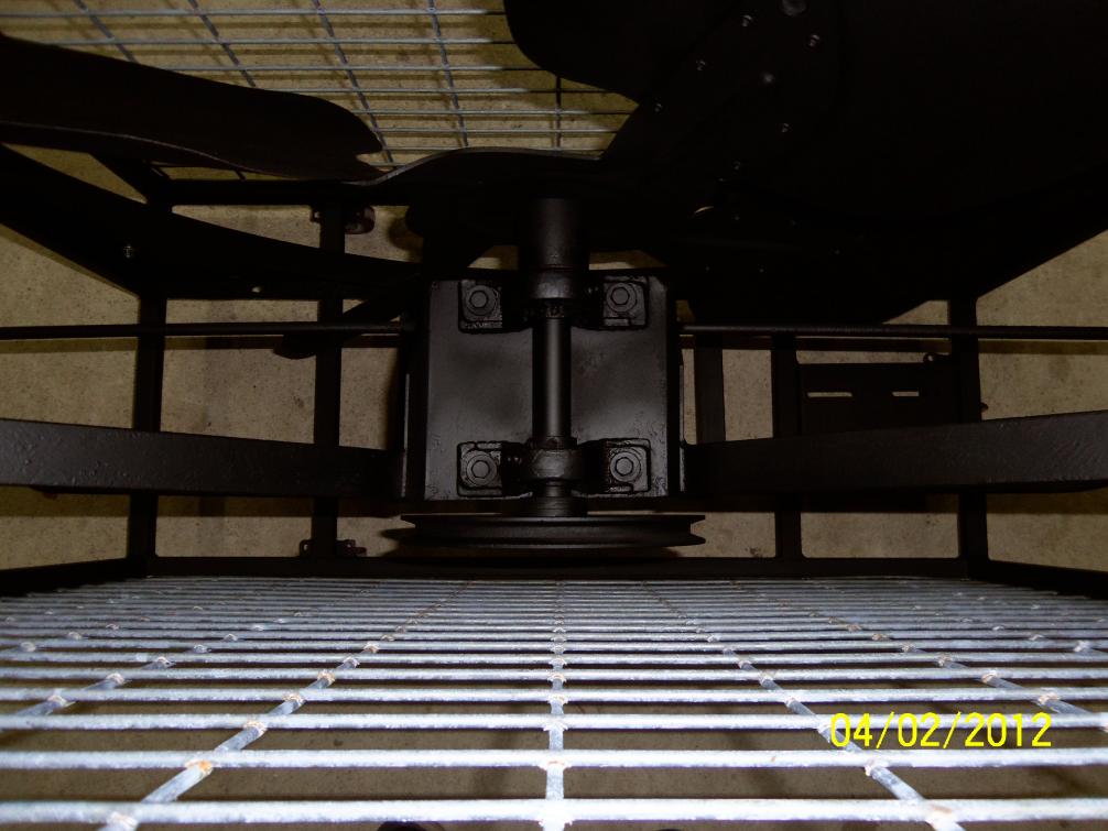

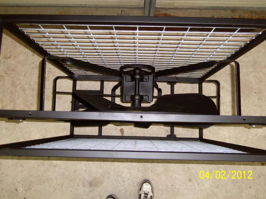

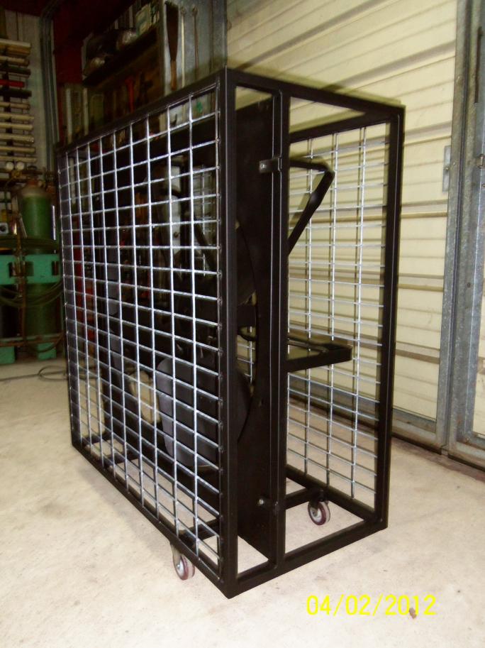

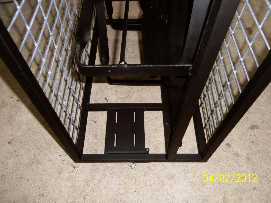

    OK living in Florida gets hot during the summer months. So a large fan would be really helpful. My Dad found the fan blades and shroud at a yard sale. I welded 1"x 1" by 1/8" square tubing frame together to build a frame. Added 3 wheels to the bottom to wheel it around. Than the motor base was built and welded in. Bought some horse fence and made guards for front and back. Rip down some plywood to build both sides and top. Now the fan sits on Mom and Dads porch and keeps them cool all summer.

    Cool. What's the blade diameter on that thing, Vernon?
    About 36" blades on that fan one down at the shop is 48.

    Hi Vernon, what's the rating on the motor driving the 48 incher?

    Quote Originally Posted by DIYer View Post
    DIYer I like to see the fan run at 172.5 RPM so if your motor runs at 1725 Divide that by 10 is 172.5 rpm can run it faster but I hate the noise. Just want to move air not chop at it.
