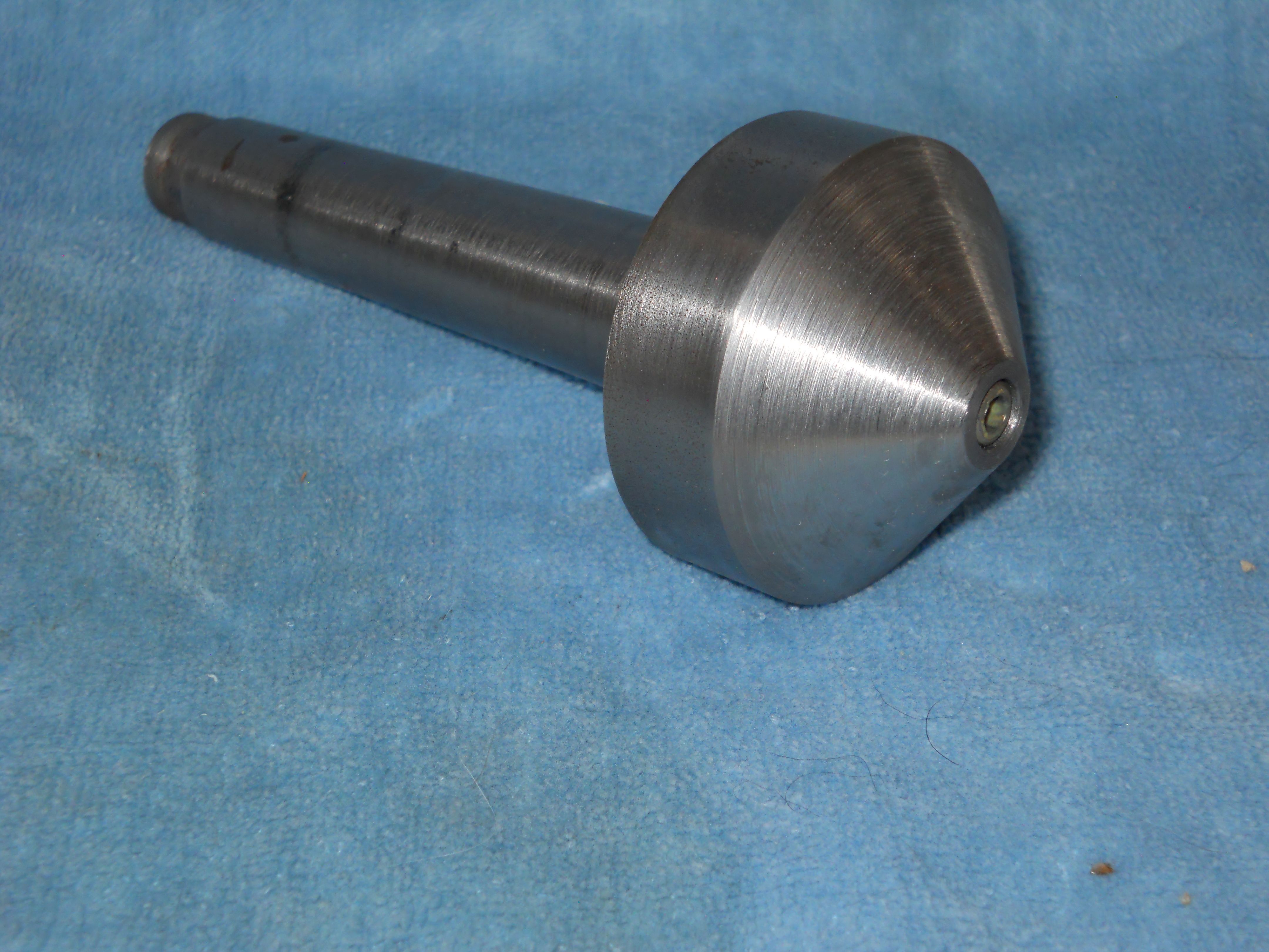

This simple tool supports tubing or pipe when truing ends or diameters .It prevents the piece from working out of the lathe chuck.

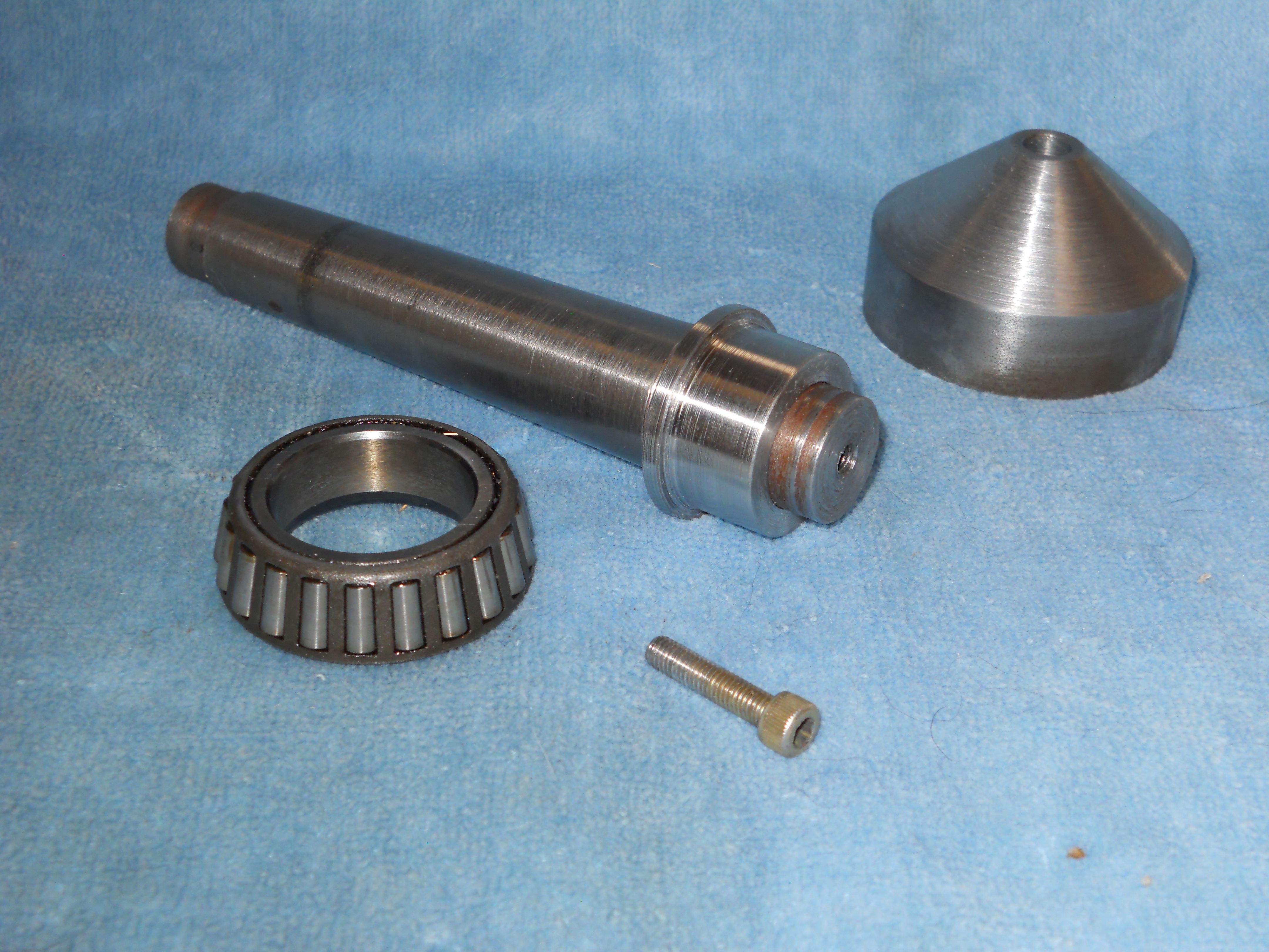

These large diameter centers are invaluable as the OP stated
Here is a variation that I made sometime back it is 3 1/2" in diameter
http://www.homemadetools.net/forum/3...861#post111875
