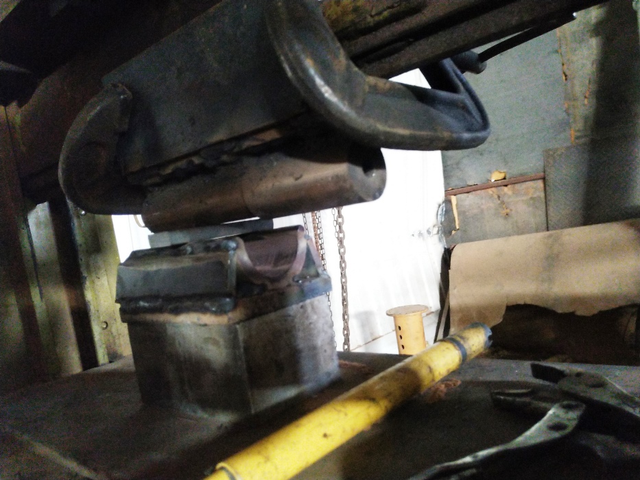

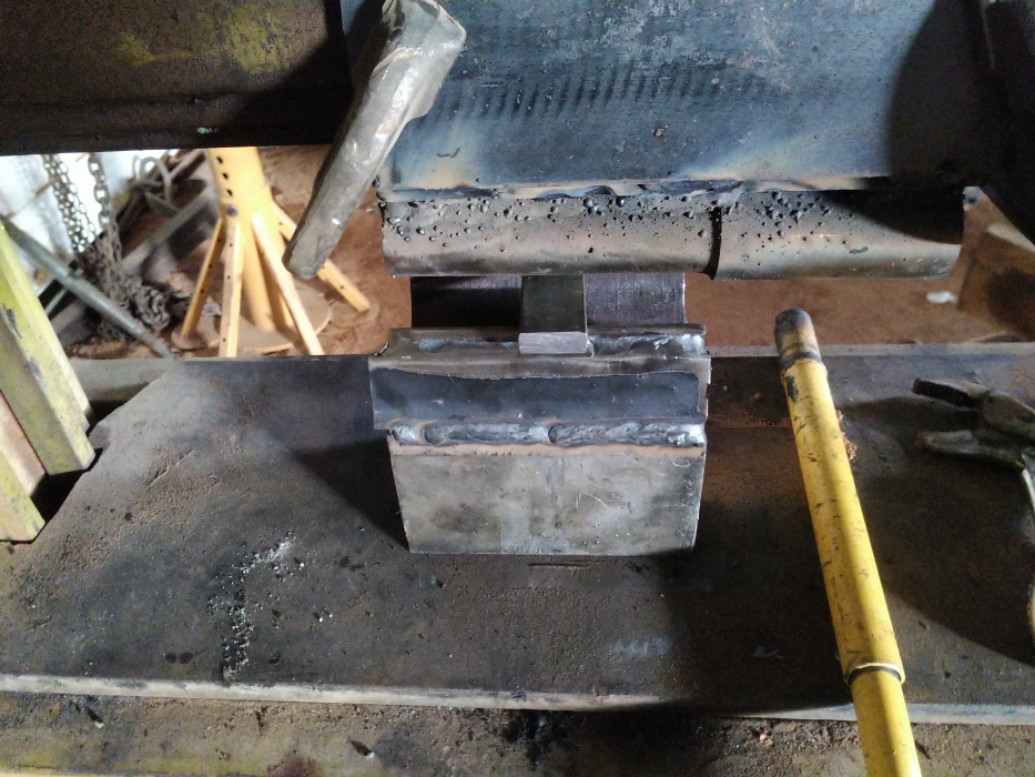

I needed to form several semi circular parts to protect the nuts and bolt heads on an insertion tool I was making.
the parts were to be made of 3/8by 1" flat bar 3-1/2 inch long the inside radius needed to allow for an impact socket to fit over the bolt head this is the punch and die I made
Attachment 46897
Attachment 46898
