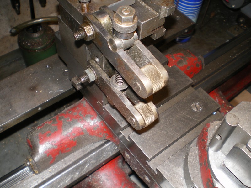

    Hi Cascao, nice work as usual,
    For what its worth I have found that straight knurl wheels will work just as well in your scissor tool.
    I have diamond knurls but prefer the straight ones and they have been mounted in my old scissor tool in the rear toolpost for years.
    I agree with your observations on their usfulness.

    Olderan, didn't really know that straight knurl wheels can be used on scissor tools, nice to know. I belive (and hope) that since only one is needed, (the pressure on bearings is smaller) it is less harmfull to spindle bearings.
