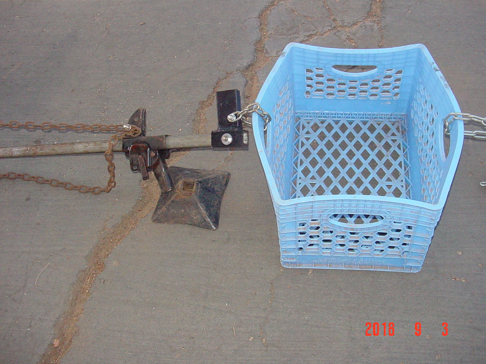

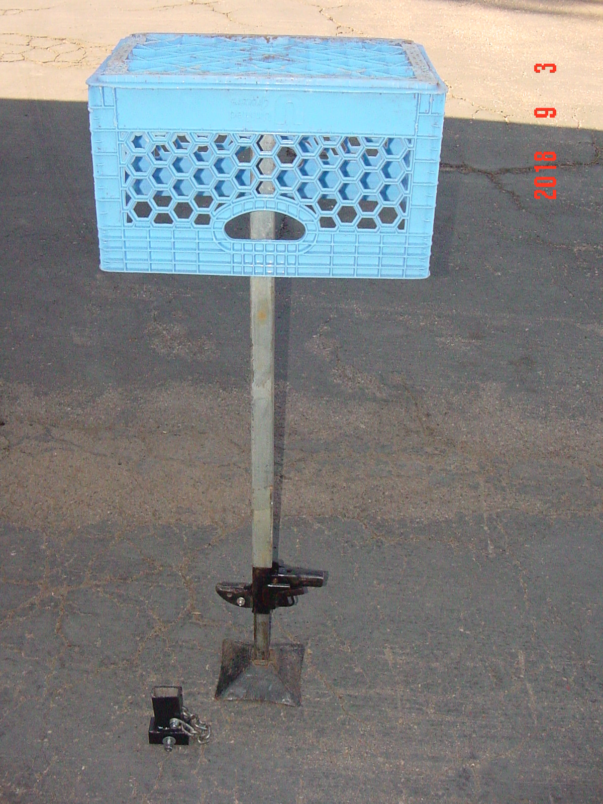

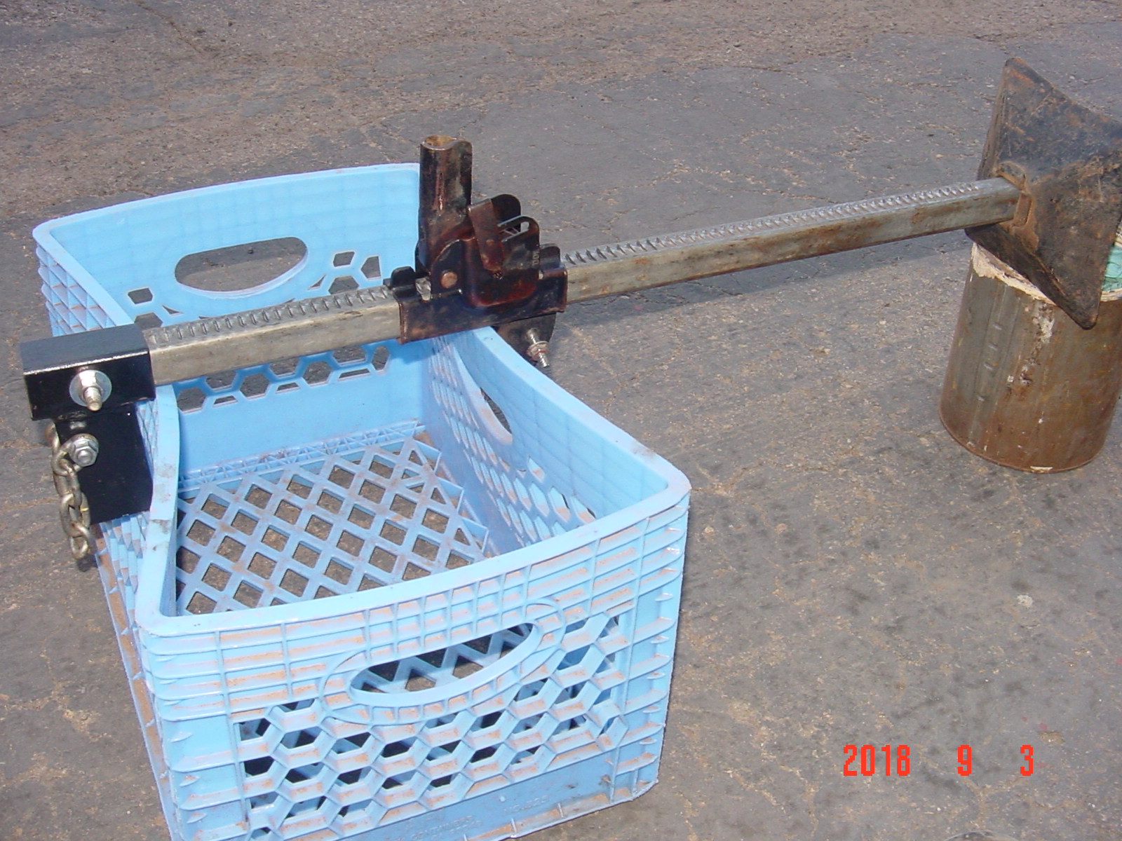

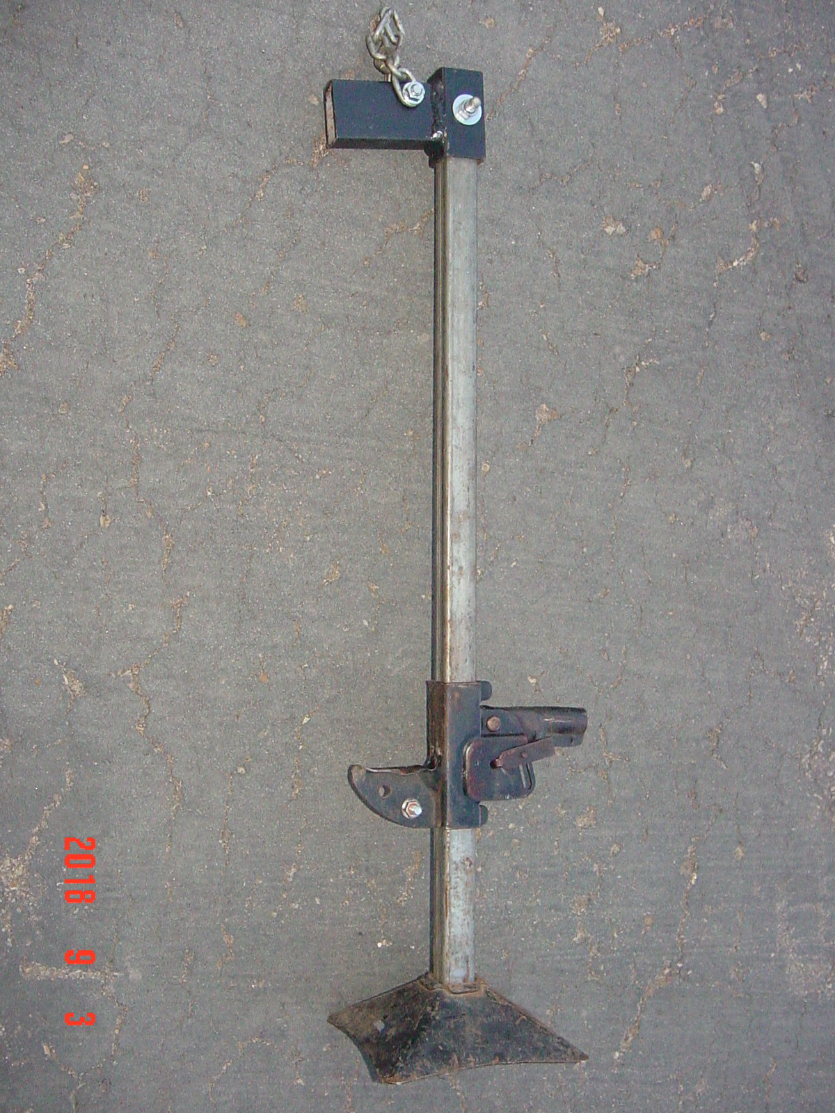

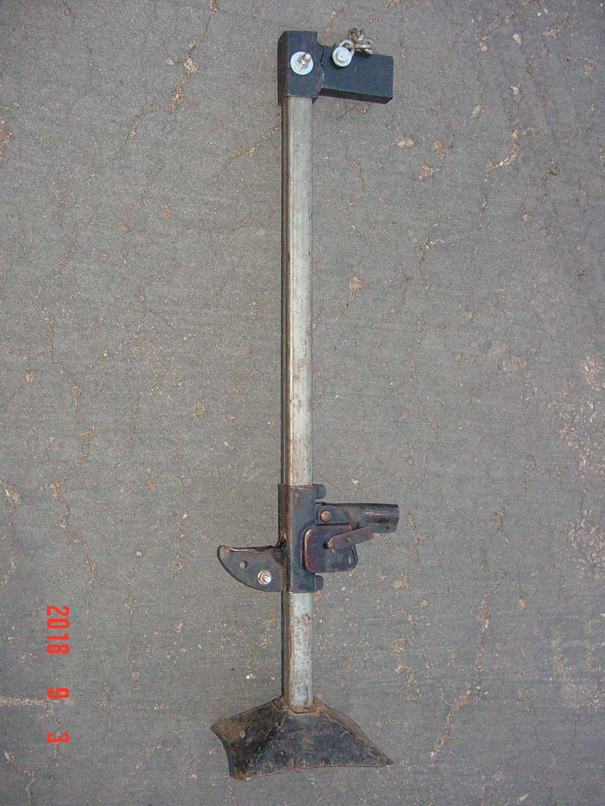

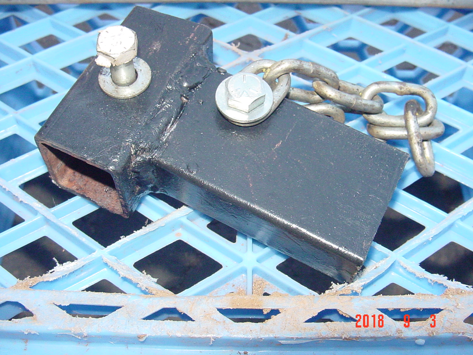

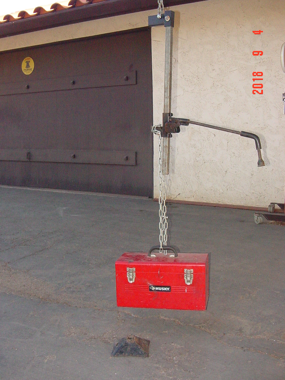

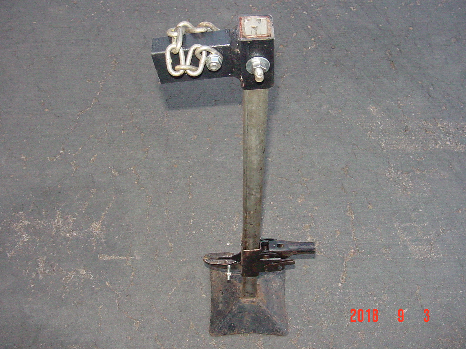

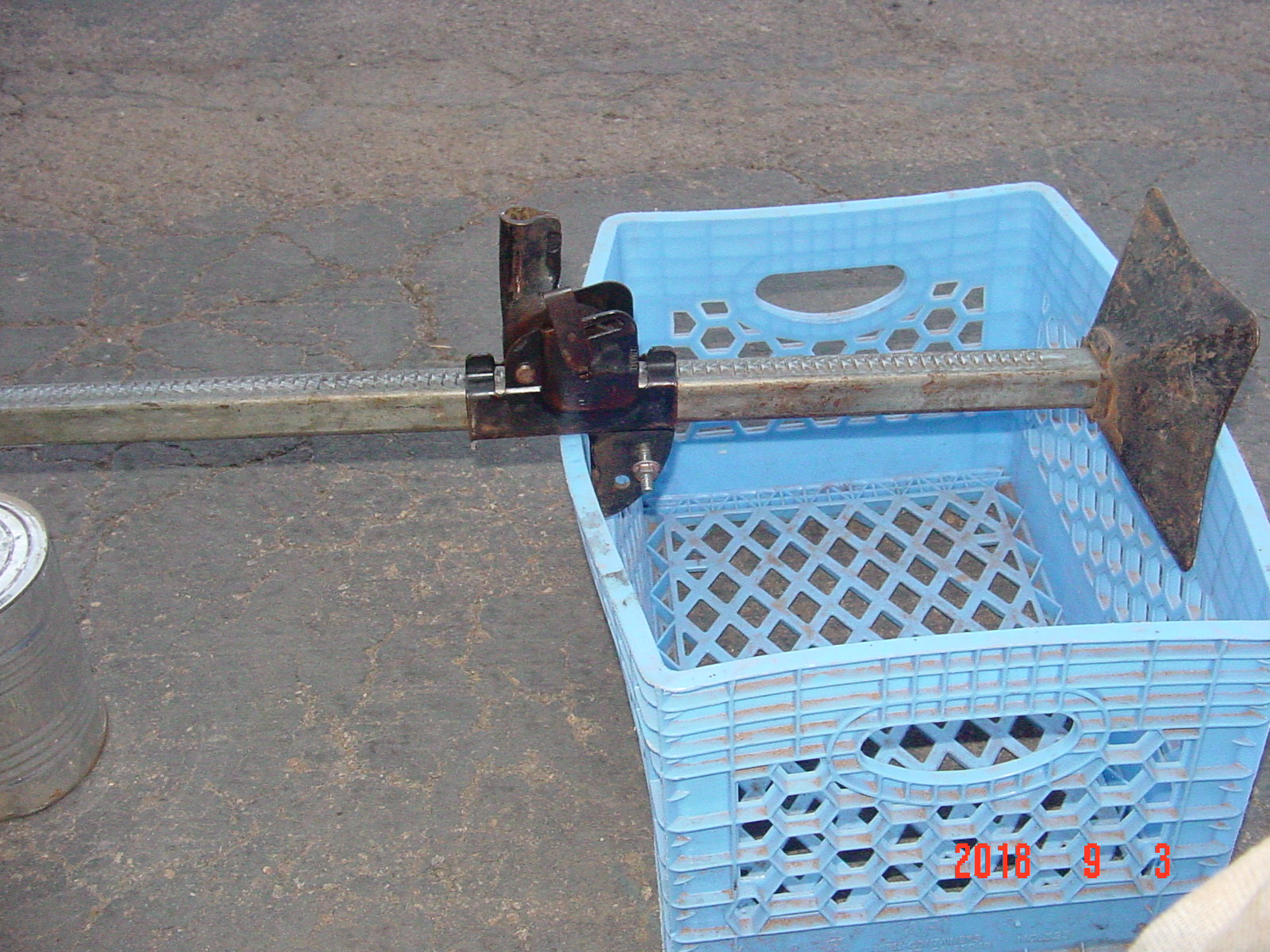

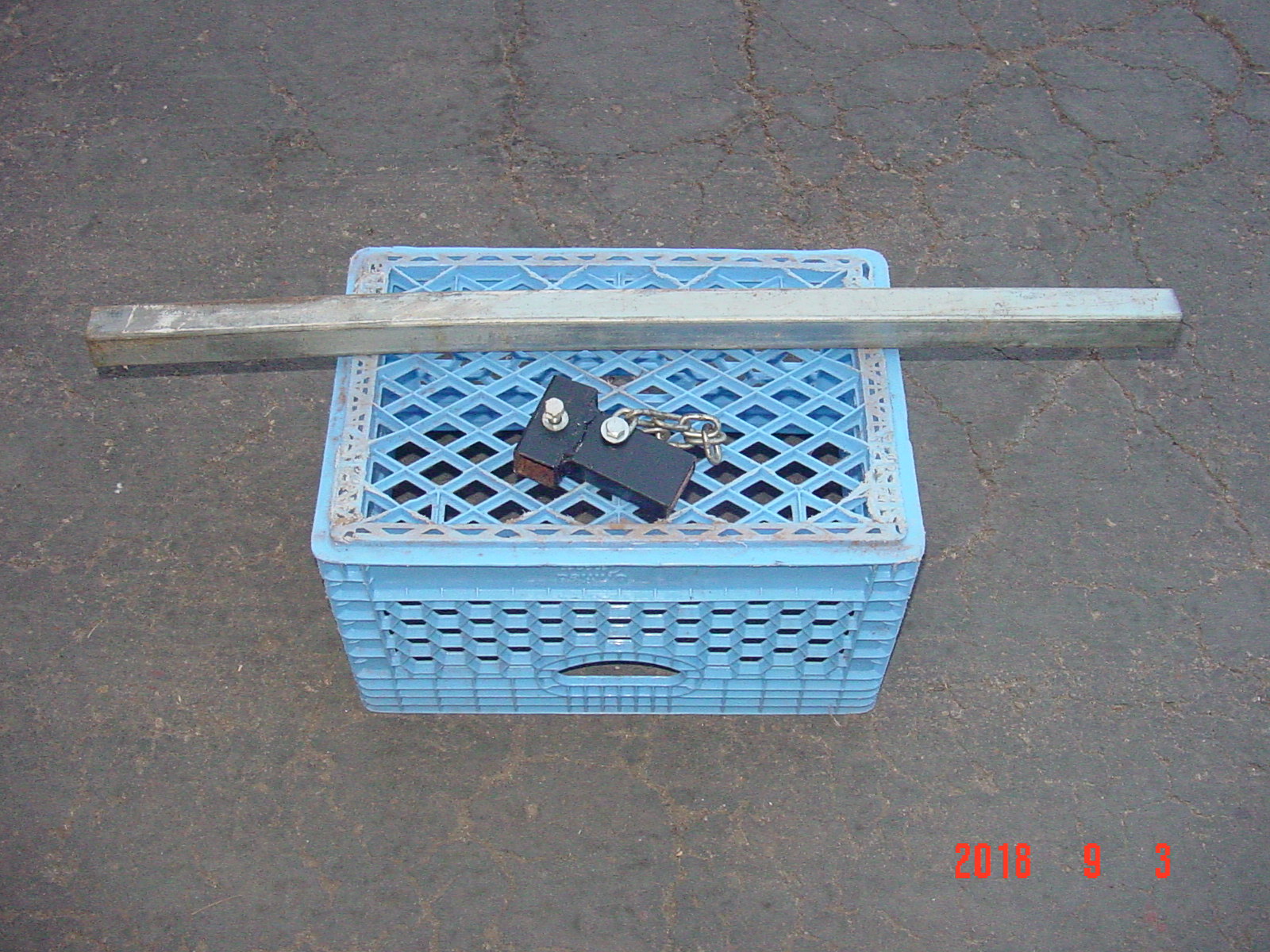

BUMPER JACK MULTI TOOL
THIS IS MY BUMPER JACK MULTI TOOL. IT BECOMES A TOOL WITH CAN LIFT, SPREAD, CLAMP, PULL, PUSH WITH THE ADDITION OF AN UPPER ATTACHMENT & A PIECE OF SQUARE TUBING. Copying this conversion design is at your own risk. I refuse any liability for any project you make. Email me at "flying.k@juno.com

That plastic crate is a great way to show the jack in action.
You can do a lot accessory-wise with this. Fence post puller comes to mind.

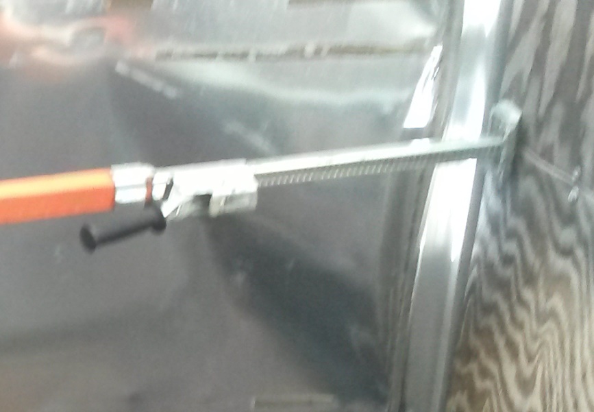

1 Attachment(s)
Found it. can't claim it as a homemade tool since we made 1000's of them not even my design
Bumper jack load lock.
Attachment 25670
Nice. Can also look up accessories for a commercial Hi-Lift jack for ideas.
