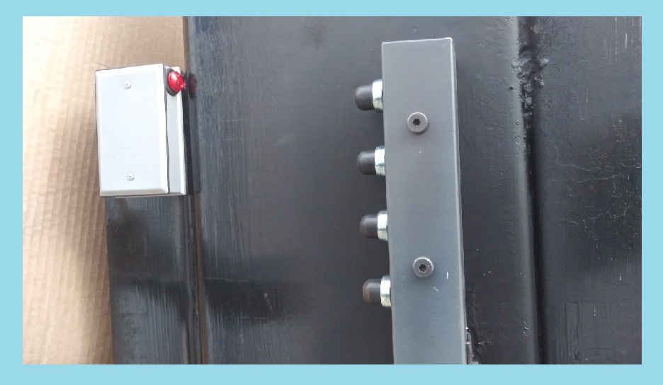

In the front of either fender (two axles) there is an LED 1/2" jewel lamp, bright enough for use (and sold as) a clearance light. Wired into tail lamp circuit, to me it just confirms the connector between vehicle and trailer is in place, with lights operative. It struck a chord being so useful, mostly an aid cornering or backing up to mind obstructions in the dark, even monitoring position in driving lanes. I never have a spotter, so anything helps.
Well, that multiplies handling the box truck, Without convenient protrusions, the puzzle was how to add the feature narrow-neat-clean-easily. Finally settled on fitting used when installing rigid conduit. It's called a "box extension no holes", covered with blank equal to a switch plate.
Attachment 44181
They're attached on side of the tail and back up housing with the normal 6-32 screws with nuts, not drilled and tapped. Took a minute to fix a position avoiding interference from corners, rounded edges, welds, brackets and plates holding original lights; and passenger side to peek over the lift-gate switch housing. In truth, about a minute for each of those obstructions, times two or more of juggling. I'd say there's an 1/8" of leeway in 2 directions. At home base, would have made a drill guide plate, tapping saves more room than hardware.
Drill 8 holes on a ladder, square and in position, then tap 8 times? No Thank You! Most will agree, using the 6 is least forgiving of all sizes.
Being spliced into parking/ taillight circuit, it is plenty bright to see in mirrors 40+ feet away, even in daylight. Design of lens makes illumination visible 90 degrees off-axis. Watts unknown but "The 2 pk LED 3/4" round red clearance/side marker light meets FMVSS108 requirements for combination clearance.". And the price, at just over $3.00 each, a third less than many others. Hopkins C2534BRK
