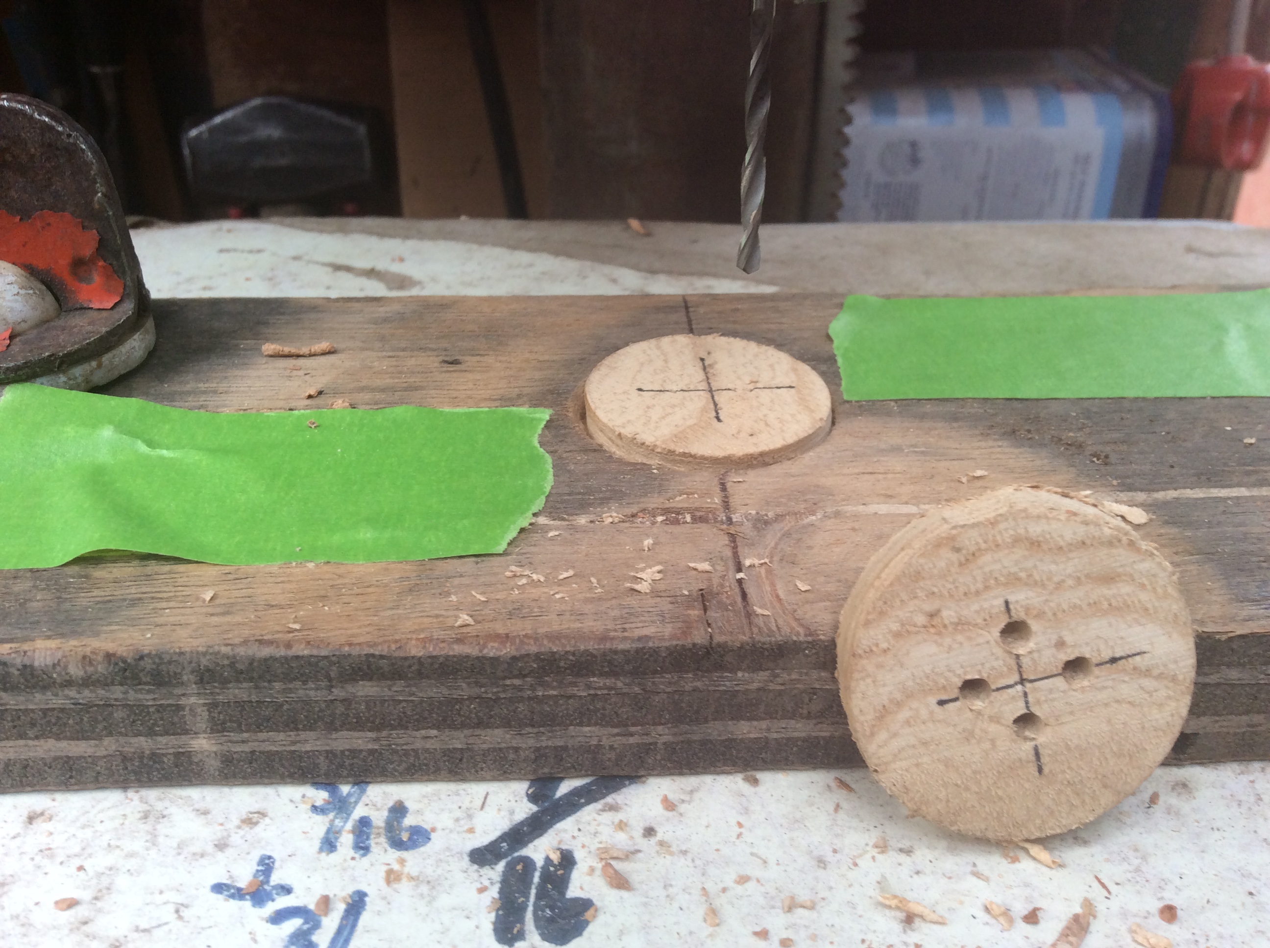

This simple jig achieves considerably better results compared to previous efforts. The disc is slightly off centre to the drill axis, marked as before with centrefinder, but not pricked, saving a lot of time. It rests in a hole, through the centre of which are drawn lines at right angles, so all that’s needed is to rotate the disc to drill 4 holes.
