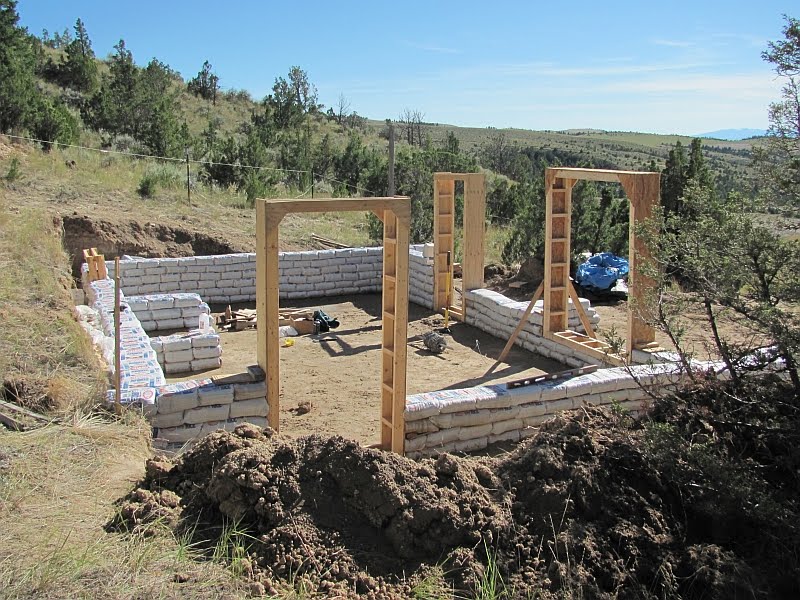

This cabin, built by Kent on kentscabin.blogspot.com, offers an in-depth look at a rarer method of cabin building: earthbag construction.

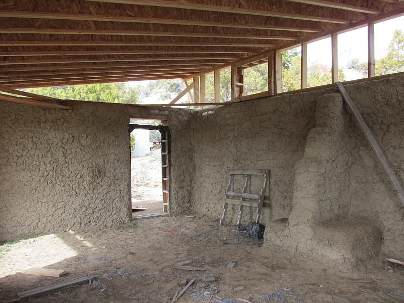

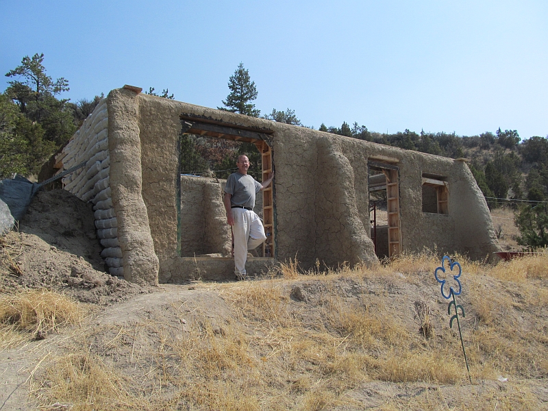

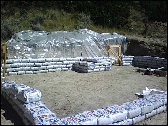

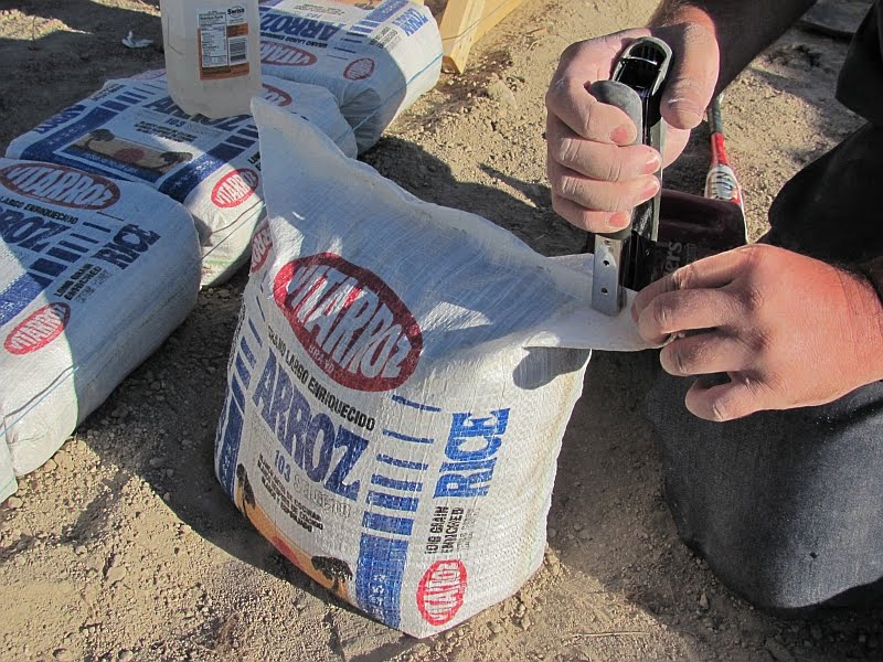

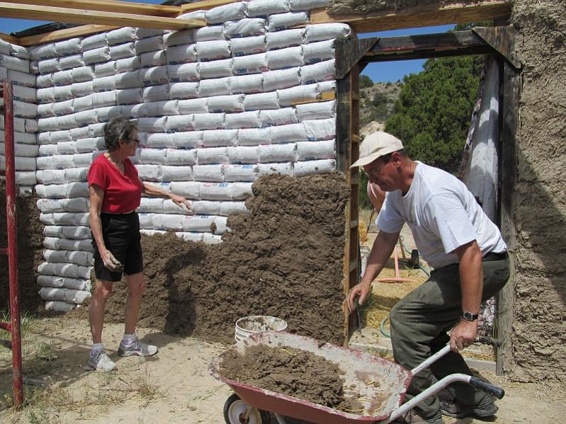

Bags of earth are tamped and stapled shut, and arranged in rows separated by barbed wire. Window and door openings are framed out in wood "ladders", and everything is then covered in adobe.

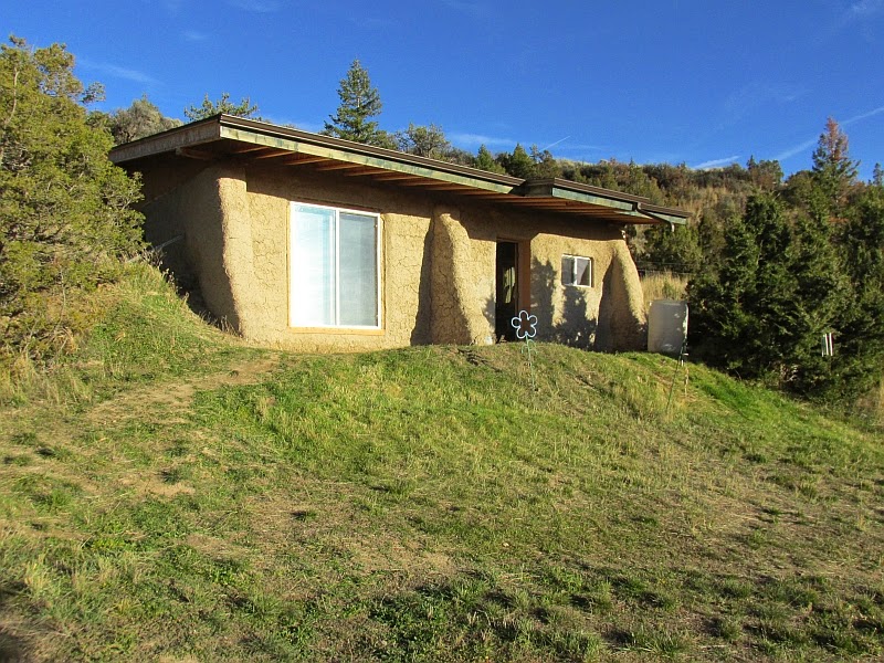

This is a fairly detailed build that stands out among the stick framed, timber, and log cabins because of its unique construction. Once finished, it looks like it emerged naturally from the hillside, in the middle of nowhere in Bozeman, Montana.
