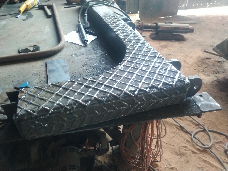

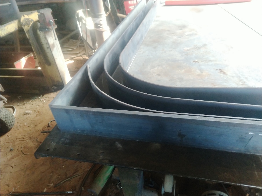

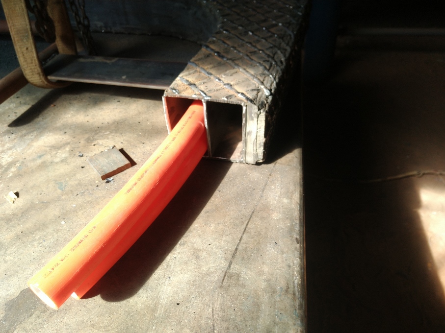

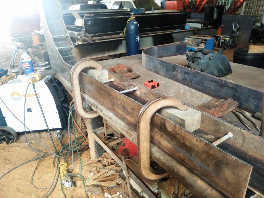

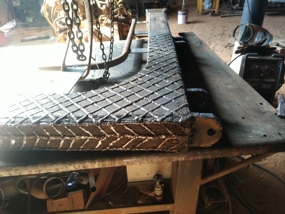

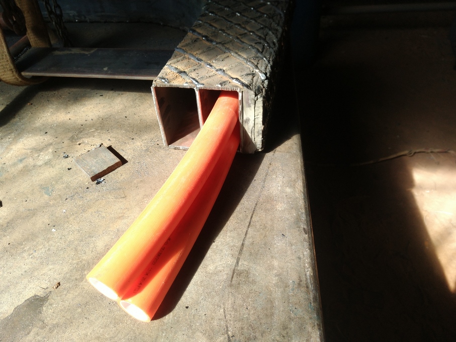

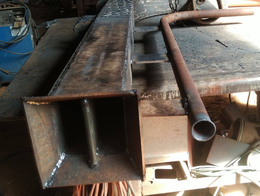

This makes the 3rd plow chute I have made for the same construction company. They need to install 4 poly pipes to run fiber optic cable in
It will mount to the back side of a ripper shank there will be a trailer reel trailer pulled in front of the dozer and 2 reels will mount on the front of the dozer
