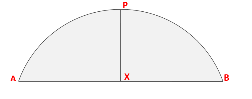

There's a geometric method of solving that problem with a compass, assuming you have a 2-template of the segment:
Given:

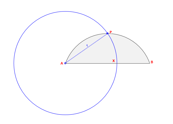

1) Using a compass create a circle at "A" using as its radius the distance AP:
Attachment 36447

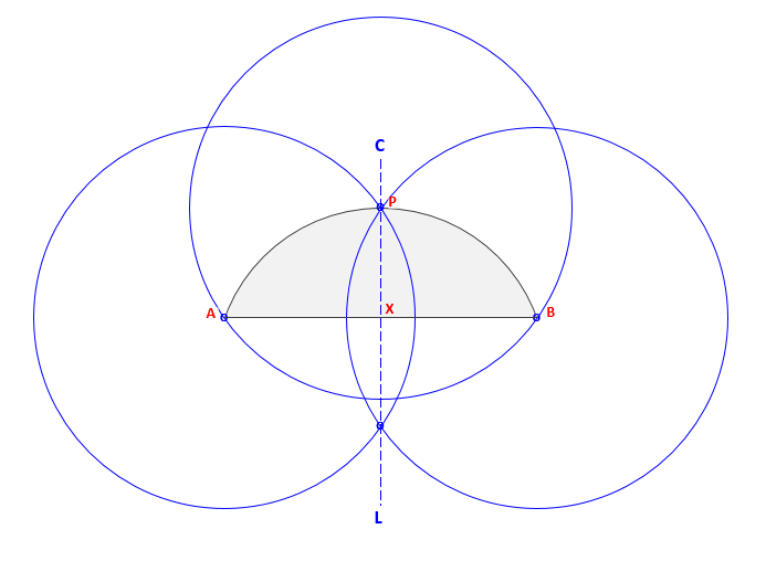

2) Now using that same radius, make corresponding circles at points B and P to locate the intersections.
Attachment 36448

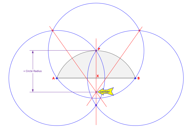

3) Now using a ruler draw a line through the intersection points of each pair of circles. The intersection of those three lines will be the greater circle's center and the radius follows, as shown.
Attachment 36449
Yes, that will work but using the formula will be a lot faster and requires no scaling, no template and no drafting.
