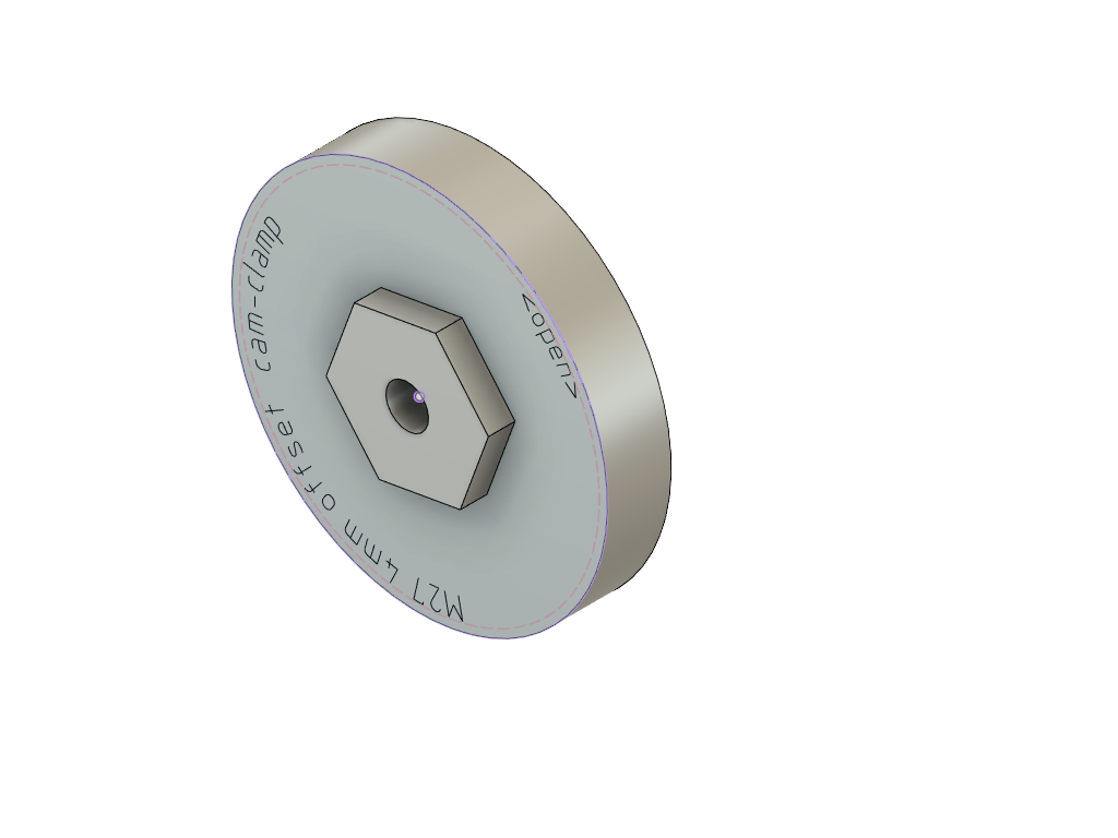

Along with generally tring to get a handle on how to use this beast I've create, we made some cam-clamps and an mql system for the CNC. The clamps are made from 'bean-can' aluminium (:headscratch: watch the vid) and operated by a spanner, so 'the handle' doesn't get in the way and you can really crank em tight. Hope it's of interest to some.
