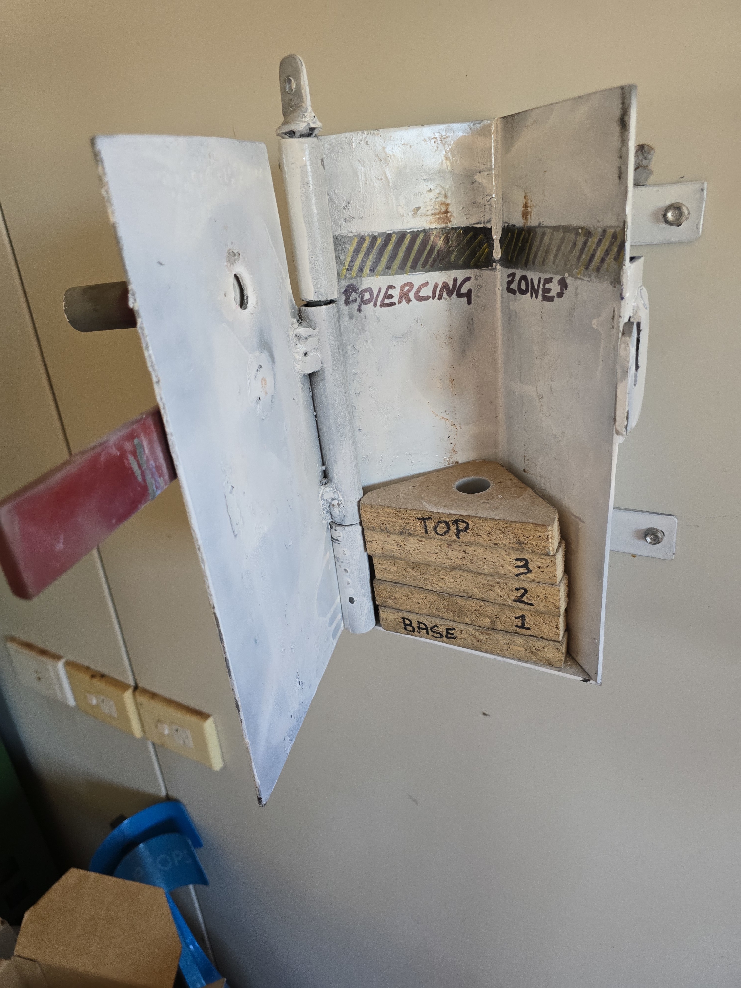

Originally Posted by
paul_j
Nice work, and smart!
I've punctured 100's of spray paint cans. I worked in road construction and we got marking paint by the case. I always held the empty can down on its side with my boot and gently swung the tip of a machete or corn knife into the side of the can. I used the dull side of the knife tip for the impact. Any remaining paint would be in the down side of the can and very little would ever come out of the puncture hole. Only a small puff of propellant comes out of the puncture. If anyone was interested in the marble, a twist of the knife would enlarge the hole. I never had a mishap or even a mild scare using that method. I only did that with EMPTY (no paint left) cans. I have never tried it on anything but paint cans, but I think that I'll experiment with some empty brake cleaner cans. My son has an auto repair shop and there is a heaping barrel of empties that he cannot put in the dumpster.
