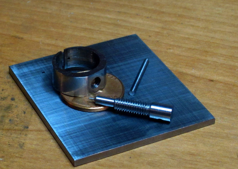

    Here's a shot of the parts before heat treating (note the hole near one of the jaws... that was not on purpose, just a stray hole from a mistake I had made):
    Cannon pinion puller-parts%25u0025252520before%25u0025252520heat%25u0025252520treating.jpg

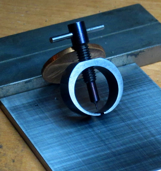

    After heat treating and assembling:

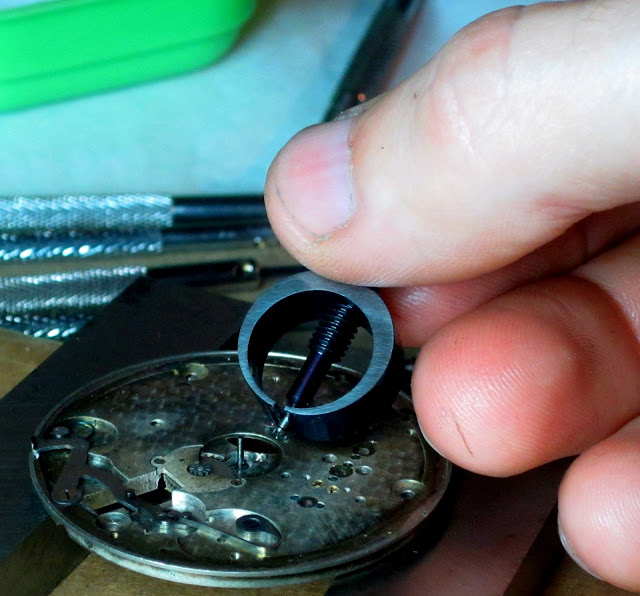

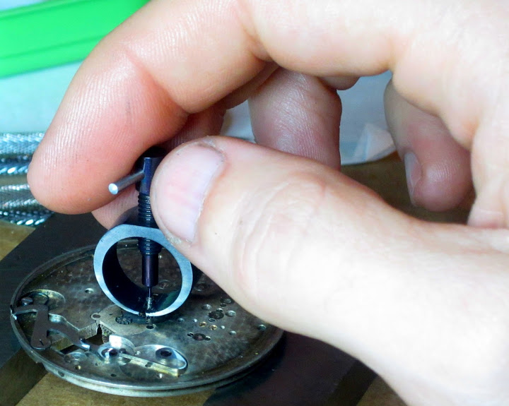

    Testing it out on an old Burlington pocket watch movement:
