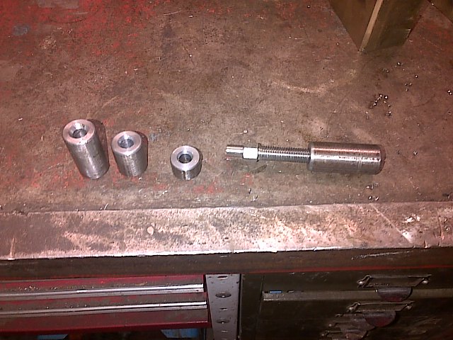

had a mate bring some cases over from some pre-war farm equipment hes restoring.
needed a speader to get internals out.
made one up using pce of 1" rd stck drilled and tapped m10, then made jacking bolt out of some 7/16 hex bar with one end threaded m10 and other end to 8mm.
then made 3 spacers to fit on 8mm end ranging from 1/2" - 1-1/2" long.
Attachment 820
