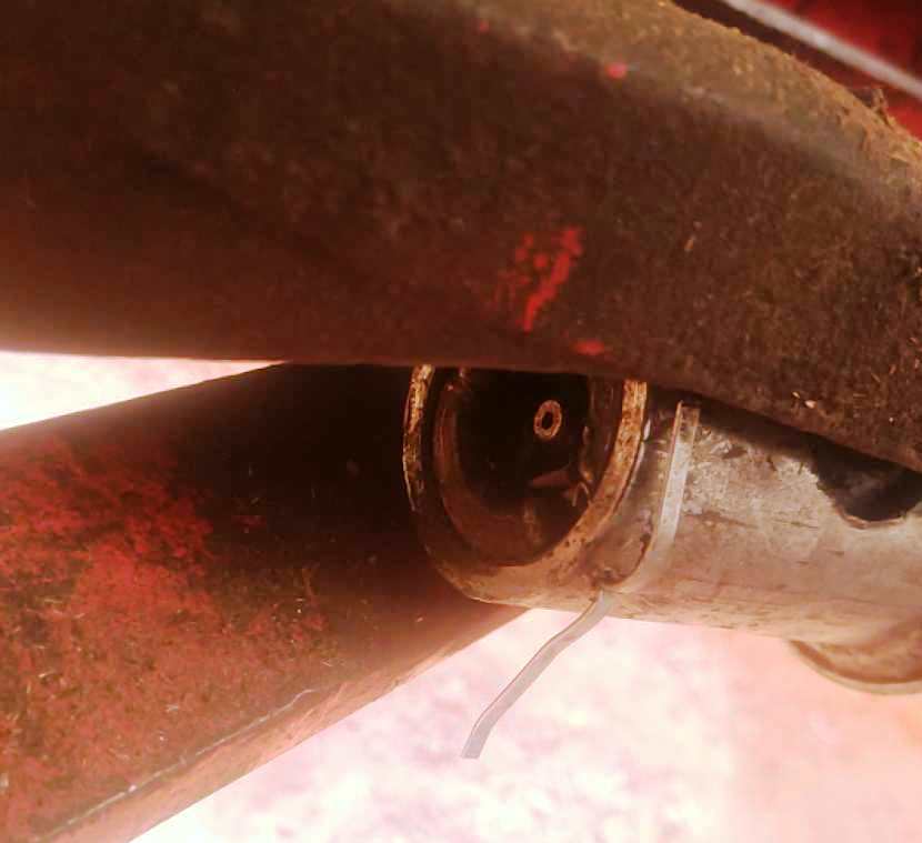

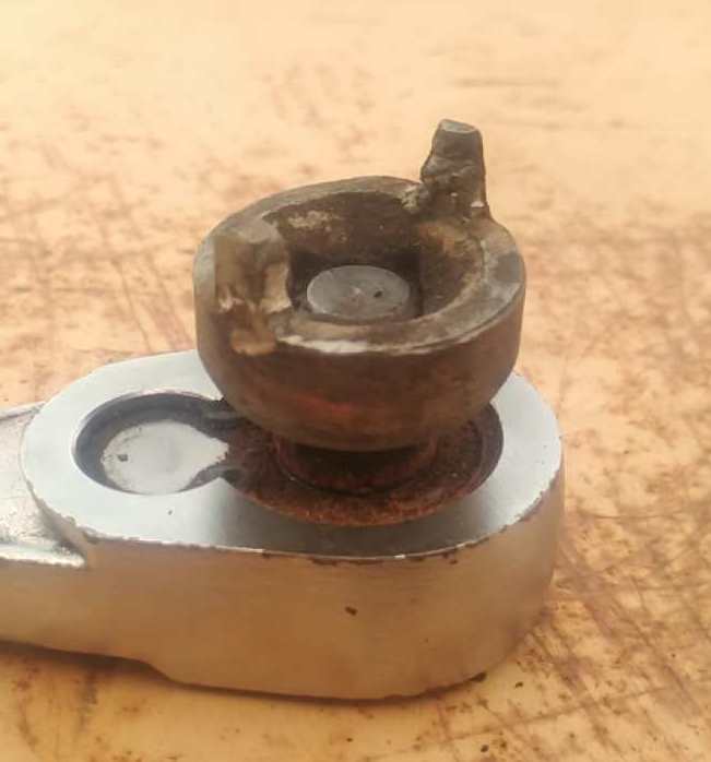

the JJ Case tractors of the 60s had very simple steering cylinders held on at the rod end by a ball joint to remove it you need a tang socket this was what I ground out of an old socket
Attachment 40432
to fit the slots in the internal nut
Attachment 40433
