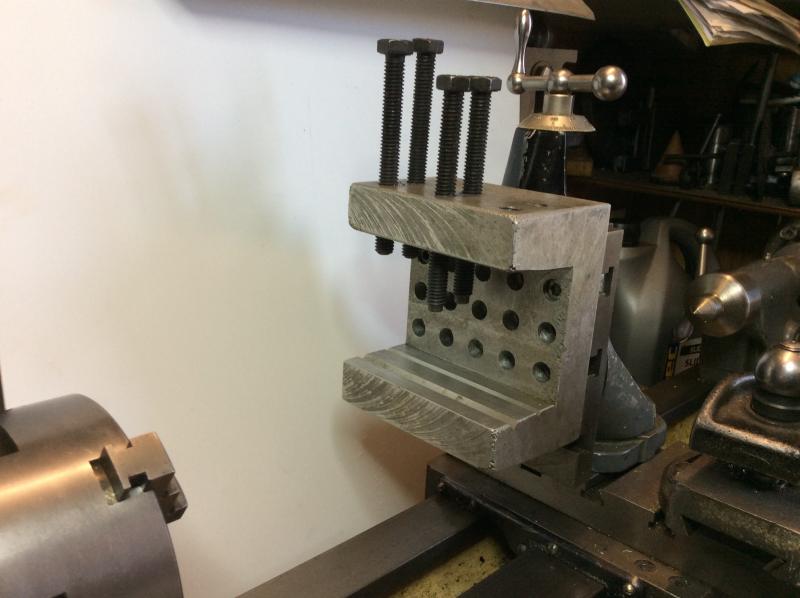

Mounting holes are spaced at halve the pitch of the vertical slide tee slots. It can be mounted at 90 degrees if required.
