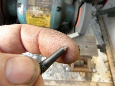

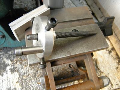

Center punch sharpening guide.

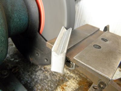

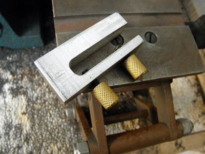

This guide is clamped to the grinder fence.

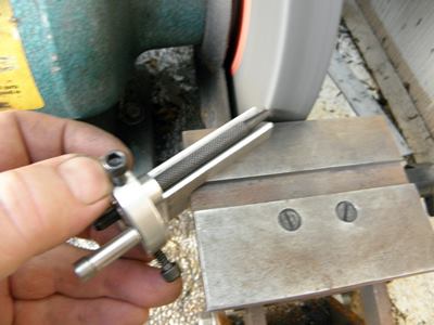

Then you put the center punch in the grove with your right hand hold the punch down on the grove with your left hand, rotate the shaft until the desired point has been ground to your liking.
