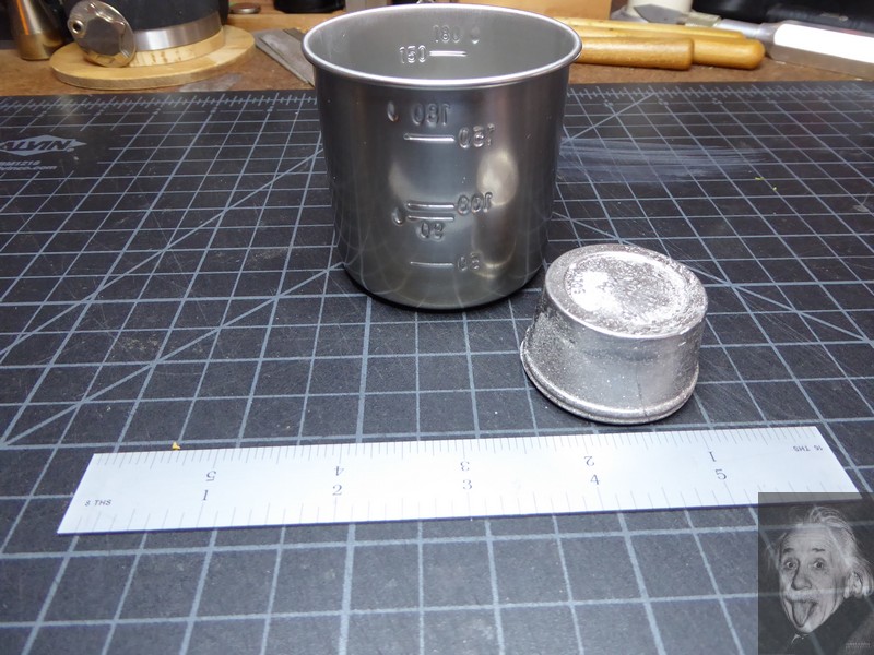

Precision measurement of the diameter of holes is one of the trickier problems for neophyte machinists. Calipers are worthless for the job, split-ball gages require developing a "feel", and inside micrometers won't go below 0.2". Plug gages provide accuracy and can measure below the rim of the hole but are expensive, especially so given their infrequent use.
However, there is a relatively cheap way to get the job done. Gunsmiths are often faced with the job of measuring the internal diameters of the chamber in a rifle. They get the job done by making a cast of the chamber, extracting the cast after the metal has cooled and measuring the cast rather than trying to work inside the chamber. The material they use is something called Cerrosafe.
Cerrosafe is an alloy with a low melting point. It is a non-eutectic mixture consisting of 42.5% bismuth, 37.7% lead, 11.3% tin, and 8.5% cadmium that melts between 158 °F (70 °C) and 190 °F (88 °C). It is useful for making reference castings due to its well-known thermal expansion properties during cooling. The alloy contracts during the first 30 minutes, allowing easy removal from a mold, then expands during the next 30 minutes to return to the exact original size. It then continues expanding at a known rate for 200 hours, allowing conversion of measurements of the casting back to those of the mold.
Cerrosafe is heavy, .341 lbs./in^3 (9.4 g/cc) and costs around $30/lb from gunsmith suppliers or Amazon.
The picture shows a half pound slug. In the background is the stainless rice measuring cup in which I melt it.
Given the nature of some of the component metals in the alloy, it's not a good idea to overheat it when melting it. Use a double boiler or a heat gun rather than a torch. A temperature controlled hot plate is also a possibility.
