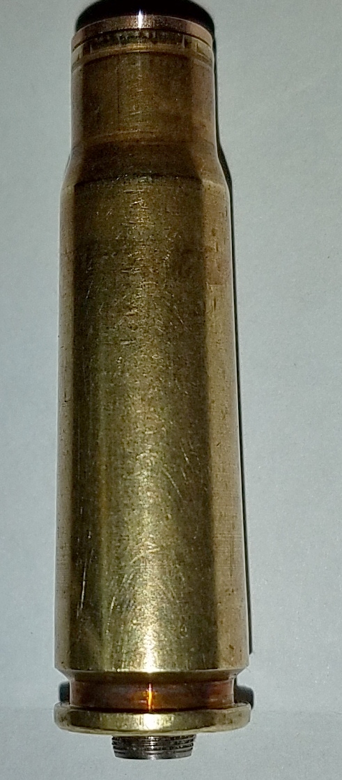

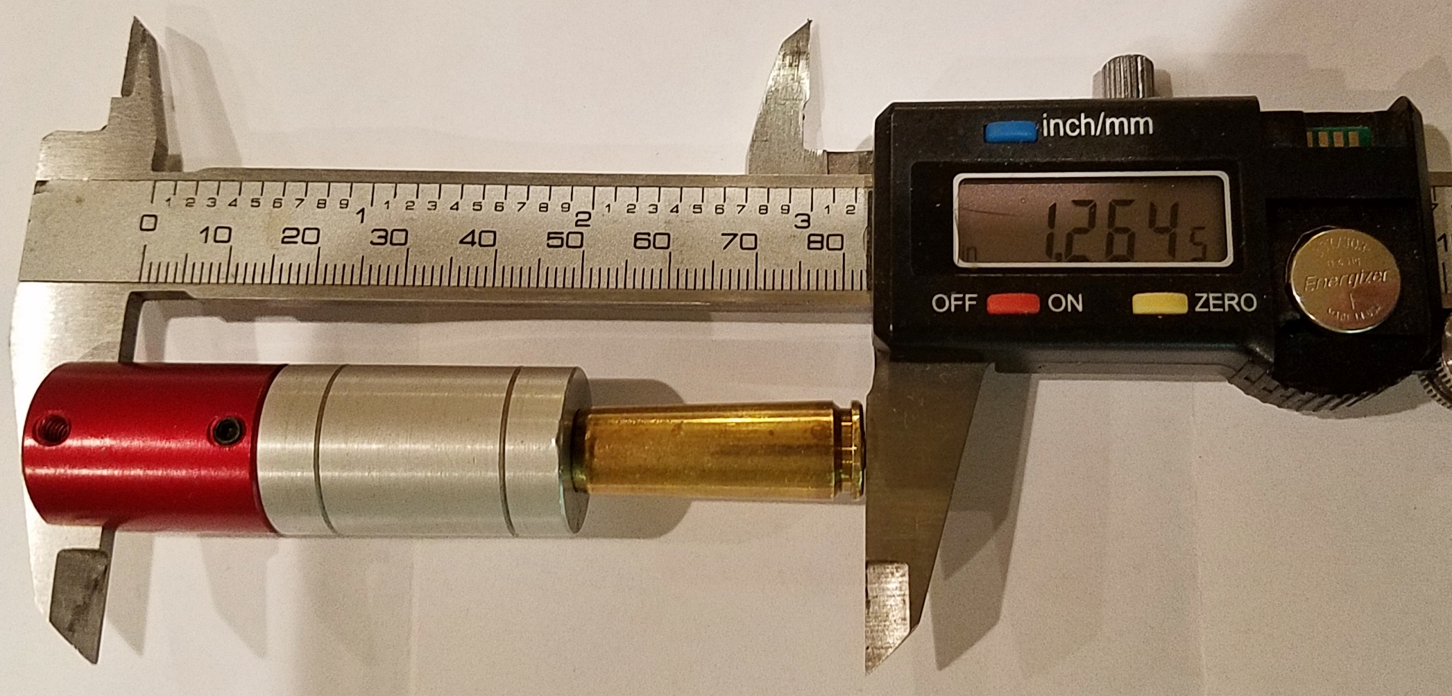

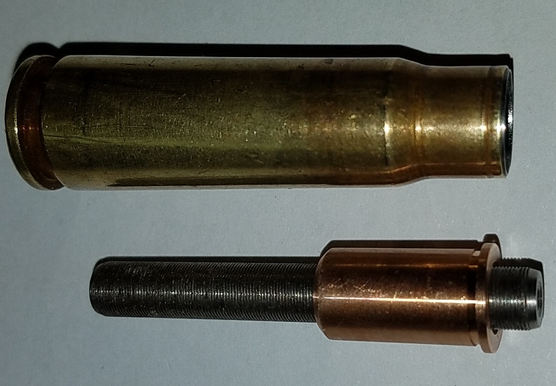

Here are pictures of the comparator tool that I described above
80 tpi screw and bushing next to case with primer pocket drilled out Attachment 47420
assembled tool Attachment 47421
measuring tool length with Hornady attachment for calipers Attachment 47422
