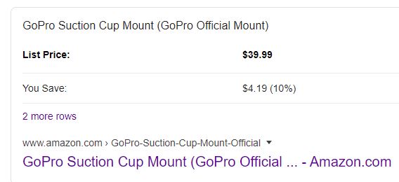

Needed a suction cup mount for my GoPro.
Attachment 33968
Was not going to spend this and the reviews of the knock offs do not inspire me to trust my camera on the outside of a moving car

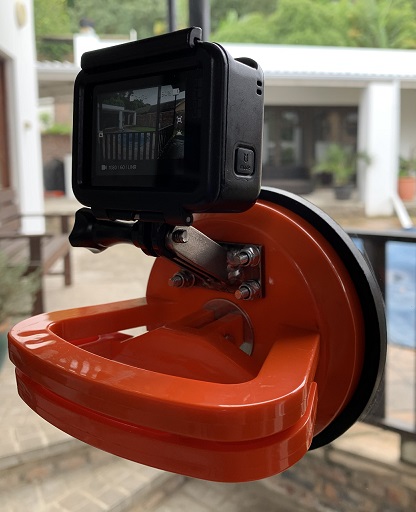

Had some good experience with the Chinese imported suction cups lifting a 2m x 2m dining room table glass top.
The single ones are rated at 45 Kg lifting capacily

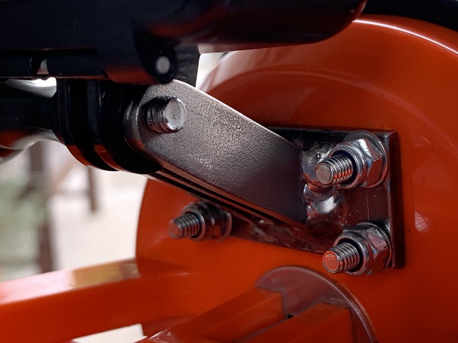

So a few pieces of 3mm stainless steel welded up and a few holes, strip the $4.00 suction cup and bolt it with 4 x 4mm countersunk screws, reassemble the cup and it is done.
