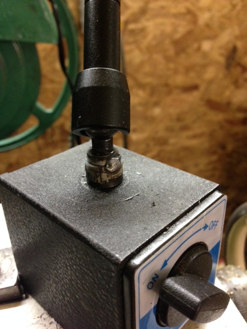

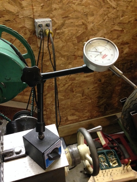

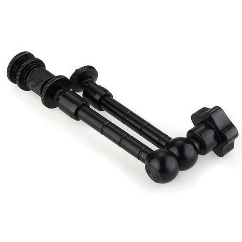

I purchased two camera mounts from an import tool dealer for $7 a piece. When received, I cut off the metric attachment bolts and welded them to SAE bolts to fit in some knock-off magnetic bases. The end result is a NOGA-style indicator holder for about $15 each as opposed to $100's. One tightening knob will hole the indicator in any position possible allowing for quick setups on the lathe or mill.
Attachment 7636Attachment 7637
