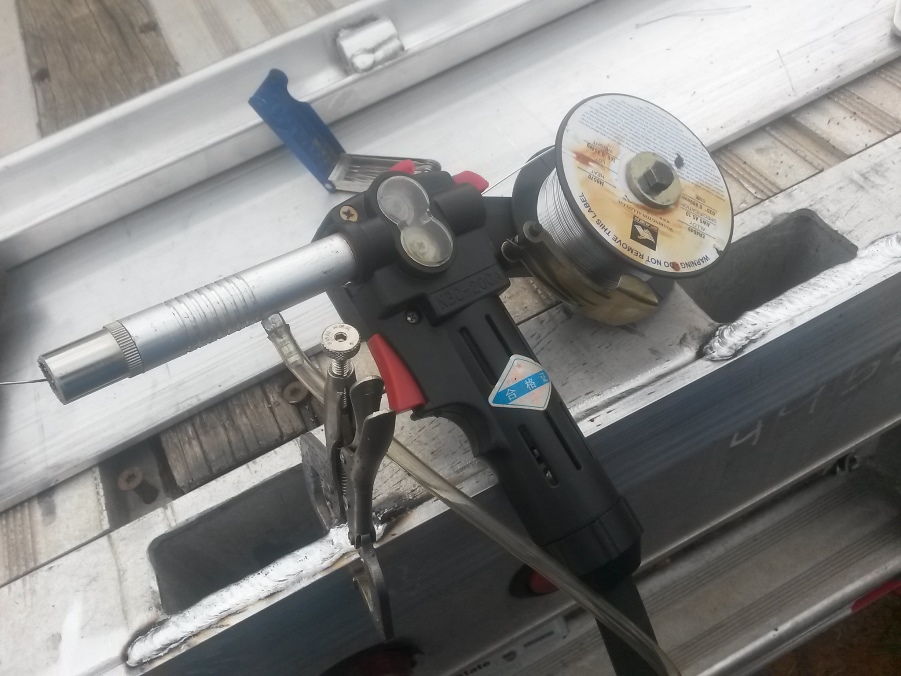

Needing to do some aluminum mig welding I first tried using the 12 ft gun on my welder. This wasn't going to happen I found out very quickly. Not with 4043 0.035" wire and not with a 12 ft gun, 0.045" 5356 possibly. A 4ft gun with the 4043 maybe.
So going to amazon I found the MBC 200 spool gun completely bare no cable or hose for $29.00 free shipping.
If it works really well fine if not I'm not out a whole lot, I was sure I could at least make it work well enough to do the job required.
IE https://www.homemadetools.net/forum/...389#post142516
In order to make it work first I hooked up a 16 ft cable, hose and the control wires.

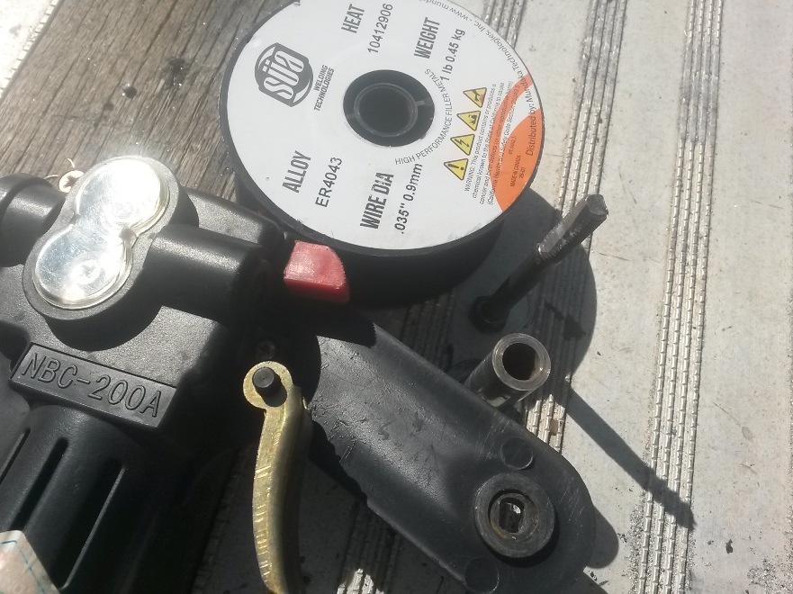

The problem was the gun came with a little spool of its own that I would have to wind the wire on 1/2 lb at a time. the 1 lb standard spool would not fit.
SO about all I had to do was grind a bolt to fit in the mounting hole on the gun find a suitable sleeve to fit the spool and bend the spool brake out of the way enough to accommodate the larger spool
Attachment 31325
Attachment 31326
