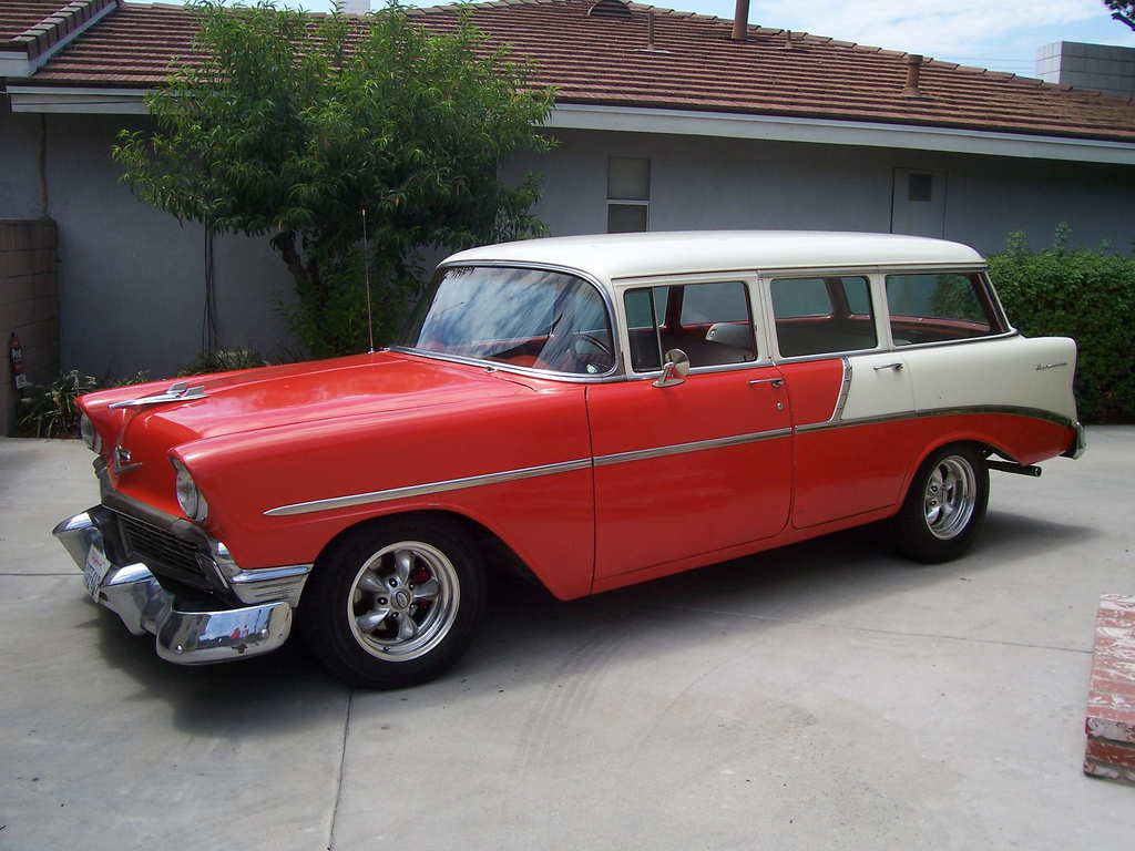

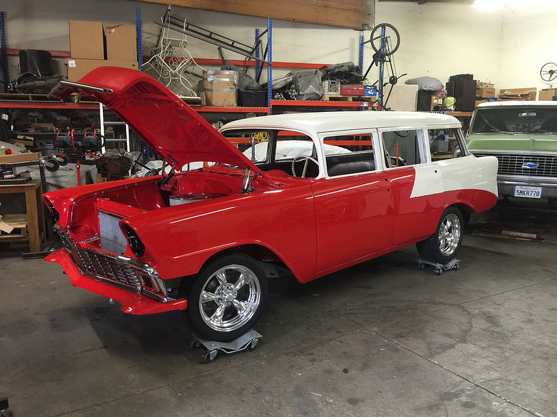

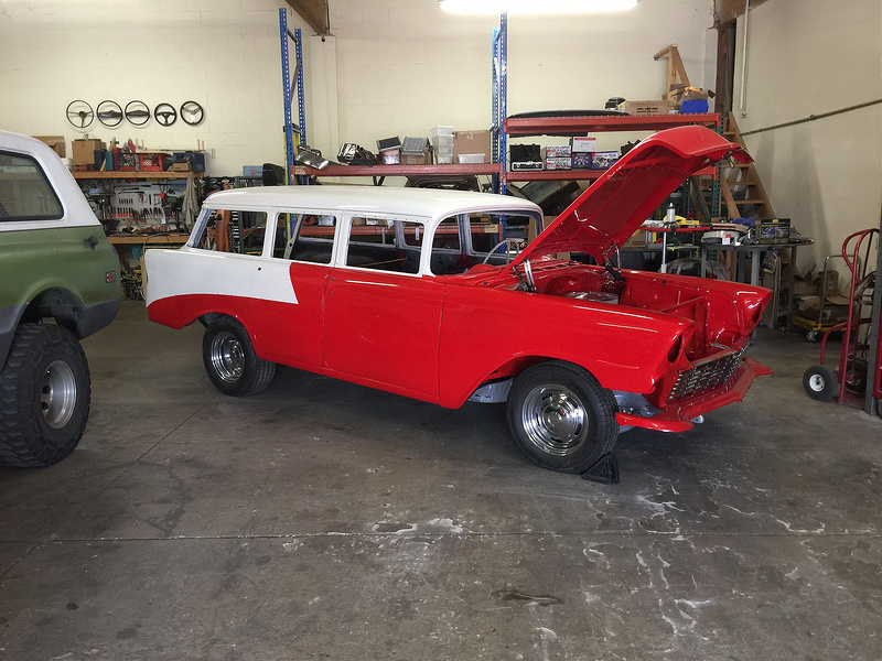

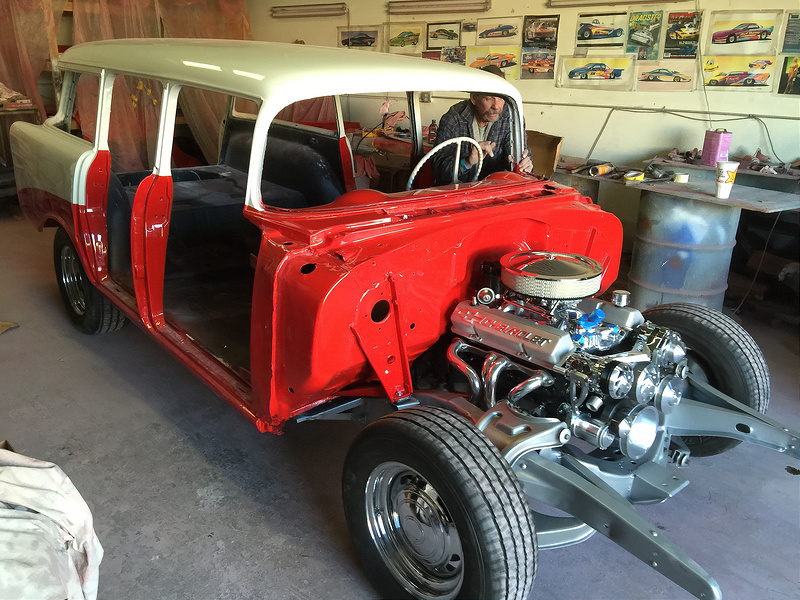

This 1956 Chevy 210 Wagon, built by Daleo56 on the excellent TriFive.com, is an admirable build replete with numerous '50s red-and-white painted Chevy pics.

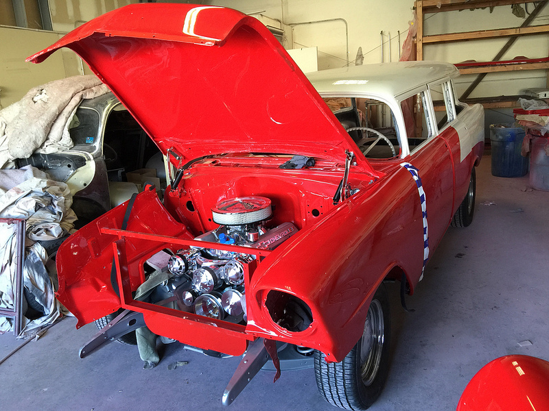

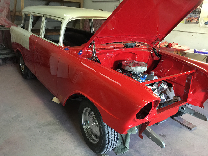

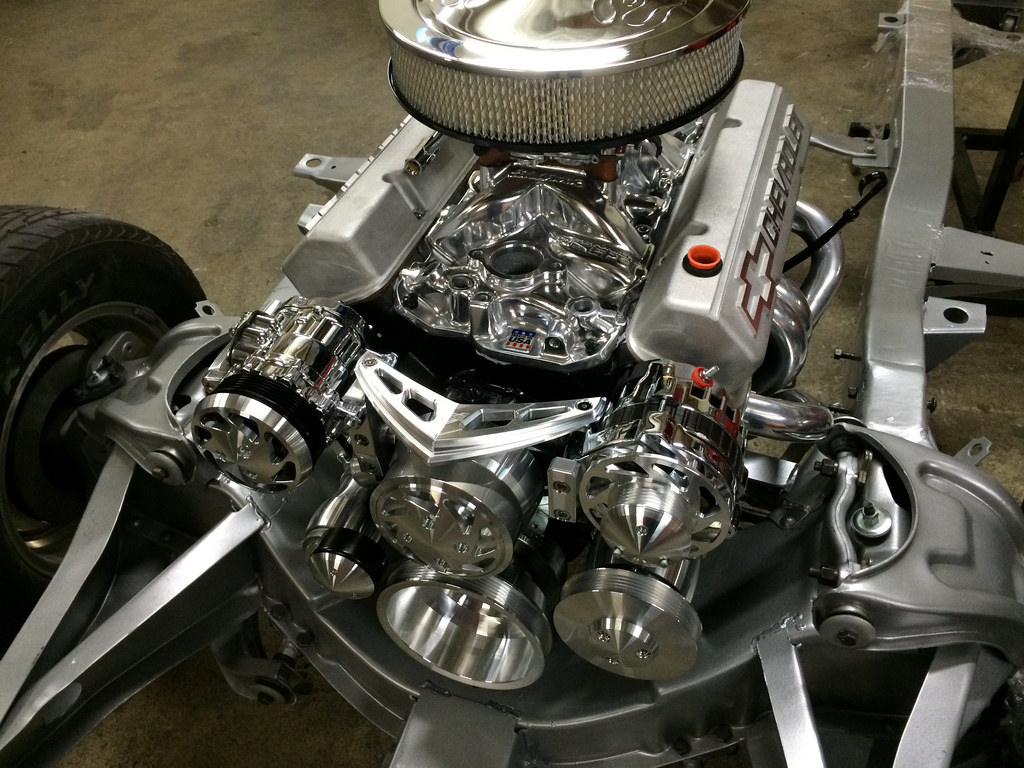

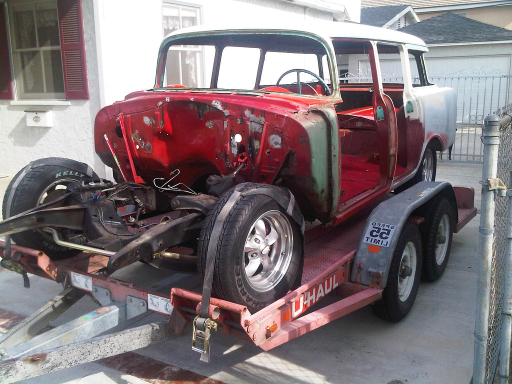

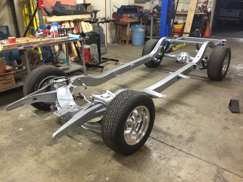

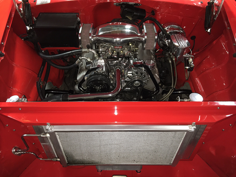

The owner had not originally planned to do a frame off restoration, but eventually decided to go all in on the build. He removed the 327 installed by the previous owner, and put in a 350 crate with some goodies. He also changed from 4.11 to 3.70 gears, to better match the 700R transmission that was going into the car.

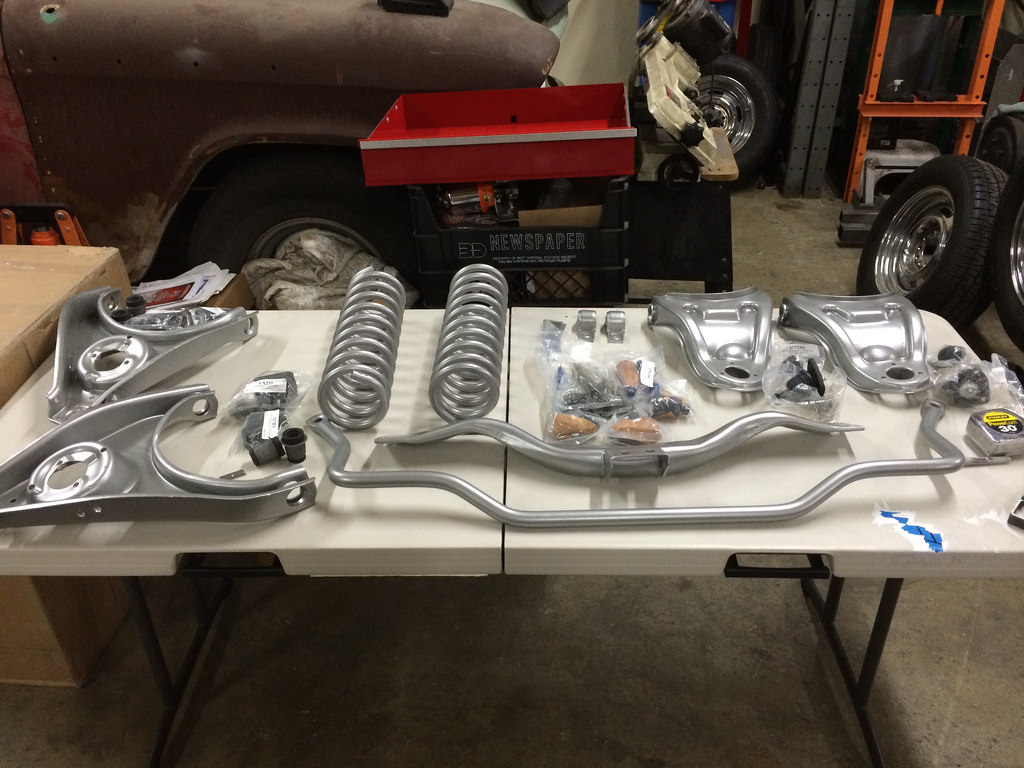

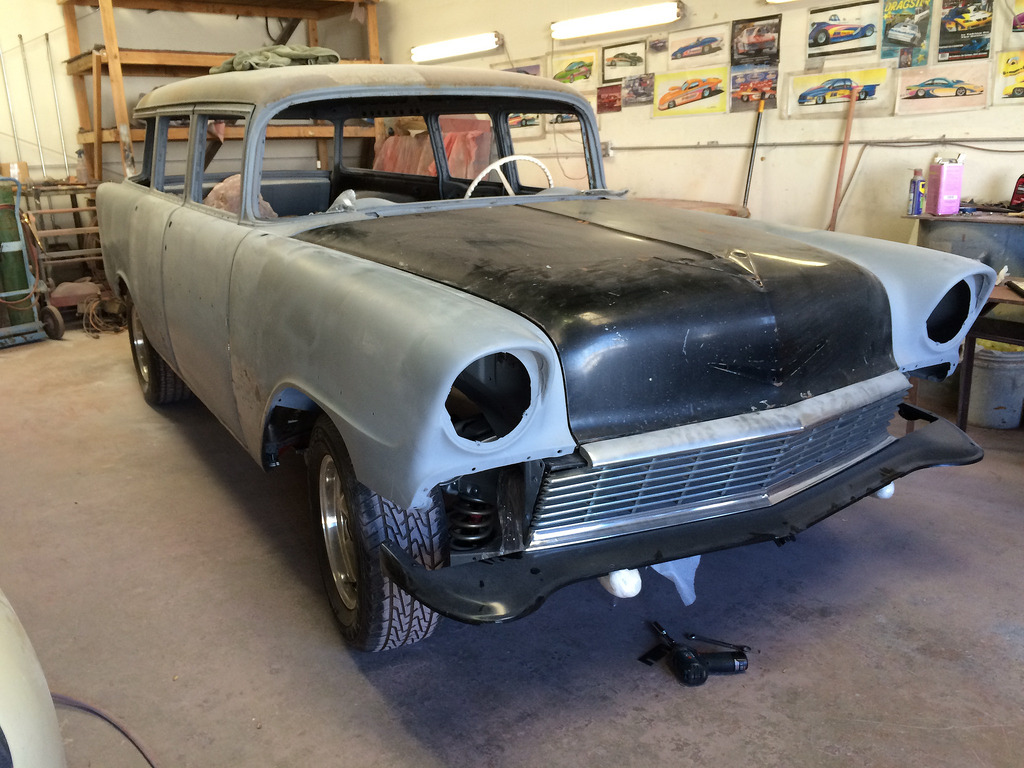

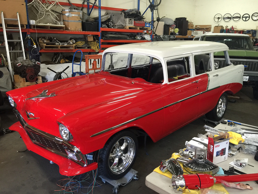

The body work was really meticulous, including floor pan replacement, careful powdercoating and painting of steering parts with caliper paint. The classic color scheme was eventually done with Viper Red and Chrysler Stone White.
Fortunately the builder had some experience with '56 Chevys. Not only had he previously built 56 Chevys, but he had three in his shop for "reference" during the build!
