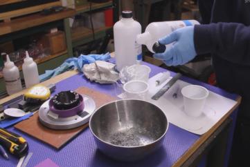

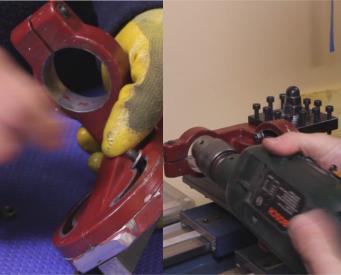

I add here some details that I missed to enter in the first post: in this video a composite two-stages pulley, a makeshift indexer, and a lathe drill holder jig are showcased. Below some pictures:
Attachment 41809
(preparing the resin-alu composite)
Attachment 41810

Attachment 41812
(lathe drill holder jig from a scrapped drill press)
