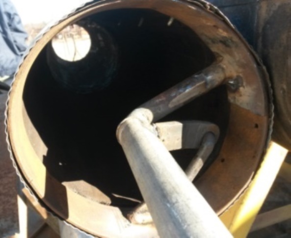

After pulling the core out I decided that I could over sleeve it with another section of pipe.
Since putting 8 inch pipe over 8 inch pipe defies the laws of physics and since it was the seem that was leaking anyway I just split it at the seem and inserted it inside of a new pipe. My reason for doing this was the new pipe was galvanized while the core was stainless steel.
Now comes the problem of how to expand the core to fit tightly inside of the sleeve. I decided to make an expand-er

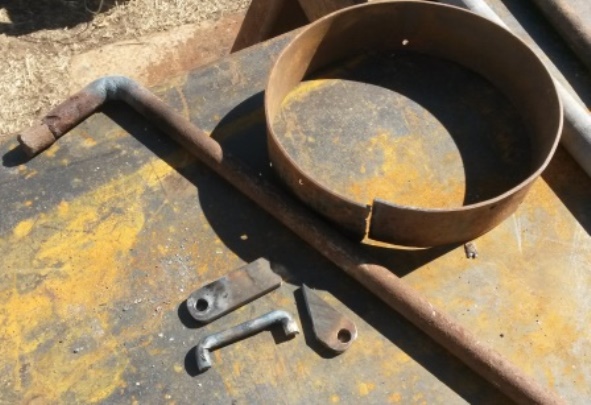

I dug around and came up with a length of 1/8 by 2 flat bar. 1/4 by 1 flat bar, 3/4 sucker rod, 3/4" pipe and a bicycle kick stand
Here is what I came up with

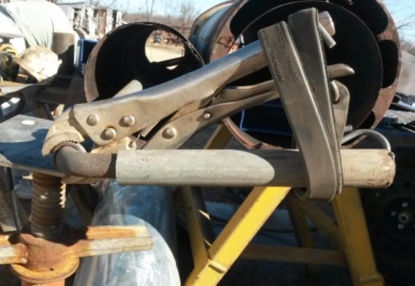

Attachment 16334
Attachment 16335
the bungee cord makes a good 3rd hand to hold tension on the tool

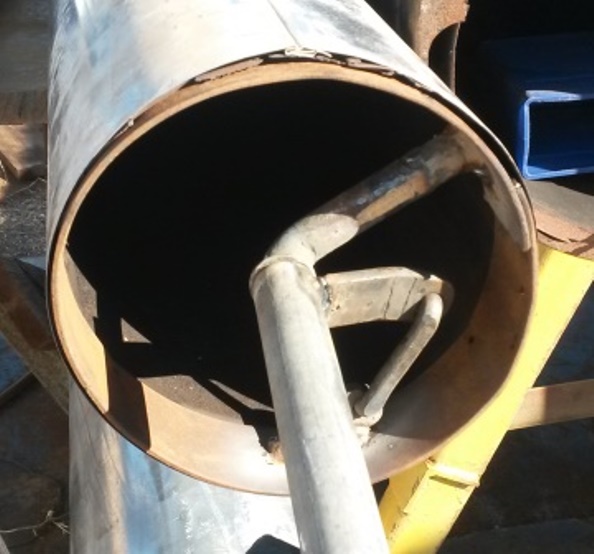

Attachment 16336
Attachment 16337
Attachment 16338

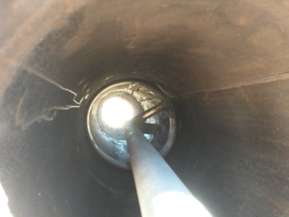

In addition to expanding the inner liner the expand-er provided a solid back up for drilling in the self drilling screws which hold the liner in place

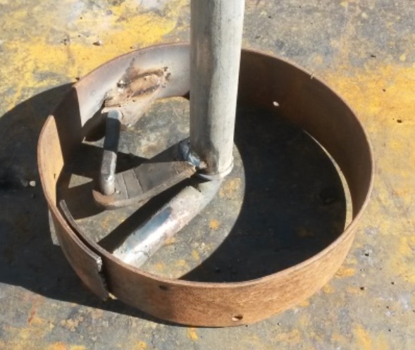

Attachment 16339
Now the core is only 5 ft long instead of the 6 ft that it was I will have to shorten the outer double shell and get 1 new section of pipe.
