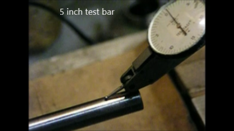

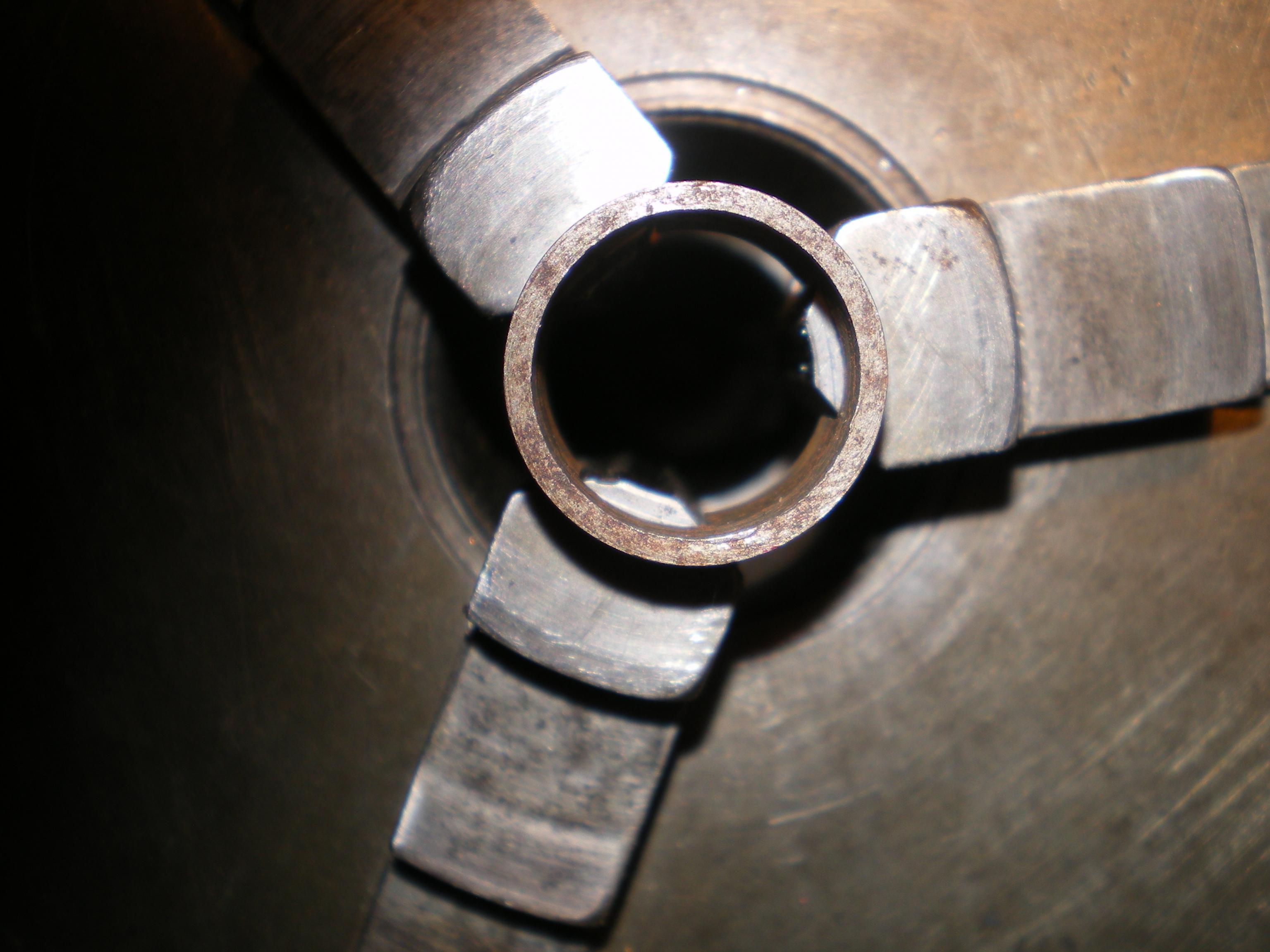

Do you have a worn chuck that is only gripping on the back of the jaws, here is a way to fix it.

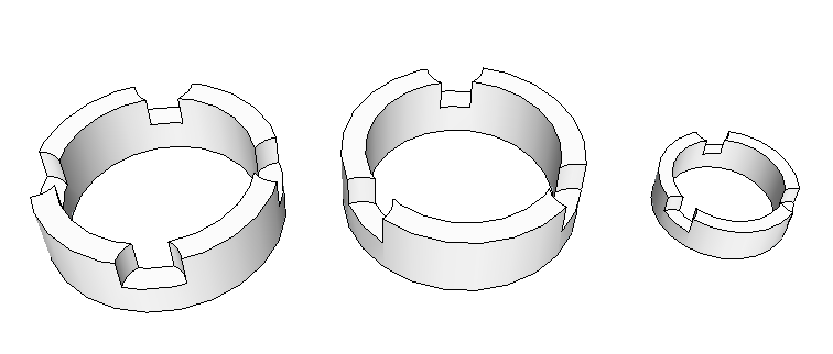

This simple tool will do the job if your chuck has hardened jaws, by gripping the jaws by the front only (where most work is done) while allowing a grinding wheel access though the length of the chuck.

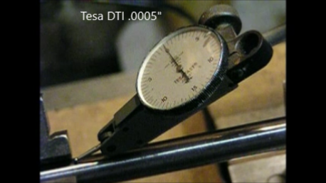

My 50 year old 5 inch 3 jaw will grip a 5 inch long test bar with the same run out at the end as at the jaws (usually within a thou) after this treatment.
